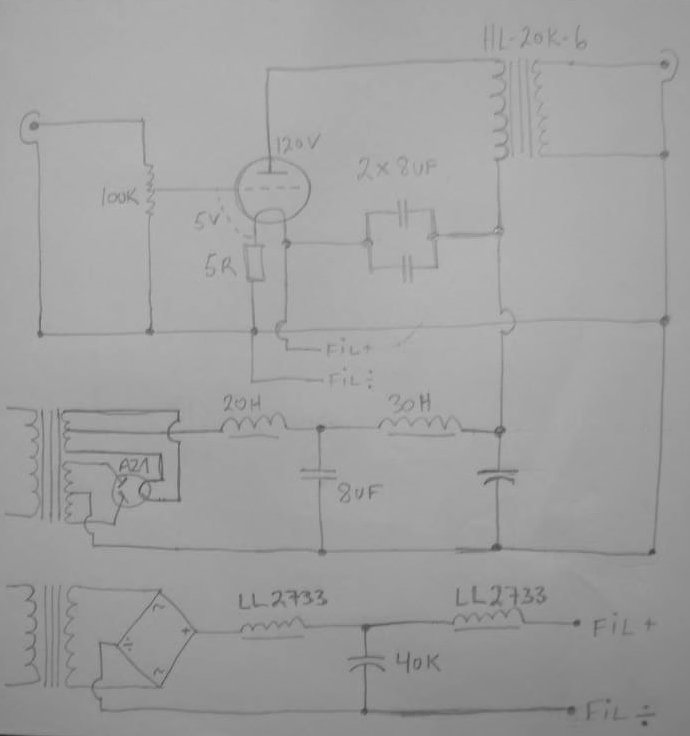

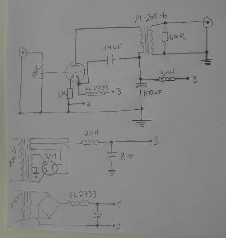

Hi all,
First of all, thank's to everyone who has contributed to this long thread. I think I have read through it all, and it has been very, very helpful for me to get along with my #26 preamp.

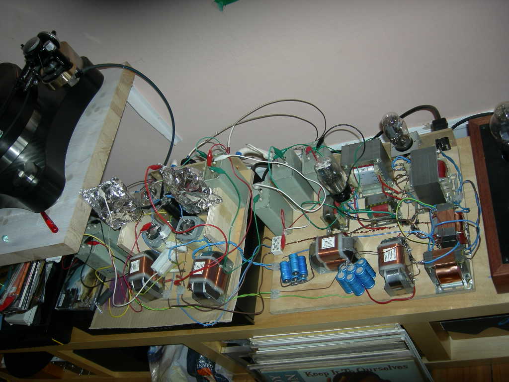

I have the amp breadboarded now, and I feel that besides from the PSU and the AVC, there are just small modifications to be made. I run the tube at 120V@8mA. Probably a little bit hot, but I will adjust it down to 5-6mA later on as Kevin suggests. I have tried out both battery grid bias, bypassed cathode, and filament bias. Filament bias is staying, I like it a lot. The sound now is amazing and highly musical with no audible hum in my 98dB speakers.

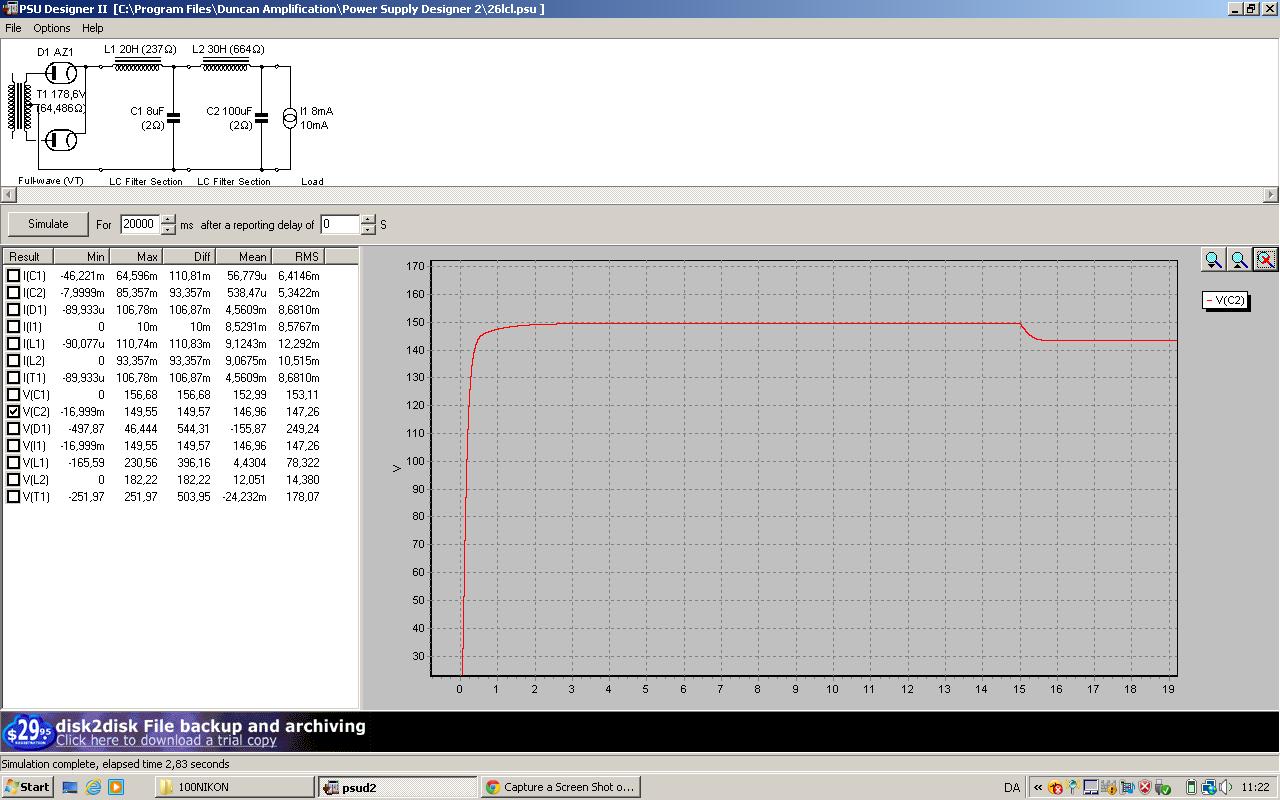

But what I really need some help with is the PSU. As I don't have acess to a scope, I can't make any measurements. I have have simmed it in PSUD II, but I really don't know what to look for to make i optimal besides ripple.
I attach the PSUD file, a screenshot, schematic and a photo of the nest. If you want to use the PSUD file, remove .doc and rename it.psu
I would like a passive PSU for this amp, preferrably with choke input.
I have one more pair of 20H chokes if that should be needed.
Theo

Hi Theo,
congrats to your 26 preamp! Why do you feel you need to change the PSU? Do you have any hum left?
PSUD2 is a great tool, but it will tell you little about how a PSU impacts the sound. It's a great tool to get your voltages and ripple numbers.
What would be worth trying in your PSU is swap the 8uF and 100uF caps. Put the 100uF after the first choke and the 8uF after the second choke. The last cap is in the signal path and you want the highest quality cap there. It might be worthwhile to increase the 8uF to 20uF, but try the 8uF alone first.
I would not terminate the secondary of your line transformer with 600 Ohms. Try it unterminated or with hoigher resistance values like 10k. 600 Ohm loads the preamp unnecessarily.
Best regards
Thomas

Hi Thomas,
Thank's for the advice. There is no hum left, and it sounds very good. Last cap is Black Gate WKZ. I also tried solen polyprop not so good. So I suppose I just need some experienced builders to tell me it looks good or bad. What do you think about adding another LC stage and removing the last cap, leaving the 30H before the ultrapath and OT?
Regarding the termination of the OT. I was under the imperession it is like loading a MC step up. So when I load it with 600R the tube sees 20K load. Have I misunderstood?
Theo
Hi Theo,
I just saw that you have that other 14uF cap in ultrapath connection there. In fact with filament bias, there is not much difference between that and the 8uF since the cathode resistor is low in value. I would leave just a single cap there. You can experiment what sounds better to have it connected to filament or ground. If you have hum, add another LC stage. If you don't have hum, I see no need for that.
Best regards
Thomas

Stereo 26 linestage works correctly with 2 Filament transformers. Please remember, the filament of 26 is the cathode! We don't want any coupling between L-channel's cathode and the R-channel.
With 1 transformer, having 2 secondary windings - the amplifier will work - but 2 completely separate transformers is best (lowest coupling of rectifier current-pulses and noise from winding-to-winding).
LM317 is too noisy for 26 linestage - you will even hear residual noise through the speaker!
There is one possibility: At ground potential you can get away with one filament supply (transformer and Coleman). Put both filaments in series, adjust for 3 Volts. Ground the filament between the two filaments, so you have one 26 at 1.5Volts and one 26 at -1.5Volts. Bias the 26 with a battery (9Volt).
I have tried this succesfully, however not exactly cathode-bias, sound is excellent.. 😀
