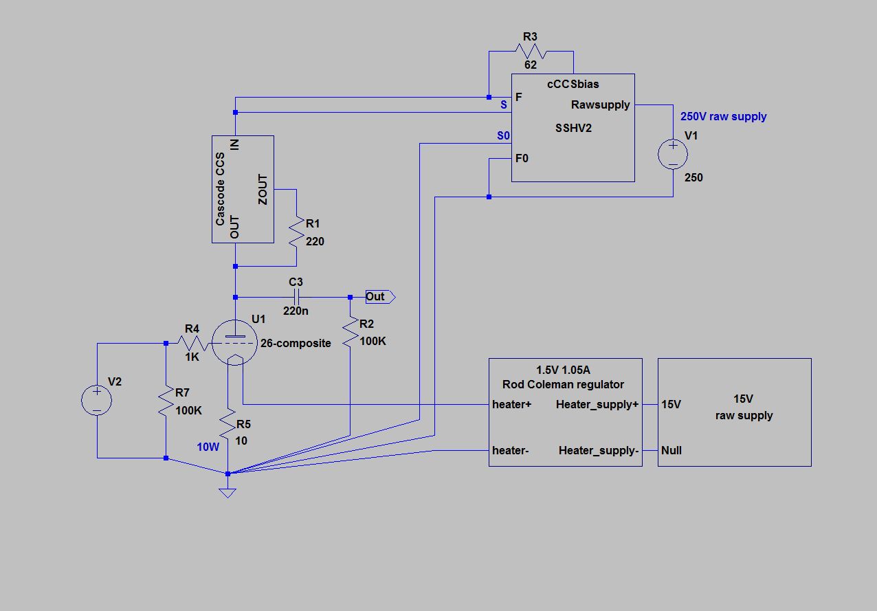

It's a beautiful day in London, probably the last of the year and also the first free time ive had in a long time, so alas I am in the workshop trying to get this #26 up and running.
Ive been following Rod's guide setting the regs and everything seems to be in order. I am running filiament bias 10R, so 10V across filiament resistor. Current is about 0.8A with about 1V across filiament.
Problem I am having at the moment is that the trimmer on the reg board is not making any difference to the current supplied. And looking closely it seems that my #26 isnt lighting up at all. I tried the other 26 and that doesn't light up either. And certainly not drawing any HT current as my HT reading is high, as if unloaded.
What steps do you think I should take now? Is it likely that I have 2 bad valves, or maybe it is something else? I am assuming that these things glow right?

Those new with filament bias can connect it up the wrong way without thinking. Make sure your supply negative goes to ground and positive goes to one side of the 26 filament. The other side of the filament goes via the 10 ohm resistor to ground. Your natural tendency is to connect the supply to each side of the filament. Just stating the obvious here! So measure the voltages
a) Across the filament
b) Cathode to ground on the resistor.
If these voltages are correct, the 26 should be working and the problem looks like the HT.
26 glows very faintly, but it should be visible. Also it doesn't get very hot. Can you measure the current the 26 is drawing across the plate choke or anode resistor or whatever by measuring its resistance and using Ohms law?
Andy

There's quite a lot of talk about not mixing signal ground and filament supply ground, but I guess that is for cathode/battery bias designs? For filament bias should I only ground at the reg filament negative?
Making baby steps with this preamp, but it is coming together. I let the smoke out of a few things yesterday so need to replace those and should be good to continue!
Slowly slowly...
Charlie, just don't connect the Filament Raw dc supply to Ground. to be certain: don't connect the transformer secondary, or the rectifier, or caps or any part of the input side of the filament regulator to ground.
Naturally, the filament bias resistor connects to ground. One side of the filament connects directly to ground if you use battery bias or fixed bias - but all of those things are on the output of the regulator.
It's just the input side that must strictly float.
Thanks Rod, yeah I assumed that it must have a ground reference somewhere - I know you guys go on about the magic of DHTs but they can't be that magic! 😉
Think I must of had a bad joint somewhere before or something, as everything seems to be working fine now.
Thanks for your help.
Example (my #26 preamp wiring).
