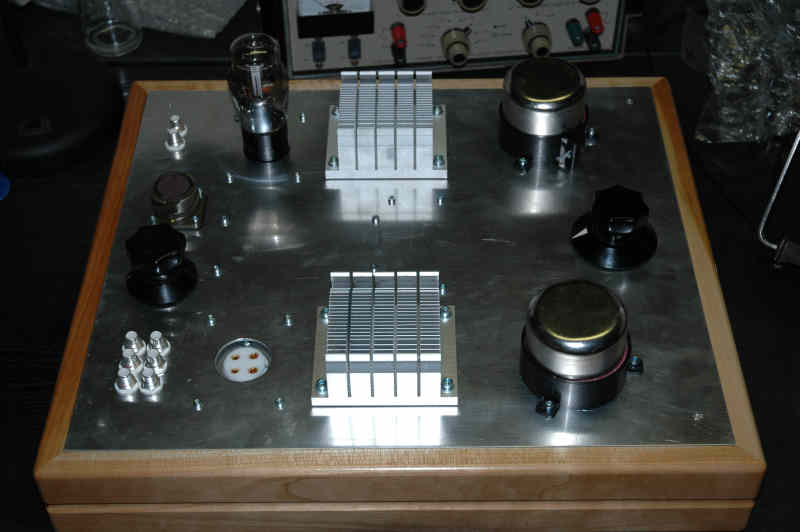

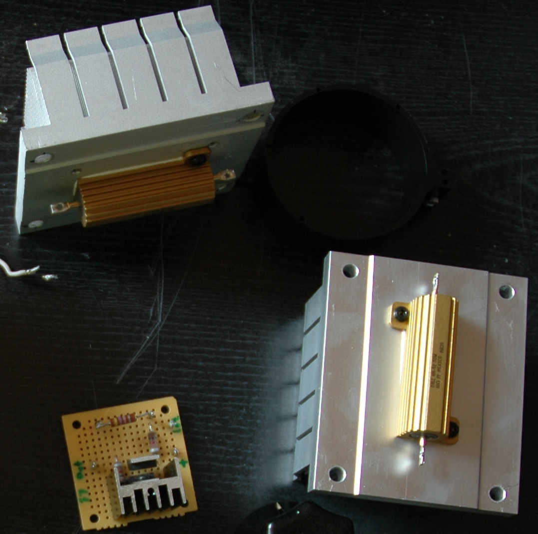

10R 50W filament resistor got to about 110 degrees C
I think your heatsink undersized... or no heatsink.
I use passive (HP computer) CPU heatsinks.

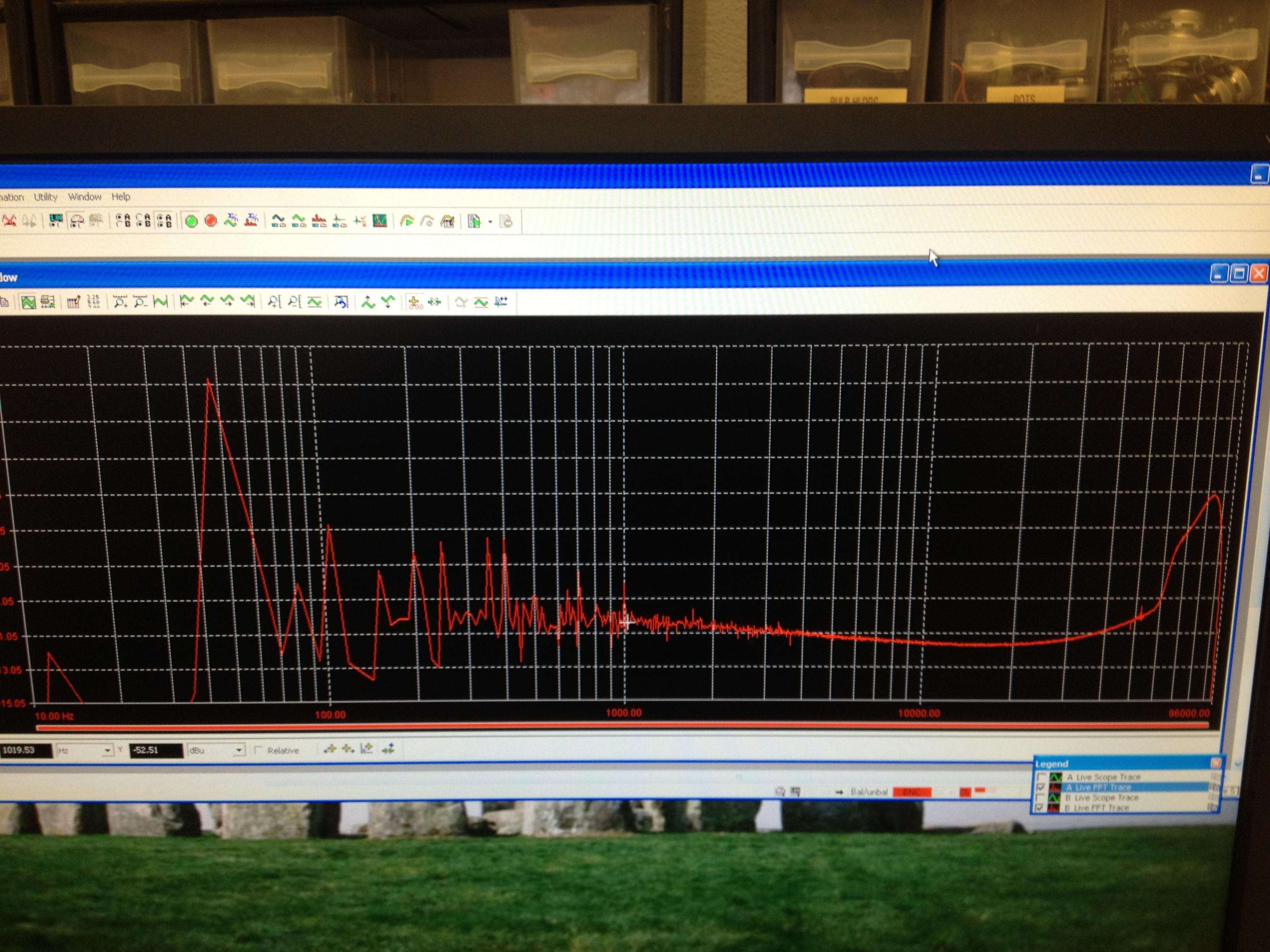

Here is a photo I took earlier, it isn't that clear but it shows the large instability issues. y axis shown in 2dB steps. Again, didn't have much time to continue after I fired it up but I am glad that it is almost up and running, it's only taken a year....
Charlie
edit: the frequency response is a multiple tone response for rapid results - so this isn't acurate

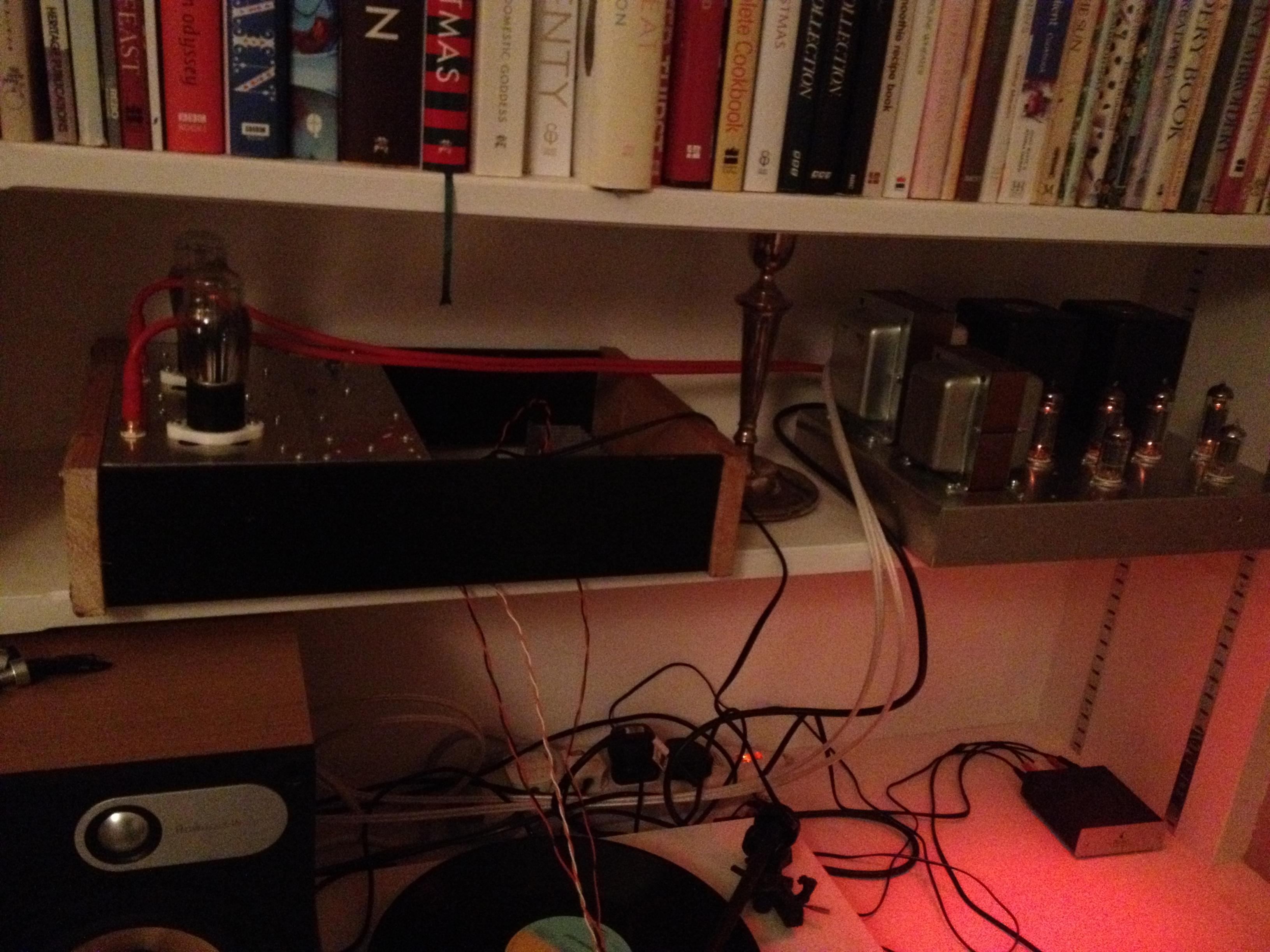

OK so worked on the preamp this evening and the end was in sight so I carried on. I have no way of testing properly at home but I was able to make sure I had the right voltages in the right places. And managed to get it to a working state - still a lot of work to be done tweaking etc... making it safe for my cat..
But it is working, and I am currently listening to Joni Mitchell Blue as I type this. In fact it sounds like she is sat right next to me. The tone is superb, very soft yet still retaining all clarity. Unfortunately I just moved and am not yet used to my new listening environment, but I am looking forward to listening more and more.... it is very intriguing!
I will hopefully take it into work tomorrow and get some proper results and eventually .... some day... make it safe! I could not get the full 1.5V across the filaments but I think this is down to a slightly low PS.
Thank you to all for your help. Ale, Rod, Thomas, Andy and DIYers here and in the London Circle - thank you for being so patient with my questions...
.. Andy I hold you fully responsible for getting me into DHTs and may never have money again because of it, but at least i'll be happy!
Cheers
Charlie

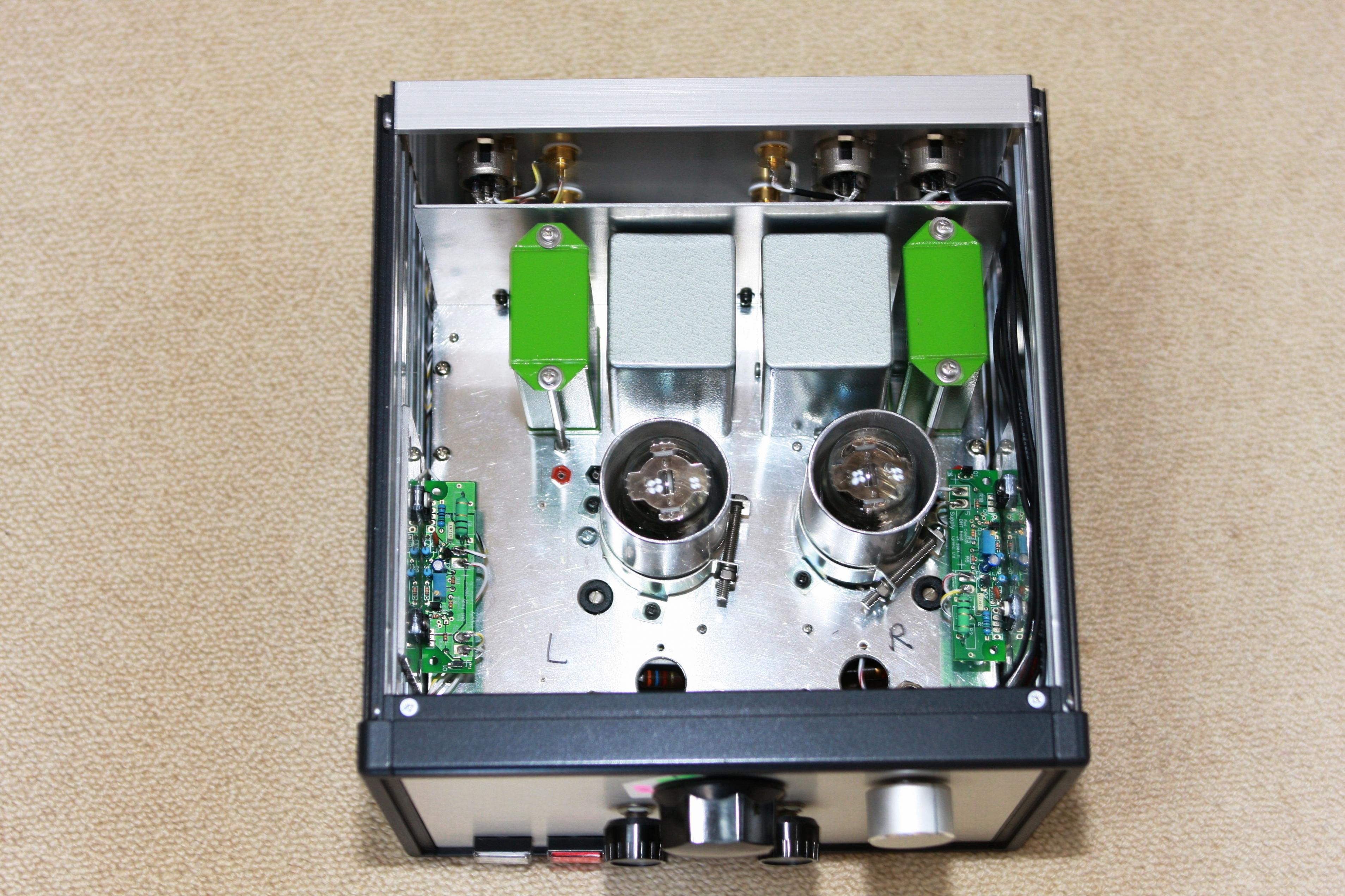

Hello Rod,
Thank you very much for informative advice.

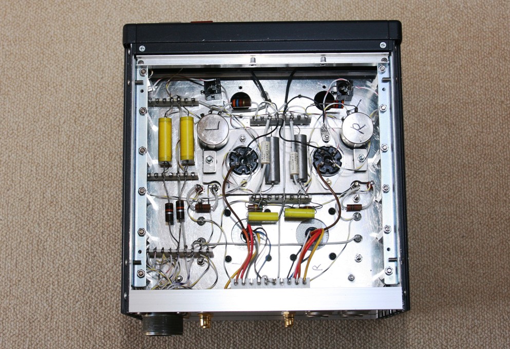

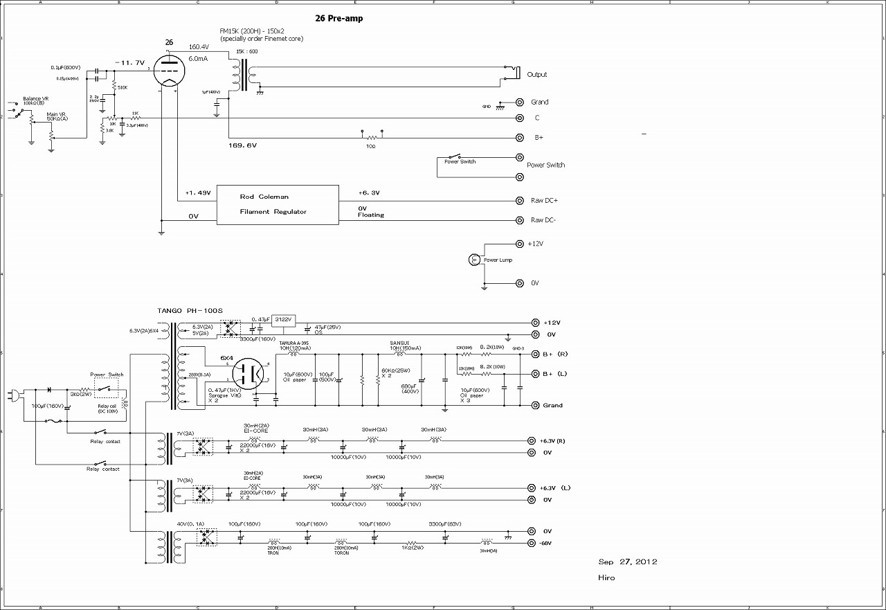

I now completed the first step of the 26 pre-amp partly modified from my 71A pre-amp. Frankly, I like the sound of 26 pre-amp.
I shall try "Filament bias method" as a next step adopting a new PSU.

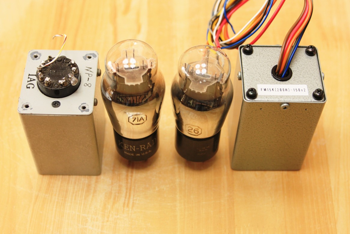

Hello Hiro, I am pleased to hear that the change to the 26 is a success!
The output transformer, with Hitachi FineMetal core looks very interesting. How does this trans sound?
When I replaced from Tango NP-8 to Finemet core OPT, FM15K(200H)-150x2 in my 71A pre-amp, my first impression was of expansion of bass range and smoother in high range with less distortion.
The sound of 26 pre-amp just suits my taste.
Specification of FM15K(200H)-150x2:
Winding ratio 1 : 0.22
Inductance 212H (5Hz) 15K
216H (100Hz)
256H (1KHz)
Maximum current 15mA/15K
DCR primary 783 ohm x2
Secondary 43 ohm x 2
Frequency response 8Hz ~ 30KHz (-3dB) ( Drive with rp=15K ohm)
