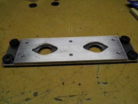

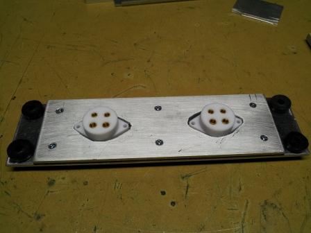

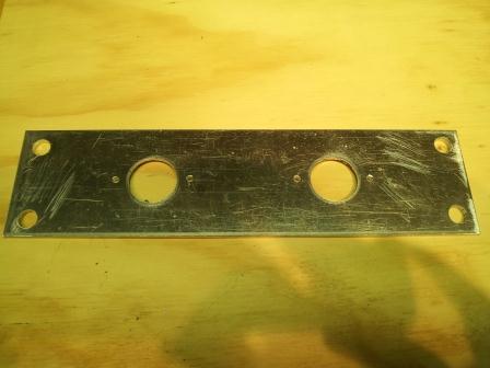

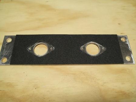

So I've begun work on the 26 preamp, and am building the first version on a plywood board so that I can tweak to my heart's content before making a nice chassis.
I'm isolating the 26 tube on a sub-assembly in order to control microphonics. I've attached a few pictures of how I've assembled this in case you're curious. It starts with a 4mm aluminum plate (courtesy of andyjevans' fire sale a few weeks ago), into which I've drilled and punched the appropriate holes for the sockets and mounting bushings (picture 1).
To this is added a layer of self-adhesive Soundcoat absorbent material (sheets purchased from Parts Connexion) - picture 2.
On top of that goes another 4mm aluminum plate, which is glued and bolted down. (picture 3)
Connex teflon tube sockets (economy grade) from PCX are added - picture 4. The Connex economy teflon sockets are perfect here as they provide some damping of their own and because the body of the socket is quite long, allowing the socket to stick up through the outer chassis which will eventually be added over the mounting plate.
The mounting is through Deflex bushings on each corner; I made them from Deflex vibration absorbing washers (also PCX) by sandwiching a cored out center of one Deflex washer between two full size Deflex washers.
The assembly is very dead sonically, rapping on it produced a soft thunk, as opposed to the ringing of the plain aluminum plate.
Overkill? Perhaps, but I think I can be confident that I've dealt with chassis-borne vibrations, anyway...

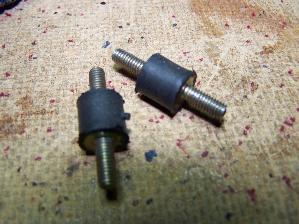

I got good results using these stand-offs.. It is soft natural rubber in between two threaded rods.. They are supposed for vibration damping.. 🙂 These are M4 but also available for M3 and with one threaded rod and nut/insert.
When used, you can move the valve almost 45 degrees to each side and tapping on the chassis is barely heard through my speakers (only a very soft thunk).
These allow me even to use a stepped attenuator...
Rob
