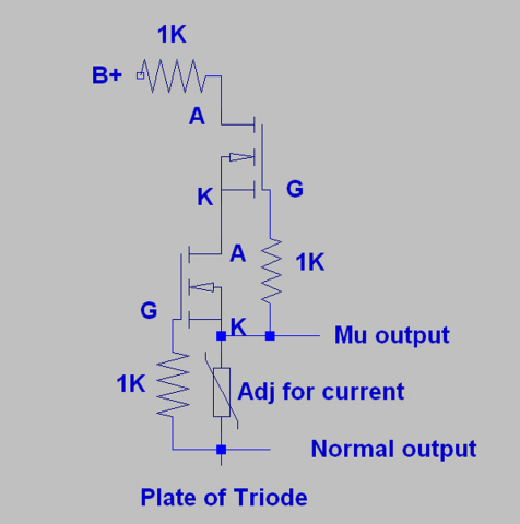

Long to see your CCS schematic.
The CCS are available right here:
K & K Audio - Lundahl Transformers, audio DIY kits and more
I used the Large Cascode CCS with heat sink for the VR tubes and the Compact Cascode CCS for the 26 tubes. The schematic is just the usual one for a CCS made from depletion mode MOSFETs (see picture below) except K&K uses 910R resistors instead of 1K, and there isn't a resistor on the input.

Thanks Magz. So you use Mu out/or normal out.
