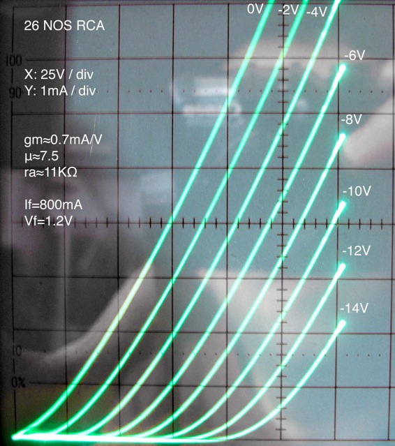

Just wanted to double check and did a quick plot on my tracer of a NOS RCA 26 ST valve. Filaments starved at Vf=1.2V and 800mA as per Andy's operating point.
Ra increases to 11K (3K more than a 01a) but if Andy reports good bass response I take is worth trying it?
Initially I thought the operating point might be a bit on the low side, but At Vg=-4V and Va=100V is a good linear region. Perhaps a bit marginal at -4V bias to respond to input signal transients and end up driving a bit of grid current?
Anyway, enjoy the plot and draw the load lines😀
