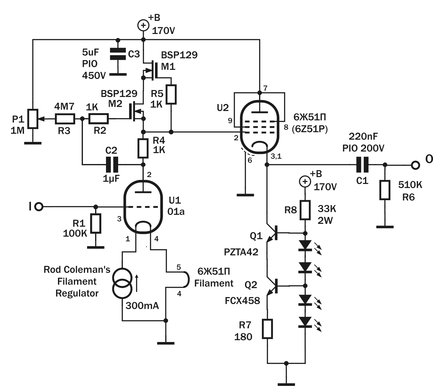

#26 pre amp
Have replaced the cascoded MOSFET gyrator with Anatoly's hybrid gyrator which performs better at lower anode current (bearing in mind a 26 or 01a stage)
It looks a lot of silicon to me but should work really well.
Some questions:
1) Probably the gyrator led array should be increased to allow at least 10-15V across M1 and Q1? In a previous version for my 45SE driver I used zeners instead, but would like to stick to LEDs where possible.
2) is the Mu follower configuration ok with this gyrator design? Wasn't sure as Anatoly didn't include it in the original circuit diagram. I added the resistor between the anode and the gyrator with a value of 1/gm
Also added additional LEDs to the follower's CCS. I think a quiescent current of 10-15mA should do fine to drive the amp's capacitance?
Will
simulate this in SPICE when I return from my trip...
Ale
Ale, this looks like a good circuit.
10mA should be fine for the cable driver, for reasonable cables and input capacitance of the power amp. If in doubt, use the capacitance value of the cable you have in mind (100pF = normal 1metre, 1000pF = excessive, like flat cables) and calculate the cable current at 50kHz:
For 100pF cable + 100pF amp input, Xc is 1/2ПfC = ~16Kohm
Say peak output voltage is 10V, peak current is 600uA for 100pF cables,
For 1000pF cables and 100pF amp input, the current peak is more like 3,5mA !
The current source should probably sink more than 10x the peak current you have in mind, so I think it's usually worth checking the cables you have.
Hi Rod,
Thanks for the input! My amp has probably about 100pF input capacitance (6j5 input driver at Mu=20 and Cag=4pf) and use 2m of normal cable so another 200pF.
Why considering current at 50kHz and not 22KHz?
Why also driver's sinking capability needs to be around 10x if we are already considering the peak current?
Happy to learn here!
Ale
Hi Rod,
22kHz can be substituted here, but I use 50kHz -
- to ensure a robust design margin;
- if an LP player using Moving-Coil cartridges is ever connected, this will be the bandwidth! Especially, tracking over big clicks will generate this kind of spectrum, and we want the preamp to remain in control!
The Source-follower can only source current (ie charge the cable capacitance with current flowing OUT of the amp. When the signal voltage heads downwards, the CCS must deal with the current. Since the CCS current is fixed, for every mA it takes from the cable, the source follower decreases in current by 1mA....
If we set the follower's idle current equal to the PEAK output current, then the follower current will vary from 0.1 to 3mA (say), or 1mA to 4mA if we leave a little standing current.
Sweeping the follower current over a 4:1 ratio will make big changes to the FET's output impedance as the signal progresses, and also the gate-source voltage (introducing serious distortion).
This is the price to be paid when doing away with feedback in an amplifier. The design must be such that the signal can sweep across its maximum extent without changing the operating conditions of any of your stages too much. This is a big problem for solid-state design, because transistor are horribly nonlinear.
Of course, in the commercial world, feedback is used to 'linearise' the amplifier by brute force.
If you can get a 10:1 ratio of standing-current to peak current (at 50kHz), the performance should be OK. If 30mA is achievable (within the safe-operating area of the transistors!) then this is even better. But beware than SOA and power handling need to be double checked when voltages of 20V or more are used - it is very easy to overstep this in an amplifier.

Hi Rod,
Quick update to my 01a preamp attached. I know the MOSFET gyrator is not optimal for a low anode current, should change it to Anatoly's when I get the chance as per my previous diagram. Anyway, this is a quick setup I can test easily.
Looked at SMD bipolars as was thinking to get a very small PCB board including SMD LEDs here.
I hope 15mA of idle current at the CCS should work fine in this case?
Ale

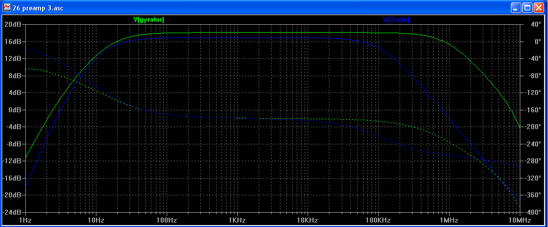

26DHT stage with source follower
Rod,
Looking for some help here. Attached is the simulation of the 26 DHT with mosfet source follower as discussed. Frequency response is better than a 26 with a 300H choke. However, distortion is slightly worse 0.07% against 0.05%. This is due to the gyrator which I can't set properly due to the HT level I guess. I think if I were able to increase the HT above 200V should be able to provide headroom to the PNP to enable bias at 170V and 6mA.
Ale

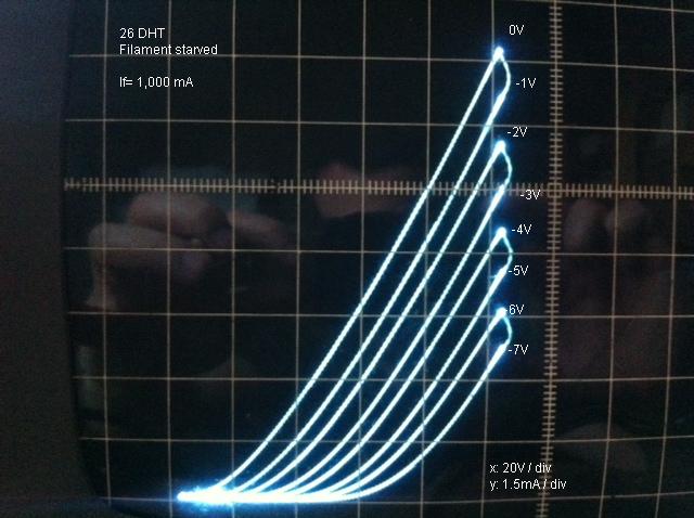

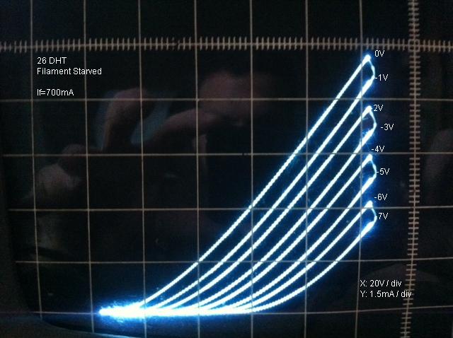

Andy,
Here is a quick sample of the impact of filament starvation on the DHT anode resistance. I have traced the 26 DHT with 1A and 700mA. You can see that the anode resistance increased from 8K to about 11K
A higher anode resistance is a clear drawback if you want to starve filaments with a choke / gyrator load to drive the cables and amp's input capacitance directly 🙁
