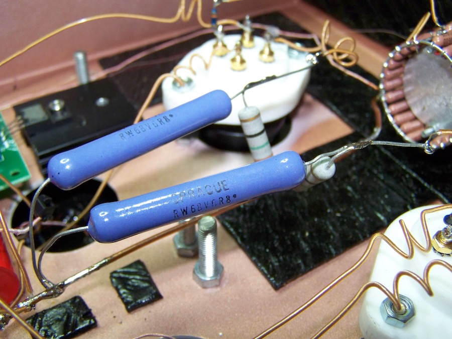

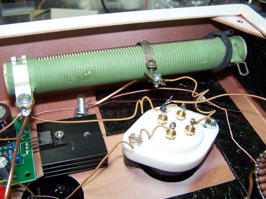

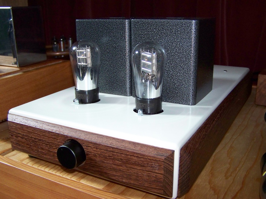

Posted as attachments some interior shots, with the small bias resistors and the larger ones.. and the diagram..
please comment!
Rob

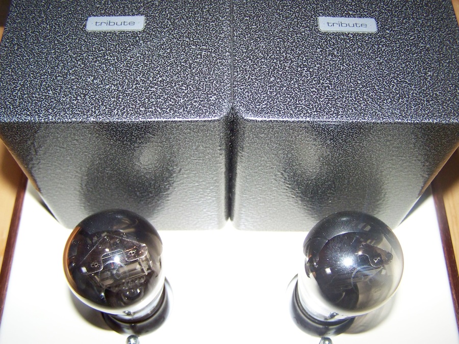

Nice Rob, But my wife wonders why there is no gap between the transformers.... shouldn't the sound be able to creep through? and how about cross talk?? OK we're a bit "melig" here...
No gap because the maker has generously put in a shield... 🙂 (and it looks better)

Hi there,
Worth mentioning: I experienced some serious noise (hiss) at the output of the preamp which came from the used 12Watt resistor which became too hot.. Replaced it for a 100Watt type and now the noise is almost gone. Guess paralleling is the way to go here? Anyone tried graphite resistors?
If interested I can post diagram and/or photo's.. 🙂
Thanks, Rob
I see that you used a variable resistor. I don' t think that paralleling is necessary.
I use a 10ohm 95W resistor and with Rod' s regulators there is no noise.
Also grid stoppers may not be necessary. I did not have any issues with my #26. You could try and see.

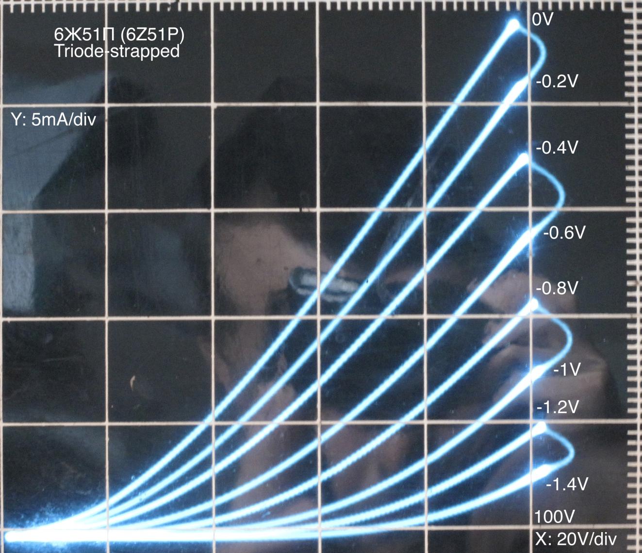

I would not use 6J51P here for cathode follower, it wants more voltage. 6J52P would fit much better.
Or 6J9P

Hi Anatoly,I would not use 6J51P here for cathode follower, it wants more voltage. 6J52P would fit much better.
Or 6J9P
You're probably right. See attached trace of the 6J51P. I should have extended the anode voltage swing beyond 100V, but it doesn't look that is the most linear region there.
I have a couple of 6J9P around and the filament current will fit the 01A as well, so will try them instead
