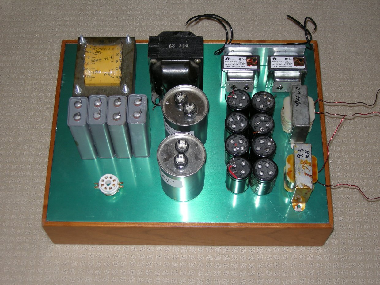

I just have my 26 main chassis cut and still have to wait until the psu finished to try. I know it's way too slow, it almost takes 10 months up to here. I go with the filament bias and would like to confirm the following.
Rod,
I only have 2 16.5v 2.5A transformers. Should I go for exactly 18v ??
As of your instruction, I'll need a 1.5R 3W or more resistor for testing the regulator. Will there be any different on filament bias ??
With the 1st edition of Quanchao Sala's reg., I'll need somewhere around 145v on plate of 26. I therefore would try 170-0 in tube hybrid rectification to 32uf oil caps - 25H - 47uf pp. Would it be good for the purpose ??

Rod,
Albert

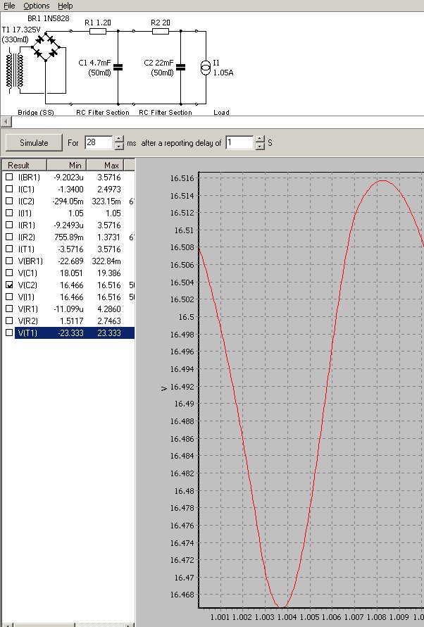

Hi Albert,
I assume you are using Filament Bias with 10-ohm, 25 to 45W resistor, or parallel resistors.
If so, you need about 16.5V raw dc (15.5V minimum).
Your 16.5V 2.5A trafos are PERFECT for this, and even allow the luxury of some resistance right after the rectifier, which can reduce the pulsed rectifier current (reduces emissions, and is less stress for C1).
1N5822 rectifiers should still be fine. See my PDF manual ANdht01v2.PDF for tips on selecting resistors/capacitors, and how to connect the raw dc for best sound.
I have worked out a PSUD design for you -see attached.
Please test the filament bias regulator by connecting the 1.5R test resistor (dummy filament) in series with the 10R Filament-Bias resistor.

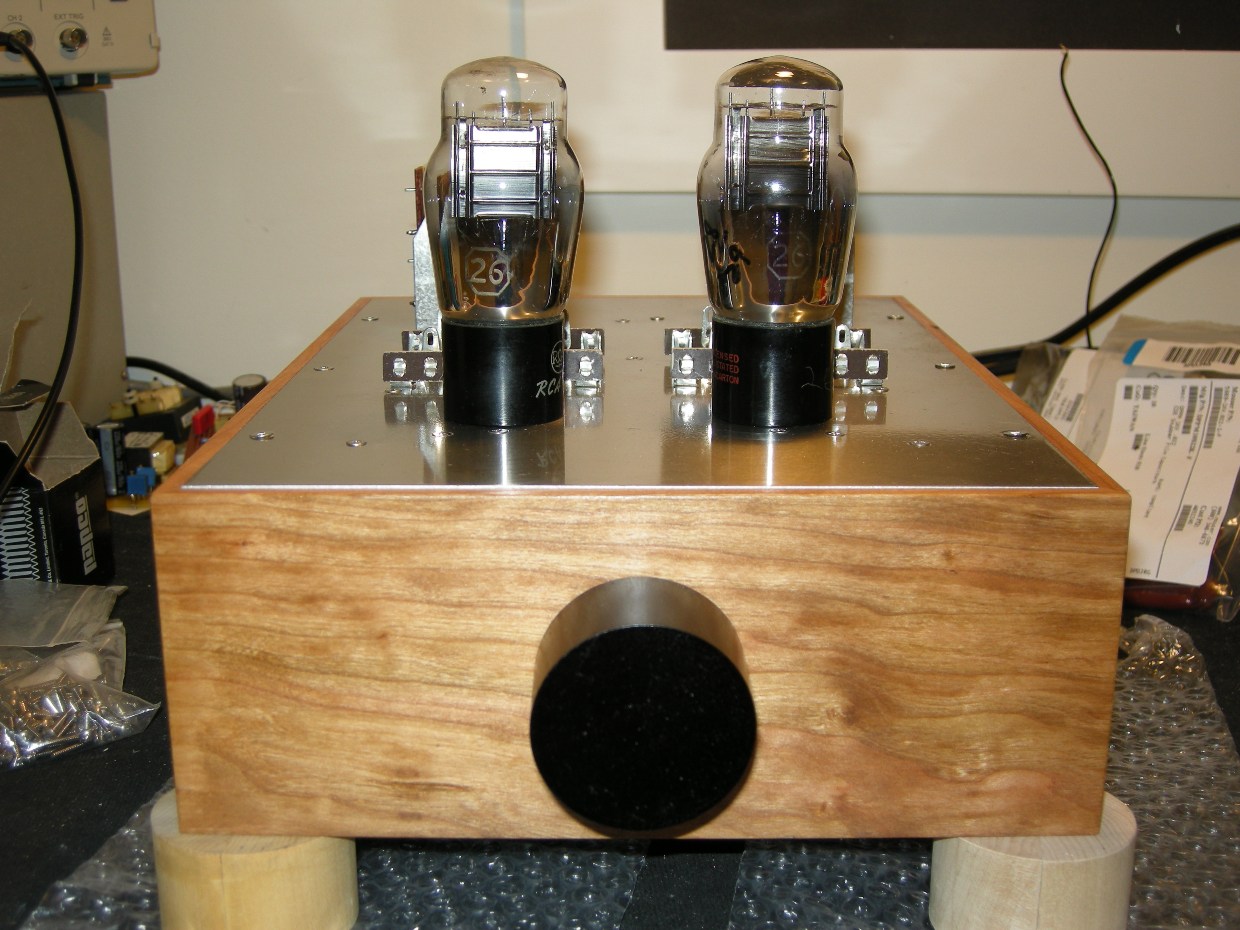

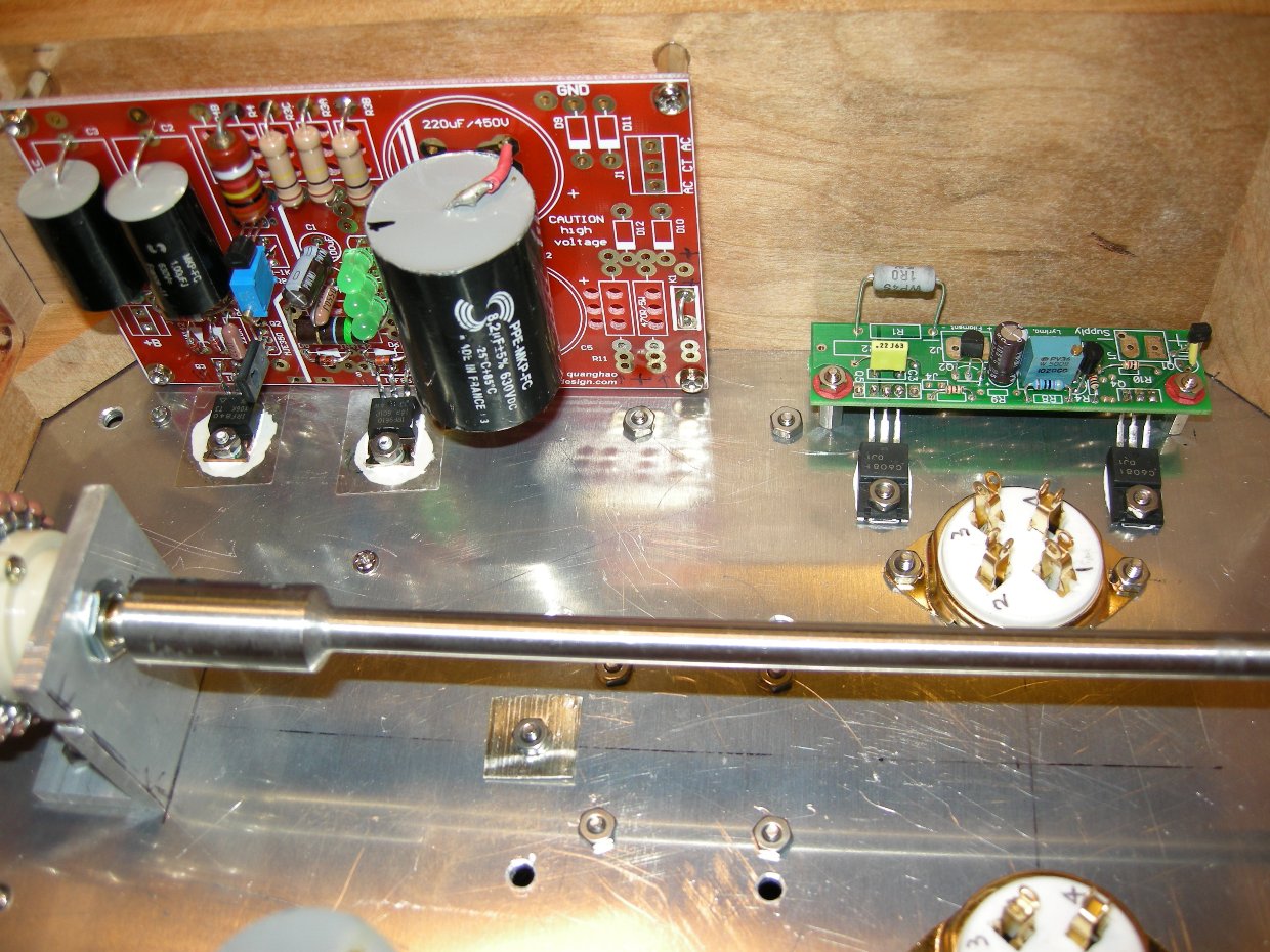

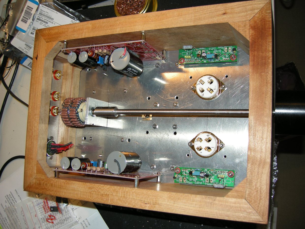

Fantastic looking thus far - looks to be well worth the wait !
I've been tossing around the idea of moving my input selector switch to the rear of the chassis; as you have done with your volume control...The challenge I have is figuring out some sort of bushing to mount in the front plate of the chassis, so the feel of the dial does not change. Any suggestions ? Here's how I have it wired up right now. There are no breaks in the wires, I just used the terminal blocks as wire guides.
Thanks !

Rod,
Many thanks for your detail reply. Lucky I ask the way to test the filament, or otherwise I would directly series the 1.5R to ground. I have 10 pcs 100R 5W wirewound parallel, but end up it's only around 9R. I got 10R with only 9 pcs parallel together, but there is only 45W. Which way I should go ?
After the rectifier, my intention is 10,000uf - 25H - 30,000uf floating to the main chassis - your reg. then to ground. Would like to have your idea.
Thanks !
I like your volume. Was that the 'Cat 5' cable ?
Rod,
Albert
Hi Albert, For the choke, I assume you mean 25mH (milliHenry). That's OK. 4700uF is enough for C1, but 10000uF will be OK. 4700uF is better though, because the current pulses will be lower.
10R 45W should be fine, try it with this first! Make sure that the resistors are high quality though, no skimping. This is no place for White Ceramic Coffins! At least Welwyn W24 wirewound, vitreous enamelled. Andy has done lots of testing, see posts from last year.

Albert,
Please take the 25mH choke and measure the dc resistance with a meter. This value may need to be subtracted from the Resistor between C1 and C2 (2 ohm).
25mH may well measure 0.5 ohm or so - and mean that the 2-ohm should be 1.5.
Both R1 and R2 resistors are needed, even when the choke is used.
