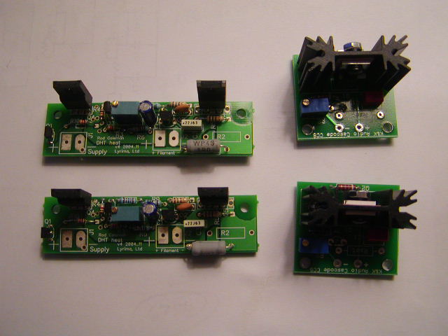

I am one who always rocks the boat so to speak. I have purchased Rods boards for my filament supplys. I have purchased the CCS plate load boards. I have paid for my group buy Salas SSHV2 boards and parts. I am still thinking I can use my supply with the VR tubes and the Salas Regulator after them. Should be aprox 0mv after the Salas. I am thinking that the Salas is a bigger CCS unit so my K&K Cascoded CCS boards for the plate load should work without a problem.
