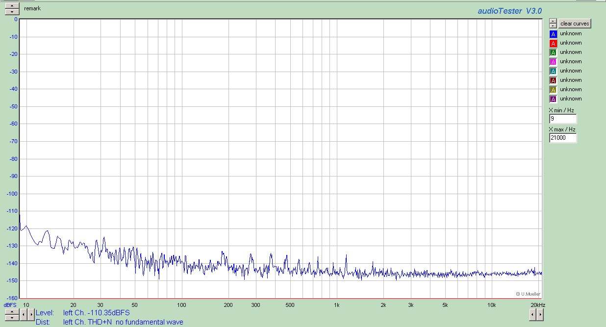

This is exactly correct. I have a total of three stages of gain fed with a cascoded DN2540 CCS into VR tubes, with very very little noise on the output. You can have your ear touching the tweeter and just barely hear some 'water flowing'. Not at all annoying, and you don't hear a thing from your sitting position. I have had such good success with it, I use it all the time. I can measure better ripple reduction with the cascoded version over the single device, so go cascode.
Noise floor of my 12B4 preamp attached. This tube has gained somewhat of a reputation for being noisy, yet I have a really low floor. What's not to like? 60 and 120 Hz is non-existent. The little spikes you see beyond 150 Hz are actually due to the tube used, not the power supply. Different tubes will show different little spikes (some are really quiet).

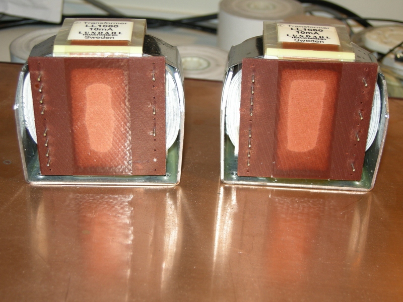

I can't reach the site attached. Would you post the curves/graph so I could learn a bit more. My 1660 is only 10mA and originally aim at the battery bias. I have all the resistors with me and want to go with the filament bias instead.
My 1660 10mA is a SE, not a pp. Does it make a lot of different.

The only difference between ll1660 PP and 10mA is the core gap.
The PP has a little bit higher inductance and can tolerate about 5-6mA.
You should be fine.
