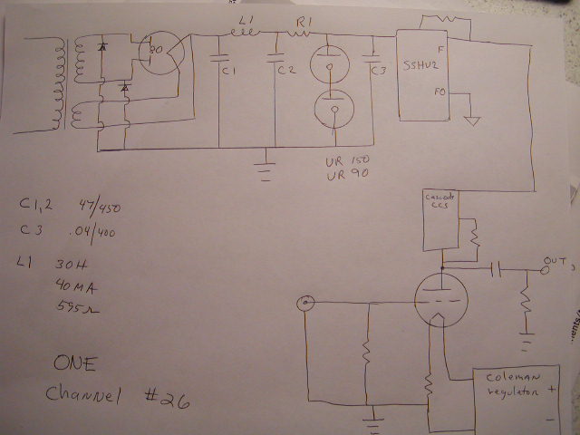

Main difference of just VR tubes and a reg after the noise (plate side) is under a threshold -and this is a low gain line level stage after all, easy to tackle that noise aspect, not a phono- is the dynamic impedance. VR is just a stabilizer, the particular regulator has an error amplifier of 1000 times gain. A much better source, impedance-wise. You will have to evaluate after experiencing both alone, or in combination. I also find excess regulation gain stiffening tone up, but no gain too loose also. Tried for not spoiling the tone, just adding benefits. In the beta testing feedback round the first ''victim'' was a #26, second one was a C3G phones device, both transformer output. Independent feedback was heartening. Specs and subjective evaluations had been taken into account in a hopefully good mix and balance. Not easy to improve ''likes'' on the widely used SSHV1, it took some modesty, team testing, time and care. Wishing success with your experiments.
Im still following this with great interest; and cannot wait to hear how things work out for Magz and Burnedfingers.
Right now Im faithfully replicating Kevin's PSU schema...And we'll see how I like it. If I decide to do something different, I'll still have a 300v tranny and a GZ37 to start with. Considering the high voltage, VR tubes and the Salas board will be the next logical option to get my B+ down.
My B+ supply ONE CHANNEL
Similar to my plan, but I'm thinking I'll use a cascode CCS in place of R1 (set to 26mA), no SSHV reg and a parafeed type output with a Lundahl LL1676 amorphous cobalt core x-former wired 2:1 and a 1uF cap from the x-former back to the cathode, to get an output impedance of ~1875ohms.
