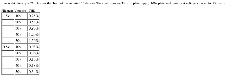

Has anybody taken into account Steve Bench's findings about the 26 in starved filament. Look at the figures below!

I have and with great results. I tried 30, 30sp, 112,01a,10Y, 46, 4P1L, 6P21S in addition to 26. If you use the Rod Coleman filament regulators you can reduce the filament current precisely whilst measuring THD.

When using triode strapped DHT, is interesting to find that there is a point where starvations magnifies the H3 and H5 above H2.
Currently I'm playing a 71a preamp with filament bias and gyrator loaded. I actually like it very much:
My Blog
Distortion levels can be reduced from 0.04-0.06% to 0.01-0.02% depending the valve 🙂

Mogliaa did you find a decrease in transductance or increase in Ra with the reduced filament current on the 4p1l?

Can't find my notes and will need to measure it again but I remember it was around 60-70% (650-700 ma) of the data sheet value, so close to the values you posted before.
Hi Regal,
Haven't measure both, so can't say. I focused on minimising microphonics and THD, which did with excellent results...

Well I imagine if the RA went up much you would have seen a drop in the frequency response if you used a choke or output tranny, but I remembered you were using CCS OTL for the test setup.
I'd recommend others using an inductive load to check this by doing a freq response sweep if running lower currents. I ended up shelving the pair of #26's I had and bought a few 4P1L's, so as usual I won't be any help.
