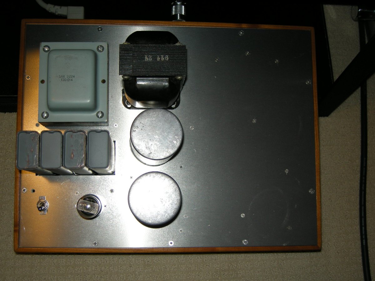

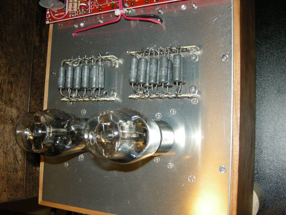

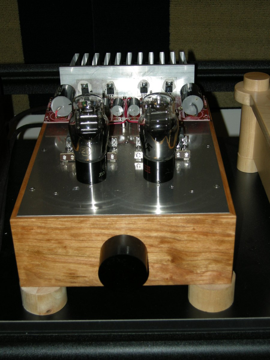

guys,
Please check photos and comment
Albert
Albert, Looks like a nice build.
The variation in temperature should be expected, when the Power resistors are mounted close together. Up to about 150 deg C, this is no real problem, but take precautions against anyone getting burnt!
Talking of precautions, please take care that the higher-voltage end of the resistors/tag-strip does not get shorted to chassis (beware screwdrivers!), or the 10W of Resistor-power will end up in the filament regulator's Q5. The transistor can actually handle this power, given good heatsinking, but the small heatsink normally required for a 26 filament regulator may get very hot if this happens!
The filament is also protected by the regulator, in this situation. No change in current or voltage will be forced onto the filament.
I have them checked last night and found that there just couple in a group was at 105c, only on the tip but not the whole body. The other end was 20c cooler.
I did think about changing the tag-strip to something else more solid. Will look around for something suitable. Is one big resistor work better on this position - Stability wise, or I can buy and put them on for the chassis still have room for that.
Albert

Did you check the Zobel on your output trafo regarding square waves? Massive nice sink on the regs, chunky general construction BTW. Nice. I hope you don't have a cat though with a taste for exploring red boards.😉
Sala's
Thanks for the comment. I don't have a cat, but I have a big German Shepard. My dog really doesn't care and he goes away every time I turn the volume up. I have to keep an eye on my grandson though, he is 11 months and learning to walk. I made a simple pcb as a platform for the zobel. I thought this will be easier for add on/ replace parts. Will report asap
Albert
Surely cover the reg red boards somehow so no fingers can ever touch the parts, keeping an eye is never full proof when kids are around, and lethal voltage areas are exposed. Maybe with perspex.

The very large Vitreous enamelled Wirewounds may give good sound, but even these have large exposed terminals. The Russian types that Andy gave the example, they look like they are worth trying.
But the big advantage of 10x parallel resistors is that the current-noise caused by the end-cap attachment (or wire termination) is reduced by paralleling. This could make a big difference to the sound, because the current is at the 1A level. for the same reason, series-connected power resistors would be a bad idea.
I would probably leave well alone, except to add some terminal insulation. Maybe you'll get the chance to try some other resistors in the future, but for now, I would do some good listening!
This is my concern too. Thanks
Thanks and I have some new idea in mind. I'm going to replace the tag-strip, see if that helps even out the temperature.
