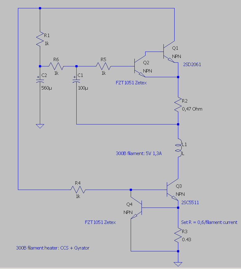

Isn´t 5,5V a little lean?
We did a std heater-CCS for 6B4G a while ago and found that good regulation didn´t, for some reason, occur for the 1084 until it had in the ballpark of 5V including resistor over it.
Also simmed the regulatorwith added ripple and it pointed in the same direction.
Don´t know how much your MOSFET needs over it, but this points to a total of maybe 10V?.

Lars, You may be right. If the chip is not getting adequate voltage headrooom, its current source characteristic will be degraded.
At 1A, ordinary FETs will lose 4 to 5V, "logic level" types 2,5 to 3V
10V is probably a good idea.

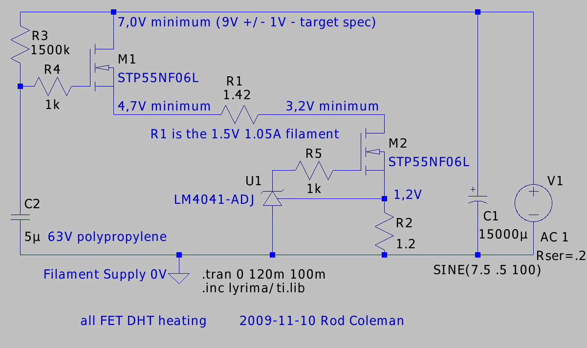

If the LT108x needs 5V of headroom to perform properly, we can improve on that.
This circuit uses the same FET in both positions, plus a 3-pin 1,2V reference chip.
If you use the exact parts noted on the drawing, it should work with supplies down to 7V. But you will want to work with real supplies with a tolerance, and some ripple: so 9V +/- 1V should be just right, and allow the use of 10V filter capacitors.

With the 300b I fed the LM1084 ccs from a variable bench supply and it seemed to regulate from about 8v. So I reckon on minimum of 3v headroom.

Bas, This is the known-good sounding 300B heater I have used for the past 5 years.
It only controls current, and has no voltage control. Even so, it still delivers 4.91V, 5 years after its last set-up.
Rod, simple and elegant design. 😎 I am sure this circuit has much better drop out performance than the typical monolithic, amongst other things. I think I will give this a try in one of my next amplifier projects. Hmm, maybe a respin for a GM70.. Thanks.. 😀
