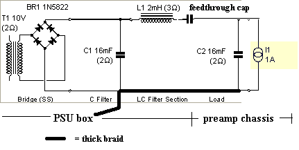

Rod, is this circuit attached below correct? Does it need to be a metal box or is wood ok?
Also regarding your final all fet heater regulator, how close does it have to be to the valve, is 17cm too far?

Rich, the feedthrough cap looks like this:
Rapid Electronics - Electronic Components
I think Farnell have these too.
The two leads are B+ in and B+ OUT. The body and nut form the other terminal of the cap.
Feedthough caps only make sense if you have a metal enclosure that you are trying to keep electromagnetic pollution contained within. The enclosure can be partly meshed, to allow ventilation of your trafo. Use braid to wire the cap -ve to the enclosure. you don't need the braid all up to the preamp itself.

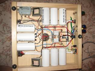

Here is a pic of my high voltage psu.

Your circuit diagram is wrong. You show a capacitor in series with the supply output. This will block DC. A feedthrough capacitor would be represented by a small cap from the output to the chassis, at the point where the supply passes through the chassis. A feed through capacitor is a wire that is surrounded by a layer (one or more) of dielectric that shunts RF from the wire to the chassis. DC current passes through the wire from one side of the chassis to the other.
Here's a description: What is Feed through Capacitor - Electronics Schematics Components Symbols
Look at the symbol at the top of the page, and imagine the leads from either side of the symbol connected to the chassis, and the through wire in line with your power supply lead.

Rich, the K73s will be a better choice than feedthroughs if you have a wooden box. With 1mH ferrite choke, 1uF or more will be useful.
FEeedthough caps are very effective at frequencies that leaded parts can't do much with |(>10MHz), but without a metal enclosure the HF/VHF/UHF may couple electromagnetically from the source of noise (eg rectifier recovery pulses) to the low level audio circuits.
Running the power from the trafo/rec/caps to the preamp via shielded cable can help, when a metal enclosure is hard to do.

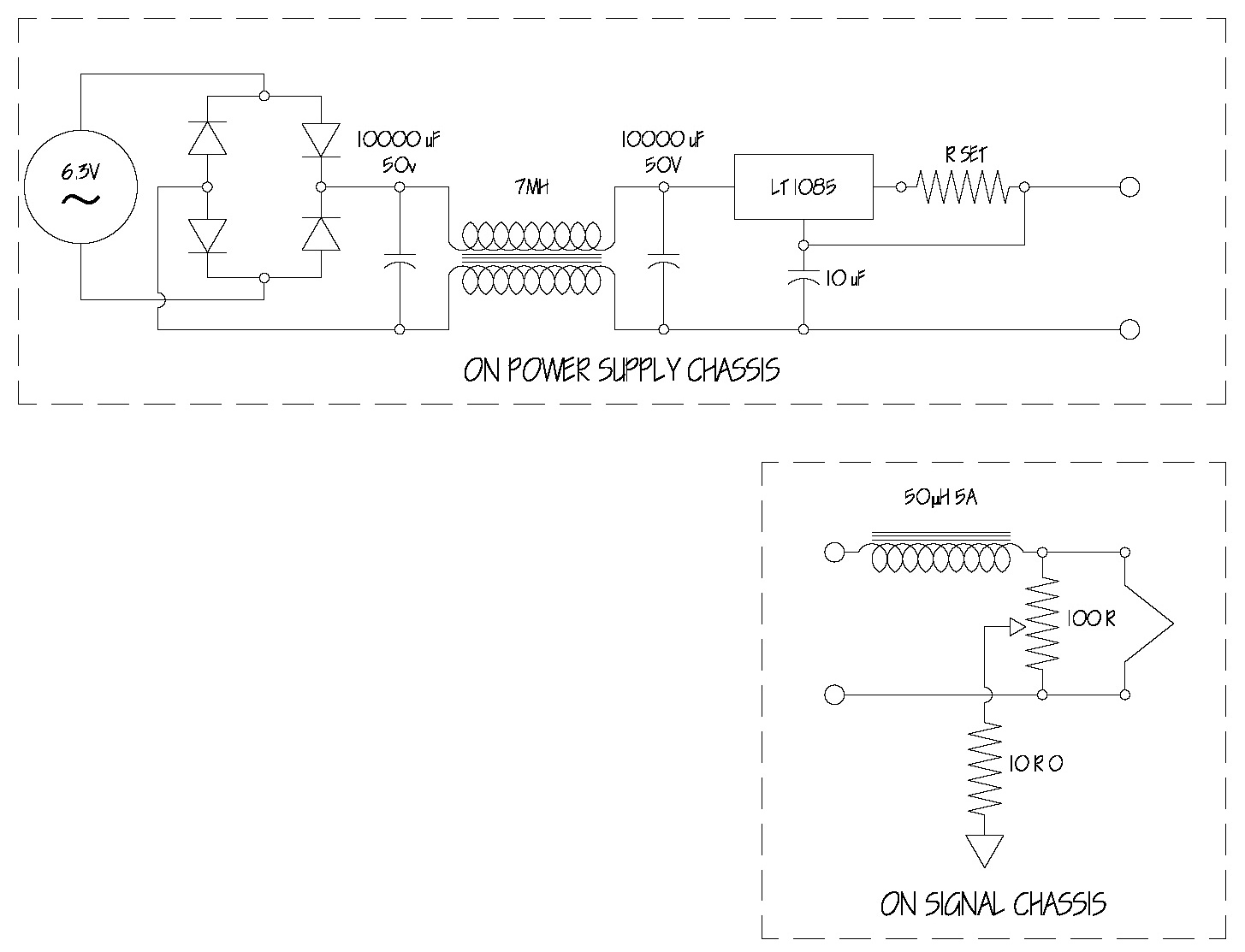

I am looking for a simple filament supply for the 26 that I can build with the parts I have on hand. I would appreciate any comments on this one. The diodes are high speed soft recovery types and the inductor has a ferrite rod core. I’m not really looking for ultimate performance just something quiet enough to get me started.

There'll be a little noise, I would expect, but there's no reason to hold you back on building. More L would help if the gyrator is out of reach. Increasing the C to at least 10000uF may also prove worthwhile.
Maybe look out for a logic level FET when you're next shopping, and work up a gyrator, if you want to go further.

I would up that inductor to a couple of mH as a minimum and increase the capacitance to 10,000uF or so, otherwise I think it would work ok. In this sort of application I usually use a voltage regulator ahead of the ccs to provide a little additional noise reduction.. Generally very quiet.
Small chokes (a couple of mH) between this supply and the filament will provide some isolation from high frequency line disturbances. (You can also use common mode choke and a single choke for both diff mode and common rejection improvements.)
I also like to use a "pseudo" center tap across the filament using a pair of 22 ohm resistors connected to a 10 ohm resistor to gnd for measuring the cathode current. (Thevenin equivalent resistance seen by the cathode is about 21 ohms) Note that you do need to account for the filament current that flows through these resistors.
Thanks for the help guys. I went back to the junk drawers and I could do this with the parts I have. Unfortunately though it brings up a few more questions. Is there a problem with using the 100 Ohm 2W pot rather than a pair of 22 Ohm resistors?
Kevin, when you say that I need to “account for the filament current that flows through these resistors” Do mean that I need to adjust R set or that I need to account for the plate current flowing through the resistors that make the ct when I measure bias? Or….both? I have to admit that when there are multiple sources of current in a network I am totally lost.
Thanks Again,
Marty
You have two current paths: Current that flows from the B+ supply, through the plate, through the filament and cathode resistor, then to the B+ return. In the filament supply path, current flows through the filament from the filament supply, and is returned to the supply.
I think that the 100R pot should be OK. As it concerns the plate current loop, the 100R pot is essentially two parallel 50R resistors, that are then in series with the 10R resistor (this assumes that the pot is near center). It will move your bias point a bit, as your cathode resistor will be in effect 25R+10R.
The 100R pot (doesn't matter where it's set) will be in parallel with the filament, in the heater supply current loop. Since the filament has a resistance of about 1.5R under operating conditions (1.5V at about 1A), you can probably assume that the parallel 100R will not be significant.

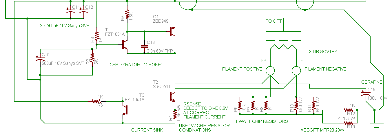

Apropos Pots and resistors across the filament. Heating with CCS can make DHTs sound much better than ac-heat - but (on the DHTs I've worked with) connecting a resistor across the filament can undo some of the advantage.
With 300Bs and CV1166s ( = Tungsram LP2) the resistor should be more than about 500 Ohms. I haven't experimented with the 26 (would like to now!) but would suggest using a higher value than 100Ohm, at least as an experiment. also, try just connecting the cathode resistor/cap to the negative side only, and compare the sound.
The macro difference between current source heating against dc (voltage) or ac is that the CCS presents a high dynamic impedance to the filament, over all audio frequencies. Perhaps there is a natural distribution of the cathode current across the cathode coating that is disrupted by low dynamic impedance schemes?
One thing I do know: if you convert a 300B amp to CCS heat, you can sit back and enjoy better sound. But if you then connect 1uF across the filament, the sound degrades all the way down to ac-heat level, and maybe even lower.

I use cathode bias, with resistors on both sides. They are different values, to let the cathode current make two voltage drops, 5V apart. The values are on the schematic.
Connecting the 1uF from F- to F+ wrecks the sound! I do have a cathode bias cap though - this old schematic shows it on the +ve side, but I think I found the -ve side sounds better.
