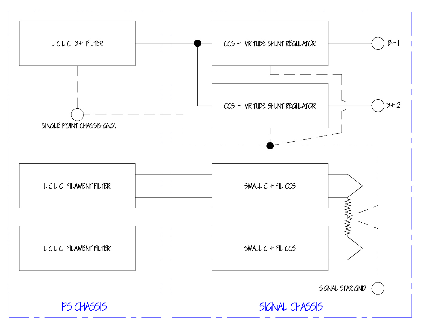

It goes without saying that the signal and power ground meccas must be connected together via the umbilical, and there should only be one connection between the two.
One point in each chassis becomes the point where all grounds are connected together - those, and only those gnd points are connected together between the chassis.
Do not allow filament currents to flow through the ground path in the umbilical - they must return through their own return lead. No filament current should flow into any ground whether in the supply or audio chassis - so they should be grounded only in one place. (In my case usually the PSU except in the case of dhts where I ground in the audio chassis as there is audio current present in that case. )
In the case of full wave rectification the center tap should go to the negative terminal (or as appropriate for the supply polarity) of the first filter cap and from there to the common grounding point (star ground) or grounded end of ground bus if you are using a bus. Same basic rule applies for bridges as well, except obviously it is one of the outputs of the bridge rather than the CT. This serves to keep the high ripple currents out of the ground path, and generally results in somewhat less ripple on the output of that first cap as well.

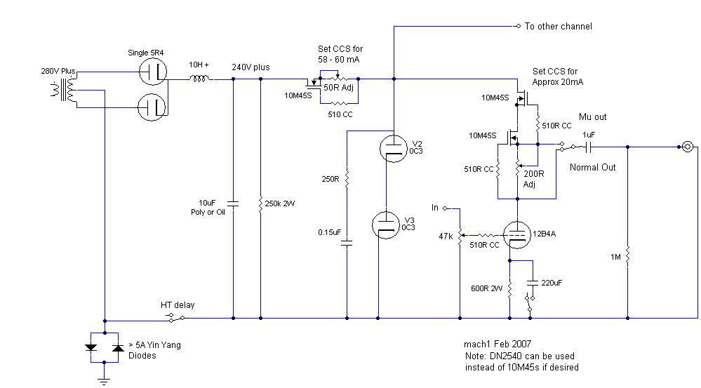

An IXYS cascode feeding the glow tubes is nice, however the max current one can dial in is less than when using single device.
I was forced to use use a single device in my 12B4 linestage (attached). From memory I think around 45-50 mA is tops for a cascode.
The big advantage over using a resistor is the increased PSR and the consequent ability to use only a relatively small amount of L & C in the PSU. I like using small oil caps in this application.
True, the IXYS part in cascode has a limited current range. You can get a little more with the DN2540. I use them at 65 mA with no problems, and have gone as high as 75.
I really like the CCS-gas tube method. Three out my four tube stages use it with excellent results. Reliable firing, ultra low ripple let through, and quite compact mounting. 4W dissipation is no problem at all with the right heatsink. And that beautiful purple, pink, or orange glow....

In the 12B4 schematic you are posting above, it seems like you are using one single pair of OC3 for both channels. I posted a question regarding a setup like this in one of the 12B4 threads some time back, and was told that I would probably need a pair for each channel. I never understood the logic behind this since the current is not passing through the VR tubes. Please, share your thoughts regarding this.

Yes, but only approx 22mA (5ma+40ma/2), and NOT the current that passes through the 12B4 tubes, right? If so, the VR tubes would be out of limit at 62mA (22mA + 20mA for each of the 12B4 tubes).

In the 12B4 schematic, 18 - 20mA is shunted down the glow tubes. This safely allows for one 12B4 to be pulled or fail without glow tube failure. If two tubes are pulled or fail simultaneously, then the glow tubes will be operating outside their max range of operation and will probably fail. If this scenario bothers you, then use a separate shunt for each channel.
A shunt reg only needs to be able to vary its current conductance over the range which the load fluctuates: its effectiveness depends on its ability to respond to change in source or the load.
If the shunt current is large with respect to the load current, then any change in the load current requires a proportionally smaller change in the shunt current, thus increasing its effectiveness (given equal shunt transconductance). Taking this situation to extremes, shunting 1000 times the load current through an entirely passive device (a resistor) can achieve an efficiency equivalent to a shunt based on an active device. However, one must remember that the effective transconductance of the glow tubes changes over their range of operation (from memory it peaks at around 14mA for a 0C3), and is reduced at higher currents. In this instance, the loss of transconductance resulting from biasing the glow tubes higher effectively swamps the proportionality gains referred to above, and also renders the glow tubes liable to failure should one linestage channel fail.
The answer: If you really need better shunt operation, use a separate set of glow tubes for each channel, and run around 14 - 20mA through each string. I didn’t have the space to do this, and seriously doubt the cost/complexity effectiveness, given that the glow tubes are being fed by and feeding highly stable constant current sources. If the current load was one which varied significantly over its operational range – eg class AB push pull or even regulating screen voltages, then extra shunt complexity would be warranted.
