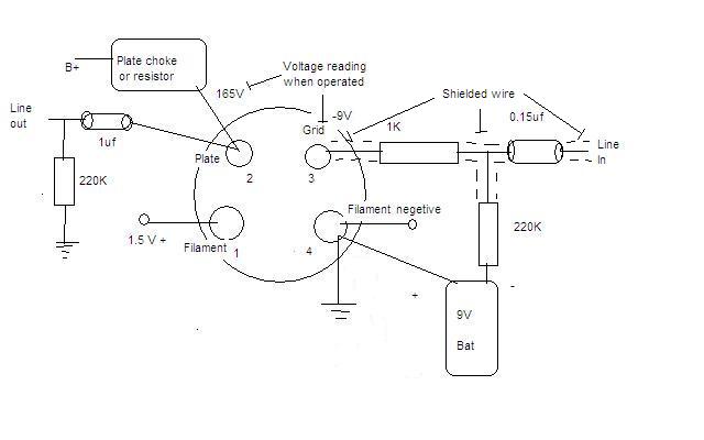

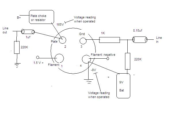

Martyh, grid bias which Kevin mentioned, works like charm. Fairly easy to setup. I tried both the biasing methods (cathode and grid with 9V alkaline batteries) and latter is the most sonically superior and least hum. If you check the first page of this thread, I have put the schematic used.

Regarding the schematic you posted on the first page of this thread, I do not understand the cathode arrangement. The 26 is a DHT, but the drawing shows an IDHT where a filament heats the catode... or am I misunderstanding?

Sorry for my poor skill of schematic drawing. I didn't have proper software to draw the schematic and barely manage to draw it using a free tool available on the net. Hence don't give much attention to the symbol I used for 26. This final schematic which I used was originated out of valued suggestions provided by Kevin and it proved it's capabilities when I built it.

I'm sure you intended the -9V reading to be at pin 3, not pin 4.
Sheldon
Thanks Sheldon for the correction. This is the updated diagram.
Anyone who is building this; make sure to use proper, shielded input to grid connections/wiring. Otherwise hum will pick up easily from these points.
