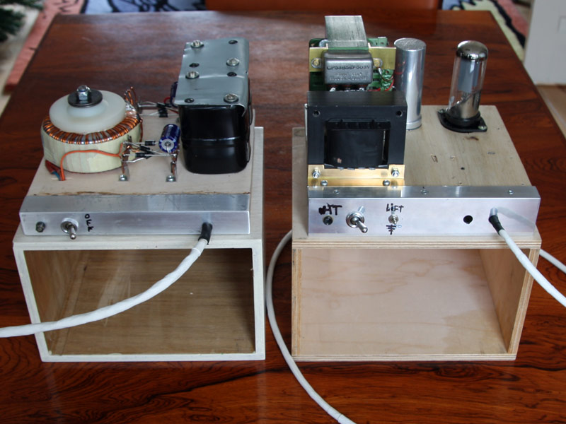

About supplies... here are mine.

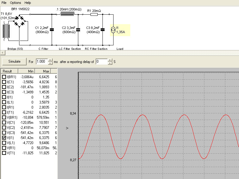

At the left the LV, made from a 8.6V & 8.6V toroid (diy 🙂) giving two times 8.3Vdc. It has Schottky diodes, 2200μF/25, 20mH oil filled choke (3A), 3300μF/25 and a shielded connection cable to the amp.
Ripple is down to 65mV. What's important: the wave shape resembles a sinus. If you just put a big cap after the diodes the waveform will be more triangular, very hard to flatten out afterwards.

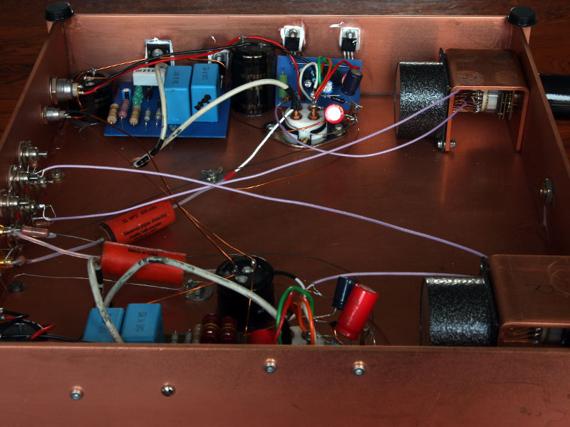

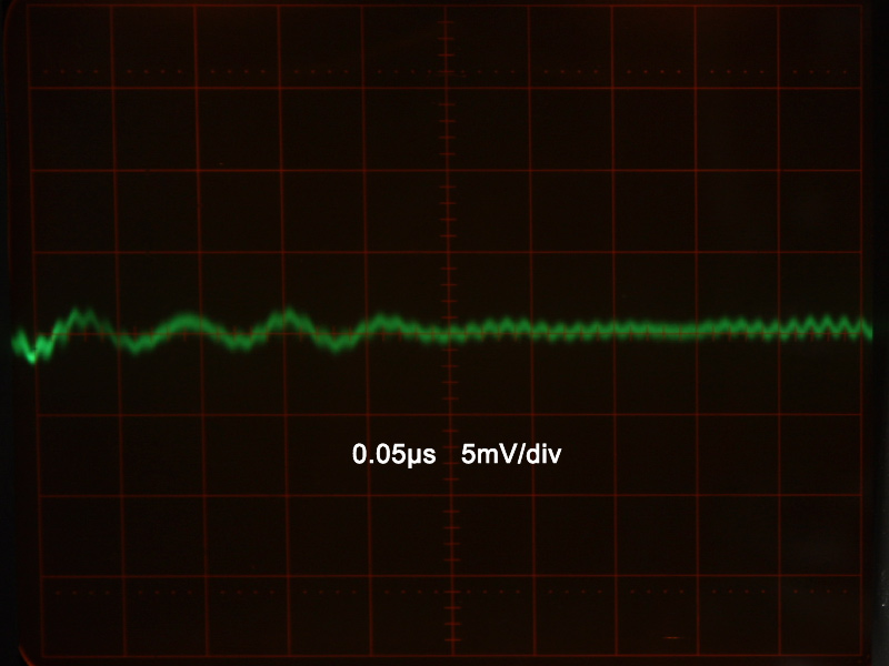

In the amplifier lays the big trick for today, invented by the illustrious Salas. The third picture shows the final ripple on the 26 filament, down to an extreme low 1mV level.

Hi Iko,
It's a residual I'm picking up, probably from the circuit itself. 1m cables, antique tubes prone to oscillation... who tells. Who does? 😀

What I meant is nothing so subtle, rather this: you talked about 65mV ripple, then you showed 1mV ripple. Something is responsible for that improvement. I was asking, what part of the circuit, possibly not shown, is the one responsible for going from 65mV ripple to 1mV ripple. Hope I'm not confusing the issue again.
Is is that "big trick for today" that did it?
Its the grand total noise on the notoriously sensitive #26 filament in a fully wired working preamp with everything on it, including what it can pick up from any field, and its own imbalance, plus decoupling technique. Final 0.35mV RMS AC noise on such a filament which is in circuit by being the cathode, is great, can't bother any system at all, and is skipping a nightmare that only DHT practicing DIYers can fully appreciate Iko.
Bravo Disco, you hit the nail on the head, upon first try! Without anything more dramatic than CLC and a small board with few components! The question boils down to fundamental heating strategy only, now. Is a hum free voltage source with extended and flat rudimentary impedance better than battery, tonally preferable to best Isource there is? To be or not to be (Vsource), that is the question.😀

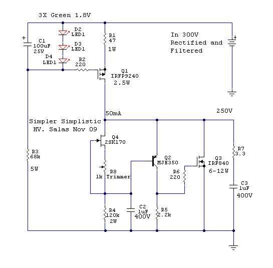

He is happy, thus humoring. He means a remote sensed simplistic shunt reg that we got it to work good enough down to 1.5V only. He can share the schematic and all application info for all #26 guys now it is a sure success as far as I am concerned.
Don't know if he will deem it better than a current source on sonic grounds in the end, but its a cheap, easy and buzz free alternative at least.
Only if you see the measures people take for a hum&buzz noise free #26 preamp...expensive and copious non fully hum free horror stories abound.

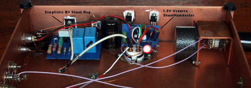

Ah, comme ça.

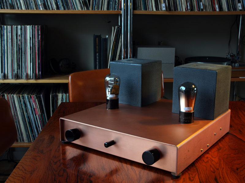

In the third picture you see two blue boards. The left is a Simplistic HV Shunt (V1.0), the right a noval Simplistic LV Shunt.
After discussing the pros and cons of voltage versus current source heating the DHT filament, Nick modeled a discrete parallel regulated 1.5V voltage source which is put in action here for the first time.
It consists of a 1.35A constant current source, isolating the 8V power supply and offering low output impedance. 0.3A is fed into a voltage source which maintains perfect smooth 1.5V on the filament. Remote sensing of the filament voltage is incorporated so an arm length of wire won't hurt.
First impressions are positive, measurements too but -hey- what a heatsink 😀 In the weeks to come I'll investigate the results of giving more current to the sink and compare it against some known excellent competitors.

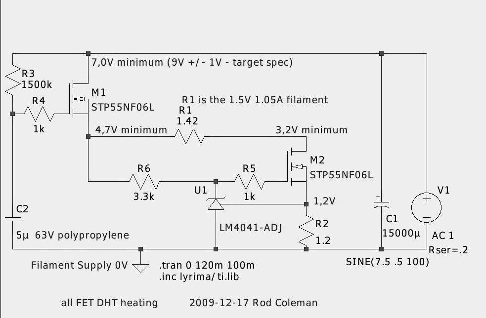

When you have a circuit that is sensitive to pickup (as the 26 appears to be), watch out for power circuits which measure flat dc, but have pulsed CURRENTs. I mean specifically reservoir capacitors! They may only have mV ripple voltage, but ampere-level recharge pulses. This generates magnetic field (B) and may couple to your grid or anode/cathode circuit. Keep the wiring loops to those circuits small!
Best solution for filter caps, especially for filament dc supplies, is to banish them to the hinterlands with their trafo & rectifier - a metre away with a shielded cable to feed the filament is my choice.
Hope you enjoy the build. If anyone considers my FET-based gyrator, note this updated schematic to fix an omitted resistor R6.
you can use the FET gyrator with the FET current source, or the BJT current source from my 300B circuit. If you substitute parts, check for oscillation with a scope and/or AM radio near to the filament.
