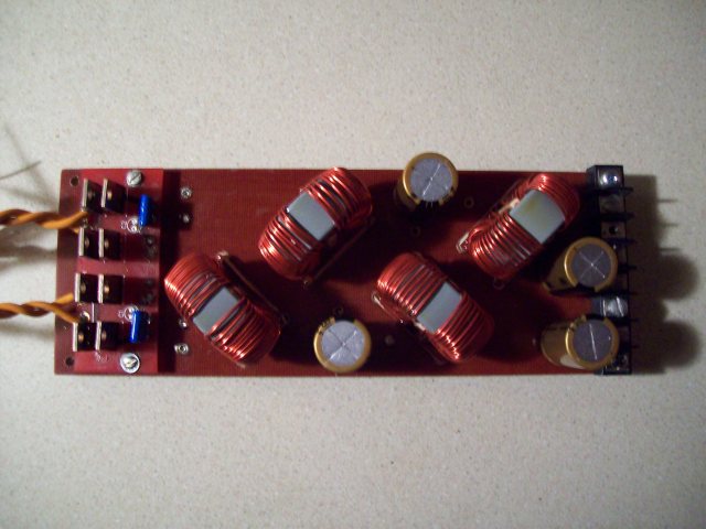

Salas, thank you for posting that schematic looks like I have a few Christmas projects.
Coolzero, my B+ power supply of fairly well filtered with chokes and finished off with VR tubes. I’m also planning to replace the series resistor before VR tubes with a ccs, just upgrading the filament supply for now.
I’m starting to put together Rods FET heater, should get my power supply chokes in a few days, Rod thanks for the updated schematic
Marty, good luck with the build. Are those chokes on a steel or ferrite core? The Hammond 60mH 2A is a cheap option, but not common mode. Here is a link to some test results for choke vs cap input.

preregulator filtering for filament supplies
Hi Marty,
They're ferrite cores. If you click on "Lynn’s postings" of that link in my previous post there is more information regarding choke input supplies for filaments along with a discussion. Essentially Lynn Olson suggests 2 chokes (with steel laminations) just after the bridge rectifiers, one in the + rail and the other in the ground (b4 -'ve terminal of the 1st cap). He goes on to suggest a common mode choke, like the ones in a computer psu, to filter high frequency noise.
I'd like to hear your opinion regarding the results you get.
Somewhere in that blog, someone suggests a 3pin regulator wired as a ccs, to simulate the filtering offered by a choke. I also recall seeing this in one of DHT Rob's schematics. It was something like XF Bridge- cap-ccs-cap-ccs-cap ccs- filament. Lynn points out the ccs will drop more voltage than a choke.
Rich
