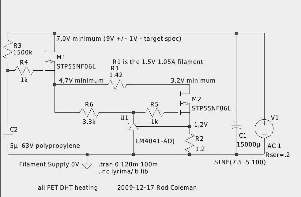

Hallo,
Here is the circuit for the 26 filament:
Set value of R2 to get the filament current.
Set the supply voltage to be
filament voltage + current sense voltage (1,2V here) + 2x FET Vds (2 to 3V each)

C2 not critical. reduce it all the way down to 470n if that's what you have at hand. Experiment with increased R3 if you do that. The C2/R3 filter is there to reduce hum level at the filament even further. The sound improves even when hum is inaudible, though.
R2 is burning about 1,5W for the 26, but you don't want it getting hot at all. I like the 20W TO-220 resistors here (see Farnell), attached to to chassis or heatsink. The others are low power, so any nonmagnetic will do - I use 1206 chip resistors so that the circuit can be built small - this reduces the chances of EM pickup of any kind, which is important in any audio circuit.

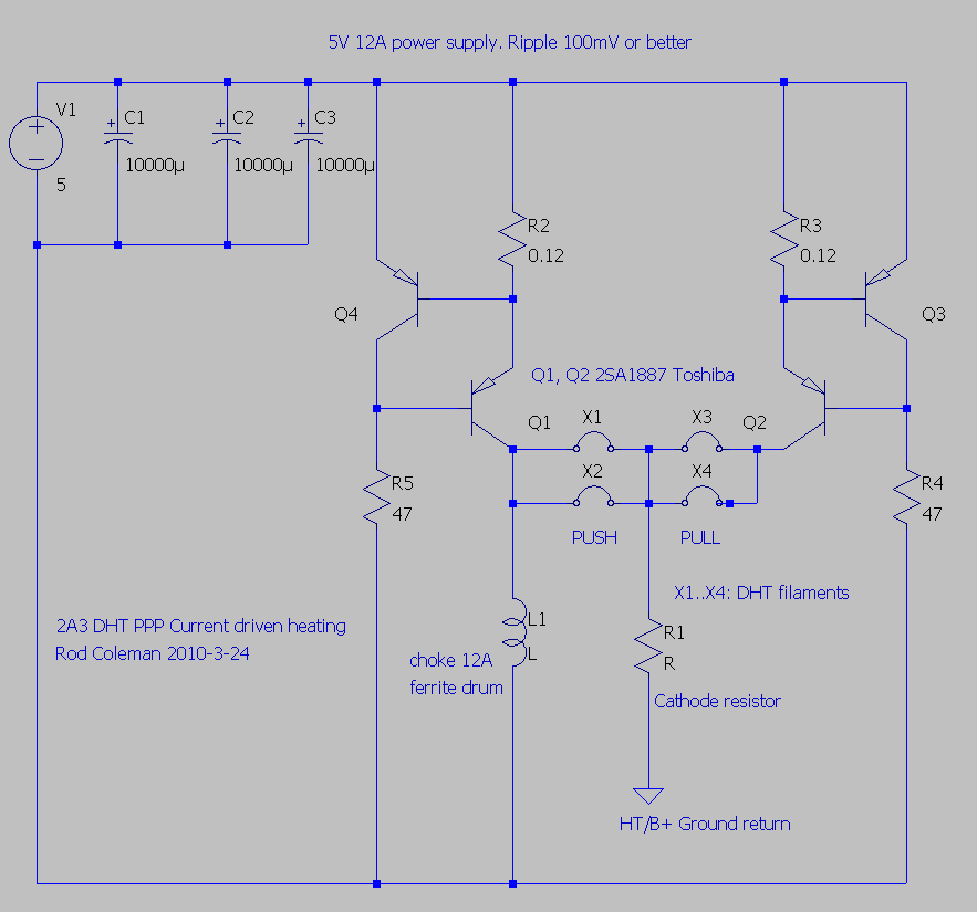

Hi Rod:
Thanks for your advice. Just a little bit more about my PPP 2A3 : they are indeed Sovtek, matched quads for each monoblocks. I have connected the four 2A3's heaters in parallel on each monoblock and feeding them with 2.5 V tap directly from my PTX. Assuming that each heater takes up 2.5 A, you mean to say that the 4 FET (2 FET for gyrator and 2 FET for CCS) will be enough to handle the 10 A current, is that right ? Any other modification in your scheme ?
Second question, since I am using cathode bias, should I connect the cathode bias resistor to the "filament supply 0 V" of your circuit ?

Trying to design the PPP DHT heat is harder than it looked!
The negative side of the filament should be connected to the cathode resistor. This dictates a P device providing current source. Looking at the available FETs that will operate at 2V or so Vds (factoring in Rds(ON) at 5A) the capacitance is an absurd 500pF or more at the working voltage, which is going to let all the HF noise straight through!
A PNP transistor will give much better performance, but you must choose carefully. The Toshiba 2SA1887 will deliver 5A at 1V Vce, and 40mA base current.
Attempting the gyrator at 10A would be tough. Probably best to find a drum-cored choke that can take the current and use that instead. The diagram tells the tale.

Forgive me to ask this silly question, but I don't understand why there is only 1 drum cored choke L1 ? What should be the spec of the choke ?
