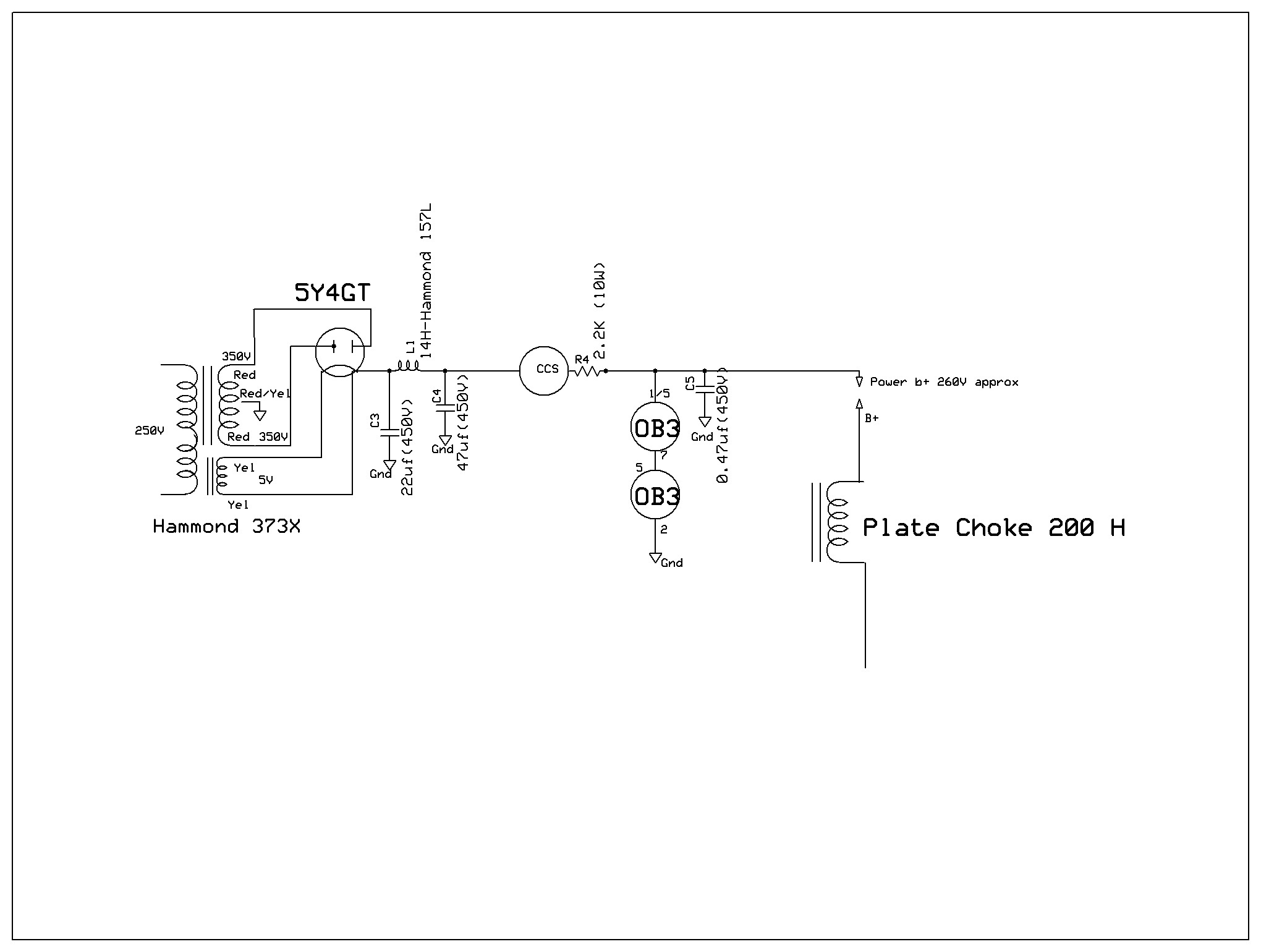

Attached schematic shows what exactly I have now.
For CCS between choke and B+ supply, I used K&K audio, compact CCS (K & K Audio - Lundahl Transformers, audio DIY kits and more). Filaments are in series, fed by a SMPS used in DVD players (SMPS fo DVD SMPS - 226 SMPS for DVD CN;GUA products). SMPS works well to reduce the overall hum drastically, which I couldn't control using any other simple filament supply. Plate chokes are from EP (Electra-Print.com High-Fidelity Audio Tranformers). Most of the components I used which I had already. It is not necessary to have the exact same part mentioned. You could easily find alternatives for some of those for a lesser price.
However, to make my pre a pure DIY I am planning to replace B+ PSU with Salas simplistic regulator and Filament supply with Rod's Gyrator/CCS. Hope it will give me a better result. You could easily find the details of those in this thread if you wish to use those as well. This thread includes pretty much everything you need to build a hum free wonderful sounding 26 pre. Good luck.

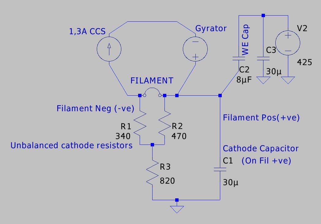

In discussing filament heating, I mentioned connecting the cathode capacitor to the negative side of the filament for best sound.
When I went to my 300BSE to mod something today, I found that I had not wired it like that in 2004. And when I tried moving the cap to the negative filament, the sound degraded badly - especially, the image was very unstable.
If you use a cathode capacitor, be sure to try it on both sides, to ensure you get best sound.
The drawing shows exactly what I use on 300Bs. The cathode resistors are split, to try to ensure that the anode current drawn from each side is the same.
C2 is the Western Electric cap, designed to improve supply rejection.

Hi Rod,
Some advice needed here. Right now I just have a LM1084 as a current source for the 300b filaments. No gyrator. I've connected the plus to pin one and minus (off the capacitor) to pin 4. I've put the cathode resistor on pin 4. Should I put it on pin 1 which is the filament positive? I haven't used a cap yet - where do I connect that?

hello Andy,
The SE connexion sounds correct. As far as I'm aware the 300B is symmetrical (not the case for every DHT) and so either filament pin can be +ve.
If you only have one cathode resistor, connect it to the FIL -ve. Then connect the capacitor to the FIL+.
If you don't use a gyrator, try adding an HF choke in its place, to be sure rectifier current pulses and mains noise (from the filament supply) are minimized. This is especially important if your trafo is toroid.
As you've found out, the current source makes more difference than the gyrator in most cases.
With PP, depends on whether you're using a common cathode resistor, or two separates. With 2 resistors you can use 2 circuits just like SE, which I suspect is the highest quality route.
With a common cathode resistor, you CCS must be a source (not a sink), and the circuit becomes like the one I posted for PP at post 348:

Hi Rod,
As you know I'm not an EE but a humble hobbyist, and I sometimes get thrown by the theory if I'm unfamiliar with it. so I looked up current sink and source on Wiki and by the time I was knee deep in biological membranes and trolls lurking in rivers I gave up. It's a wacky read!
So am I right in thinking that a "source" is in the positive line? That's what I have - LM1084 with the input positive from the reservoir cap and output going to pin 1 which is nominally the positive pin. The negative of the cap then goes to pin 4. I'm attaching the common cathode resistor to pins 4 and 4 joined of the two 300b outputs.
I don't have room for chokes, but I'd be interested in adding a simple gyrator. I have a few LM1084 so tend to use those. Can you suggest a circuit that would add a gyrator to the LM1084 current source (or would it be sink then, if the LM1084 were in the negative side - bit hazy here?).

Andy, the quickest gyrator is just to take the ST logic level FET named in the FET version of the circuit (in this very thread).
Connect the CCS to the negative side.
Connect the V+ to the drain of the FET. connect a 1M or 1,5M resistor to V+, other end to a 1 to 5uF MKP capacitor (cap's other end to ground). Connect the RC join to FET gate via 1K resistor (carbon composition or 1206 thick-film chip). Minimise the gate wiring absolutely, or there may be subtle, or not-so-subtle oscillation trouble.
The FET source is your gyrator output.
Make sure there's 2V across the FET, and that heatsinking is adequate, before using on a filament (I use a pair of 2 Ohm 25W resistors to test them)

No pardons needed. Some trial and error is good. Some engineering beforehand is even better. A current source fed shunt supply is a good combination. That what Salas's supply is. You can do it with what you have. I'd take the current source you are using before the plate choke and put in in place of R4. Increase the current so that you have about 20mA through the VR tubes. Use two OB3 tubes (will give you about 180V. Note R12 from B+ to the connection between the VR tubes on my schema. That's optional, but can help the tubes fire up). Use something less than 0.1uF cap after the VR tubes, or use a voltage divider and two small caps after the VR tubes (see the schematic I posted). Remove L2 and connect the supply to your plate choke. That should be a nice quiet supply.
If you want to try Salas's supply, just remove everything between C4 (I might use something bigger than 1uF there) and the plate choke and plug in the Salas circuit.

Sheldon,
I tried this and below is what I have ended up with. This gave the best sound overall and quieter B+. Overall sound of the pre improved noticeably and now there is much more resolution and control to the bass and treble. Thanks a lot, it worth the change.
Looks nice and simple. You can probably remove R4 also. If the current source is a robust design and can dissipate the heat from the voltage drop, the resistor isn't necessary. You show B+ at the plate choke at 260V. Are you sure that's correct? I'd expect something around 180V (two 90V VR tubes in series).
Sheldon
Checked out the KandK current sources, and your transformer. Looks like you are dropping around 200V. So, on second thought, unless you have a hefty heat sink, I might leave the resistor there to dissipate some of the heat. Not sure of the size though. How much current through the tube? Does this supply one tube or two channels? I'm curious on Rod's take. Would a dropping resistor be better before or after the CCS?
Sheldon
Not exactly. There is no gain error loop active regulation in this approach. Performance isn't on par. Although nice and very ''tube''.
Didn't mean to imply complete equivalence - just that both are shunt supplies fed by a current source. No question, your shunt regulator is much more sophisticated, and more tightly regulated, with lower Zout. Better "performance"? Certainly, in technical terms. Sounds better in this circuit? I guess it would have to be tried. It won't look as cool, though.
