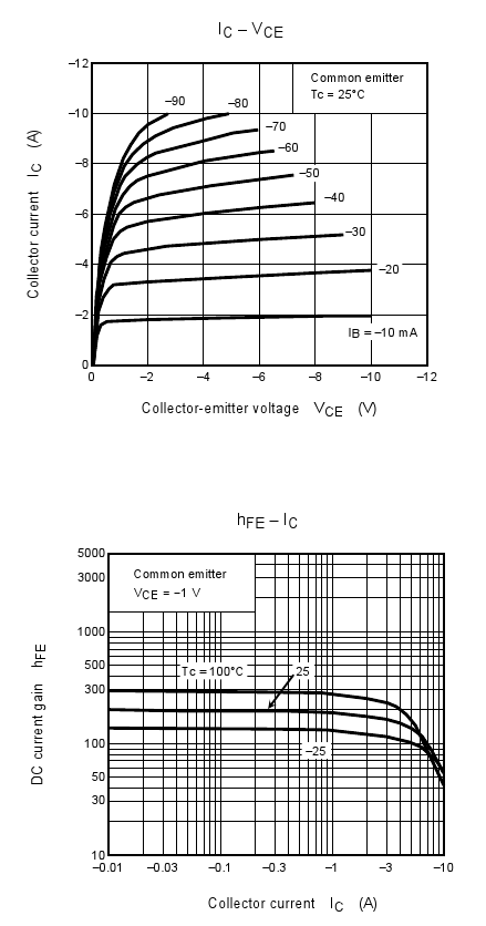

Forced beta of 10 is right for any circuit requiring saturation, or any circuit using old design BJTs. I had not appreciated how far behind the MJE15032 was compared to the Japanese, like the ROHM 2SC5511 I made my original heater with.
Since ROHM have withdrawn that one, we must turn to TOSHIBA. They have NPNs and PNPs with hugely improved performance, backed up by a specification that covers our area of interest. For PNP, just look at the 2SA1887 specs: over 5A for 40mA base current at 2V, specified.

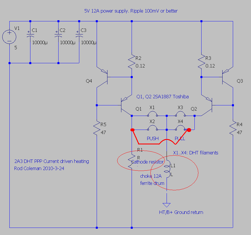

Forgive me to ask this silly question, but I don't understand why there is only 1 drum cored choke L1 ? What should be the spec of the choke ?
Once again, thanks for your help.
NG

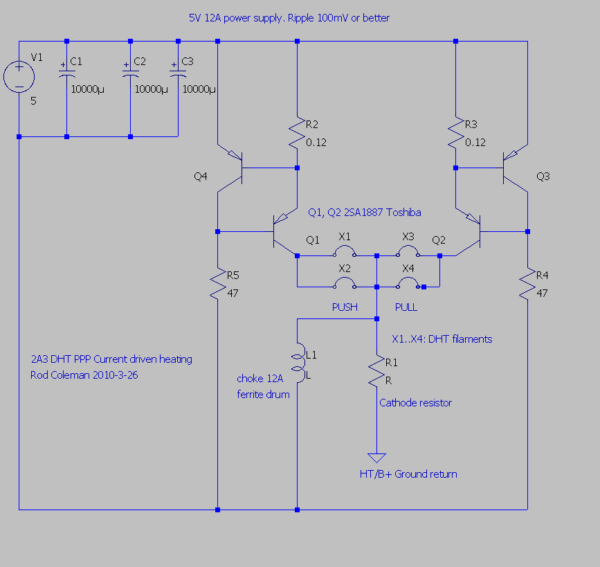

NG, how many cathode resistors do you have? If there is only one shared, then one choke must be used. If PUSH and PULL have their own resistor,use 2x 6A chokes.
For 10A, Try the EPCOS B82725J2103N022 double toroidal ferrite choke. Wire the + and the -ve through it. This does a great job of sucking out HF noise.
EPCOS|B82725J2103N022|CHOKE, RING CORE, DOUBLE, 1.8MH | Farnell United Kingdom
Both chokes together drop 0,26V at 10A, so be sure you still have 5,0 .. 5,5V remaining at the CCS under full load.

Hi Rod :
One more question : heater 26 preamp gyrator/CCS application :
For the FET gyrator/CCS, since I will be using cathode bias, should I place the cathode resistor in between "filament supply 0V" and HT common ground ?

NG, Connect the cathode resistor (& cap if used) to the negative filament terminal on the valve base. Connect the other end of the resistor to HT 0V (Ground).
When you buy parts for the 2A3 build, get some 1 ohm 15..25W resistors to test it. build and adjust the current sense resistor till the 2A3 filament has 2.4..2.5V across it (no more!). Then, leave it for some hours on test, keep checking the voltage, and make sure the transistors don't get too hot. That way, you can be sure your heatsink is big enough.

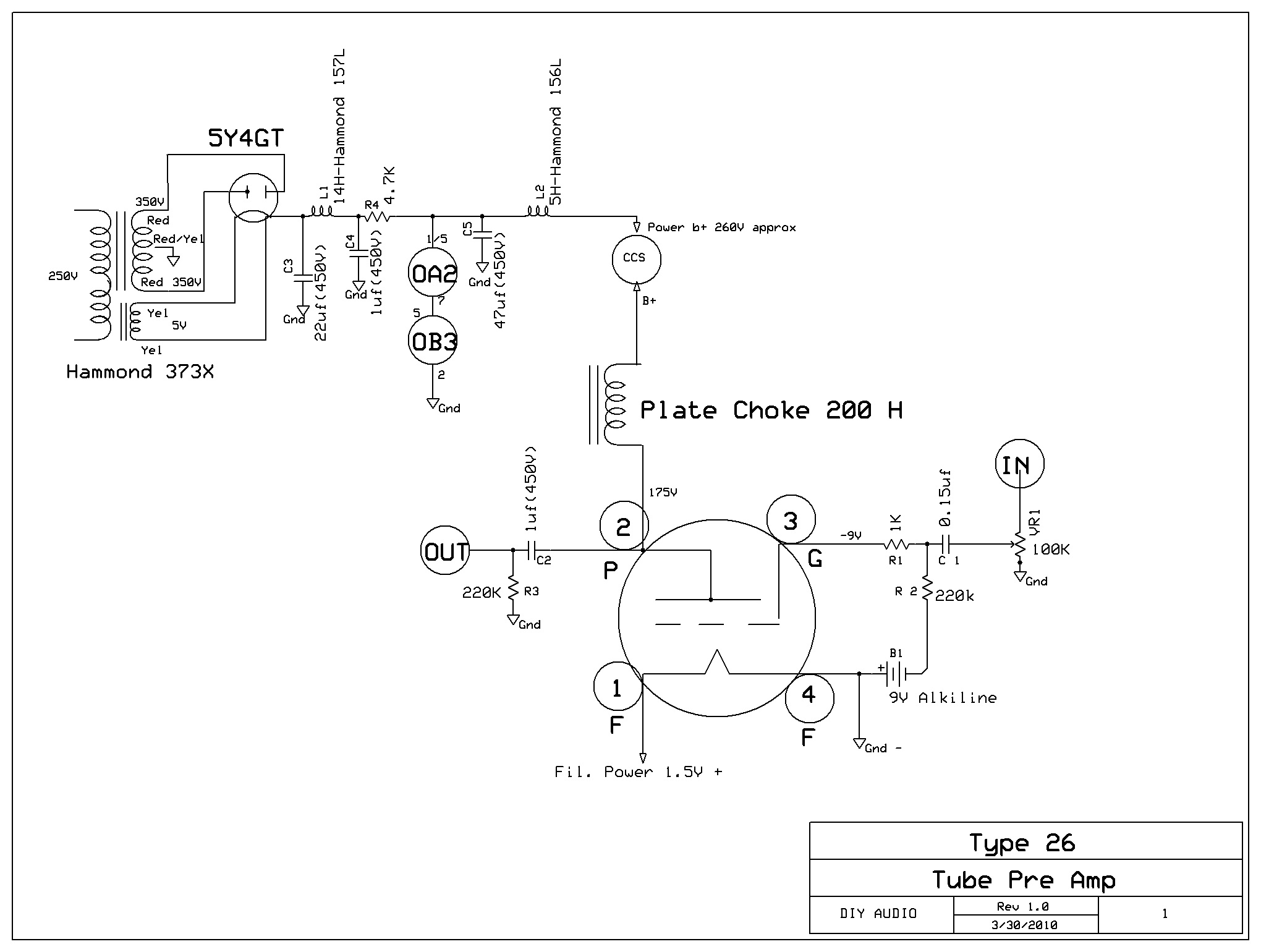

Finally I have completed the pre-amp. Attached the schematic (sort of Kevin Kennedy, Jim D'Cort mixture). Thankful to Kevin for his great advices to come up with this final circuit which work nicely and worth all the efforts. Used a PSU with Hammond 372 X (which I had already otherwise an overkill I suppose) +5U4GB+10K(5W)+OA2/OB3 tube regulators+IXCY CCS (kit module K&K Audio -http://www.kandkaudio.com/accessories.html) to produce 250V hum free B+ which I built out of randomly picked up items I had already. Otherwise, any simple PS schematic would work I assume. For me, use of regulated B+ helped towards reducing the hum drastically. Hum with unregulated B+ was unacceptable to me (even though it sound great). For filament, I used a cheap China made external DVD SMPS which worked greatly with no hum at all. 🙂
Attached a picture of the final product (pardon for my poor craftsmanship).

Attached schematic shows what exactly I have now.

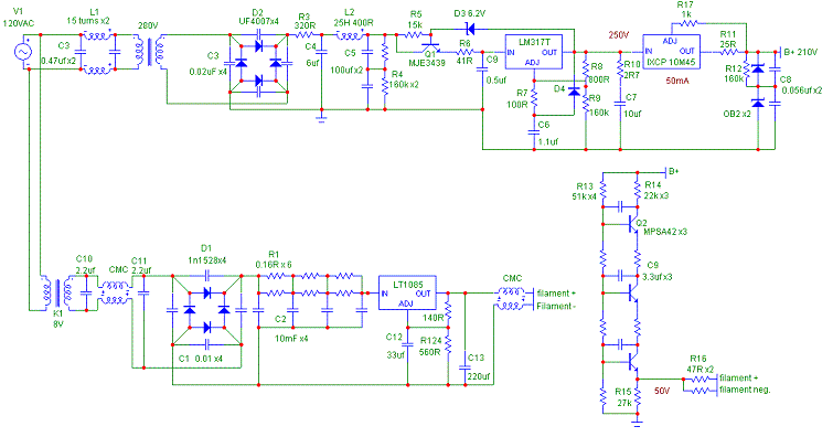

For CCS between choke and B+ supply, I used K&K audio, compact CCS (K & K Audio - Lundahl Transformers, audio DIY kits and more). Filaments are in series, fed by a SMPS used in DVD players (SMPS fo DVD SMPS - 226 SMPS for DVD CN;GUA products). SMPS works well to reduce the overall hum drastically, which I couldn't control using any other simple filament supply. Plate chokes are from EP (Electra-Print.com High-Fidelity Audio Tranformers). Most of the components I used which I had already. It is not necessary to have the exact same part mentioned. You could easily find alternatives for some of those for a lesser price.
However, to make my pre a pure DIY I am planning to replace B+ PSU with Salas simplistic regulator and Filament supply with Rod's Gyrator/CCS. Hope it will give me a better result. You could easily find the details of those in this thread if you wish to use those as well. This thread includes pretty much everything you need to build a hum free wonderful sounding 26 pre. Good luck.
I don't understand your B+ supply. You take a perfectly good shunt regulator and follow it with a choke and CCS, then a plate choke. I can't believe that the choke and CCS are necessary for good noise performance. If so, there is something wrong. Normally, the OD tubes are followed by a small (less than 0.1uF) cap. A large cap can cause oscillations. The following choke complicates the picture further. Have you tried it without the choke and CCS, and with a proper small cap?

Here's an example of a little overkill: The Miada regulator before the current source offers some ripple reduction to the current source. However, the primary reason I put it there was to offer high voltage protection to the current chip, in event of a no load condition (OD tubes disconnected and ps disconnected from amp). This supply powers a phono amp that has a cascode input, with essentially zero PSRR. Note that the zener symbols at the output represent OD2 tubes. There is no filtering after them and the amp is quiet.

Sheldon, pardon my amateurs know how in this subject. What I did was just a trial and error. For some reason it worked. I would definitely try your suggestion and let you know how it goes. Thanks a lot.

No pardons needed. Some trial and error is good. Some engineering beforehand is even better. A current source fed shunt supply is a good combination. That what Salas's supply is. You can do it with what you have. I'd take the current source you are using before the plate choke and put in in place of R4. Increase the current so that you have about 20mA through the VR tubes. Use two OB3 tubes (will give you about 180V. Note R12 from B+ to the connection between the VR tubes on my schema. That's optional, but can help the tubes fire up). Use something less than 0.1uF cap after the VR tubes, or use a voltage divider and two small caps after the VR tubes (see the schematic I posted). Remove L2 and connect the supply to your plate choke. That should be a nice quiet supply.
If you want to try Salas's supply, just remove everything between C4 (I might use something bigger than 1uF there) and the plate choke and plug in the Salas circuit.
