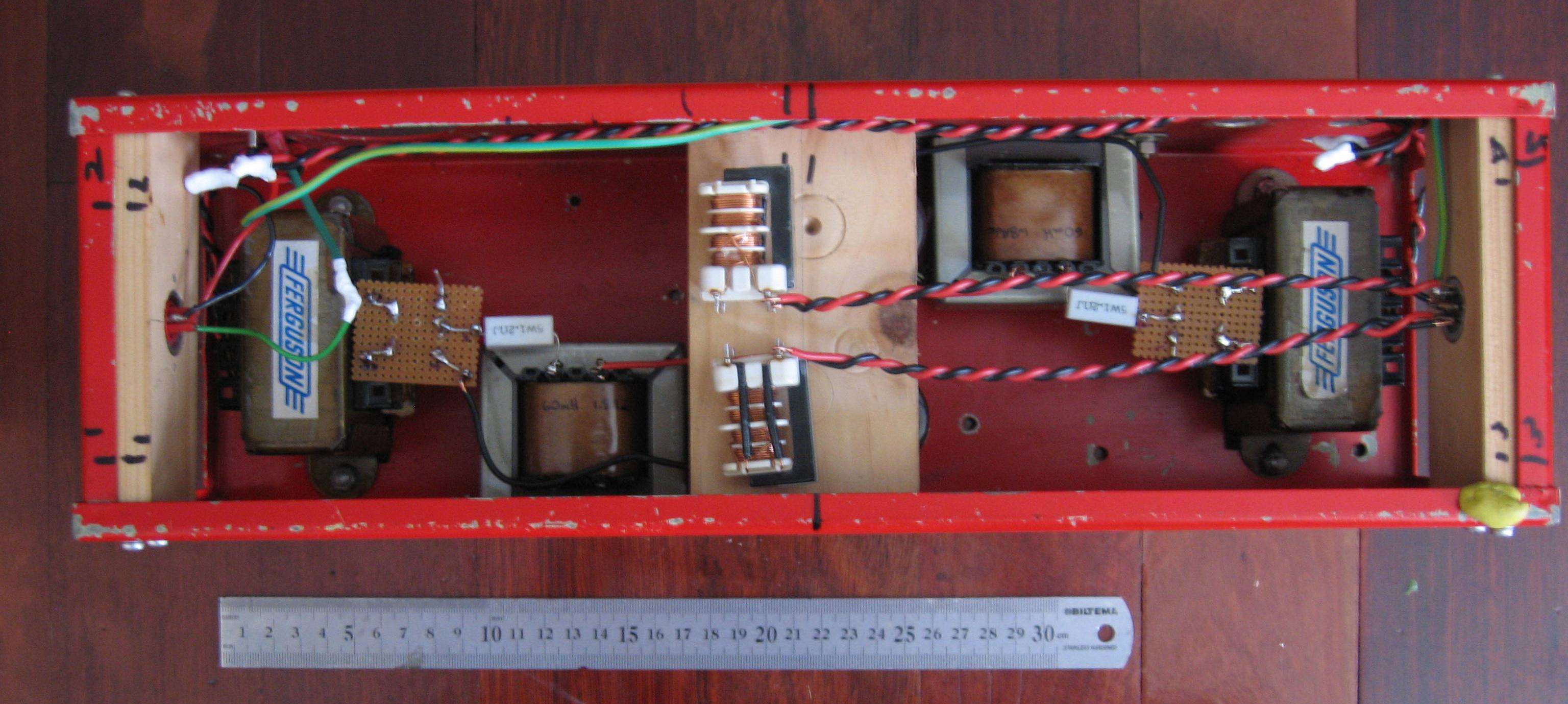

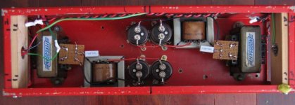

G’ Day All,
It has been a while since anyone posted updates on their 26 project, I suspect many are busy hunting Arcturus 126 tubes on ebay, see the prices the last few went for. Don’t listen to Coolzero, the blue globe 126 are not that special.
I managed to finally finish my filament power supply, I’m using a 60mH choke input (followed by 32000uf & common mode choke) all sealed up in a steel chassis. The output voltage looked really nice on a scope as a neat sine wave. I wired up the filament with a ccs and switch that allows me to use the 26 and 01A. The net results of the choke input filament supply was a more defined bass, I’m still yet to add 0.22uF snubber caps and lower the Q as per Morgan Jones’ suggestion.
I found that shielding the plate chokes in aluminium boxes also helped and that if shielding the tubes with Al or Cu, holding it down with rubber “O” rings can help a lot. The pearl tube coolers also work well to reduce microphonics.
I have a question in regard to the Russian FT-3 teflon caps, did anyone ground the metal can/shield or is it better to just remove it?
Has anyone that has experimented with other output caps, have results to share?
Rich

Hi Regal,
No matter what DC power supply one uses, it is still hard to attenuate the hum. I started off with a simple cap filter, followed by voltage regulator then CCS like Andy’s setup. I then upgraded to a larger transformer (12v 5A, just because I had it lying around) and choke input filter 60mH 2A, followed by common mode choke, see pics in post 303. I followed the advice here and had it all sealed up in steel enclosure. Only by shielding the tubes themselves did I get it quiet enough. I should also point out my speakers are rather efficient at 97db. I haven’t tried Rod’s or Salas’ regulators yet. I also posted a link to some tests on choke input filament supplies in post 289
My B+ supply is very similar to Andy’s, but I’m also using chokes in there and a VR 105 and VR 90 for a B+ of around 188V.
