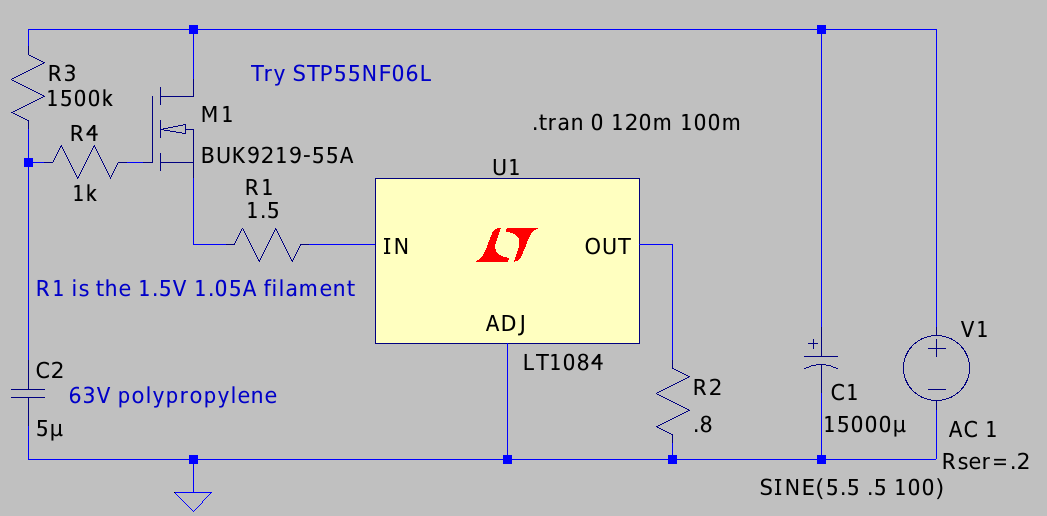

I remember somewhere I read that someone combined a + and a - filament voltage regulators and yielded tiny hum. Could this because the signal path was somewhat isolated from the power supply? 😕
So another thought here...how about in the filament regulator, one puts a 1083 current source, the filament and another 1083 current source in series, would that creat any enhancement to hum isolation from ps? 😛

I gathered at the end of that post, Thorsten suggested something like using the LT1085/1033 pair.
Could anyone come up with that circuit? Would it simply be that just using 1085 ccs in the + path to filament while 1033 ccs put in place at the - path? So a current source and a current sink is born? 😀

Sadly, that would give very different performance. I believe Thorsten was thinking out loud there!
One reason the current source filament drive sounds good is that the dynamic impedance (presented to the filament) is high. Adding a voltage regulating loop results in LOW dynamic impedance, and the sound is degraded.
If you are concerned with ease of build, you could use the LT108x as current sink (negative end) but try to build the gyrator - it's easy to do, with no stability troubles.
Alternatively, could even use a FET for a single transistor gyrator solution. In that case, use 1M gate supply resistor, 470nF capacitor, 1K gate resistor stopper (right at the gate pin).

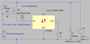

Cheung, try this for FET-gyrator version. Just make sure to us a FET with high power handling, and low threshold [Vgs(th)]. STP55NF06L seems a good low cost starting point.
I prefer the bipolar transistor current source, but for folks that like the chips, here's the LT1084 in this case. You might get away with 5.1V - but 5,5V supply would probably be better. The FETs have higher overhead than bipolar transistors (and so will get hotter, too). Take care to bolt the FET to some big piece of chassis!
