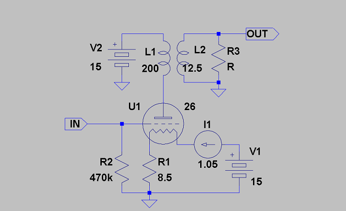

Can I eliminate the cathode by-pass e-cap anyway since it's a constant current that flows throught the cathode resistor? and can I connect the parafeed cap at the cathode resistor rather than the ground?
And, just one more question, I noticed some filament filter circuits that employ a common mode choke between cathode and regulator, is this something helpful for further removing hum? Any recommendation there?
Thanks so much!
CFT
Unfortunately although you are operating in constant current mode removing that bypass capacitor will result in a much higher rp which will result in rather poor HF performance.
I would recommend trying battery bias as previously discussed using RC coupling in the grid circuit to inject the bias voltage - this would allow you to remove both the cathode bias resistor and the bypass capacitor.
The parafeed cap can be connected to the cathode connection in any of the situations described above, however the cathode bypass cap is required for the reasons mentioned.
Incidentally the cathode bias wants to set your operating point as well as your CCS, in this case you should allow the CCS to do it. If you do not want to use the battery bias mentioned something like 5 red leds in series in place of the cathode bias resistor & cap should make for an audible improvement. You can try connecting the parafeed cap between the leds and the filament. (Try both there and normal circuit ground - you may or may not prefer one over the other.
Hope this all helps.

Kevin refers to red LEDs, and I just tried those in place of a cathode resistor. Initially I was excited - very clear and dynamic. But there was an edge to the sound I couldn't live with, and I took them out and put in a wirewound cathode resistor. I found that fine - the smoothness returned and sound was only marginally less clear and dynamic.
I'm using cap out, and I didn't find any loss of treble without a bypass cap so I left it out, so with cap coupling that's a good option. With transformer OPT, just as Kevin says, you want to keep the Rp low.
As for operatint point, I've been using a 150v glow tube and that's really too low - I need two to give 210v or 265v depending on the tubes. So with 3mA through the 26, the sound really is a bit thin. So will need to up the HT and the current as said in previuous posts. Looks like the 26 likes to be run hard - or at least quite hard!

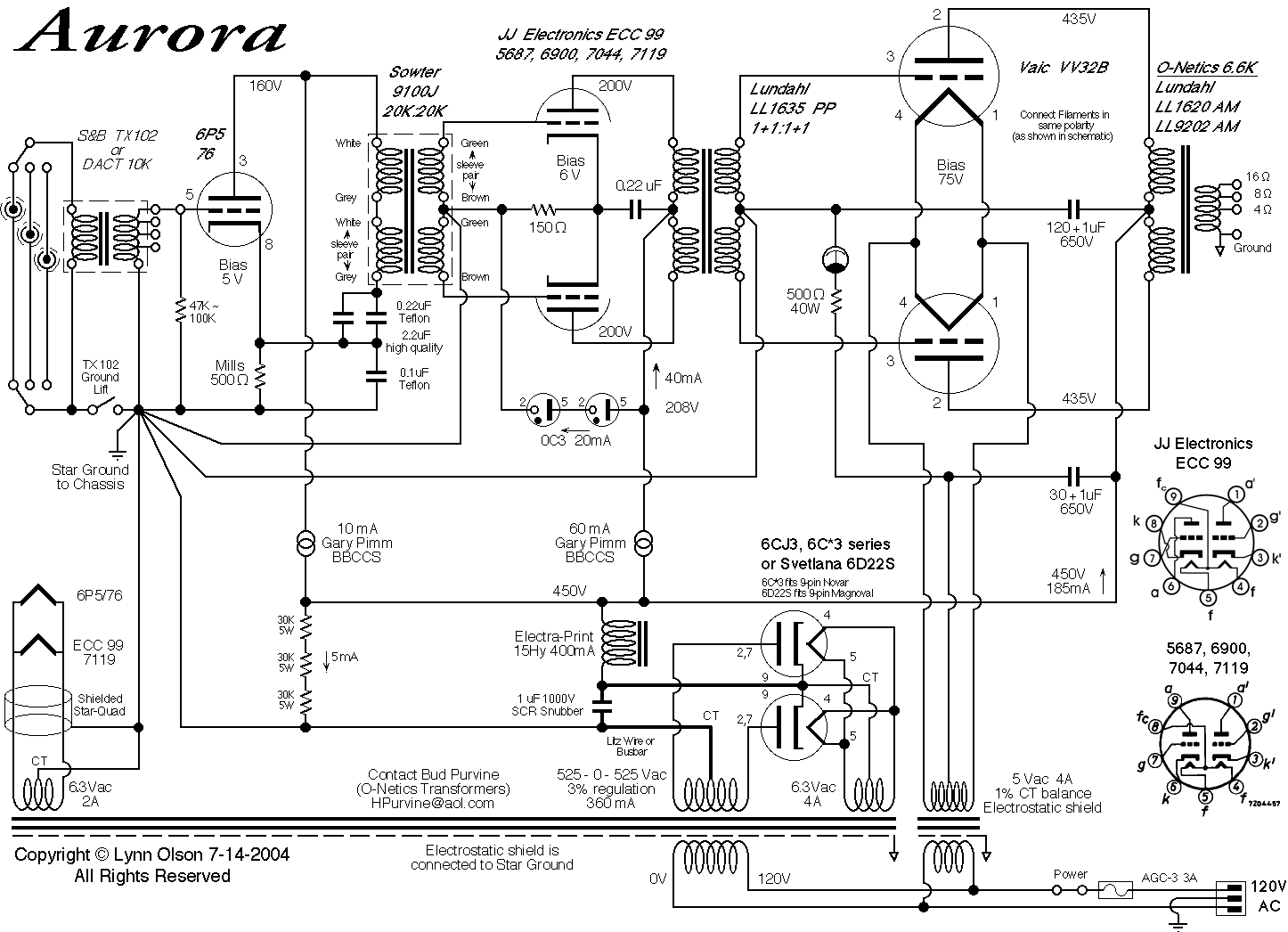

It is the driver stage. More precisely the para-feed driver of the WE 92a, for example:
Western Electric - Rosetta Stone for Triodes
You just put a CCs (or a choke) in place of the 100K resistor and play a little bit with the caps. However I think you need the input trans to get the best out of it.
This is a recent one (look at the input stage): http://www.nutshellhifi.com/GarysAurora.gif
Another interesting schematic is that of the Klimo Beltaine. The output stage uses a SE 300B through 1/2 primary of a PP output trans, the DC induction is balanced using an EL 34 connnected on the other half. You could use the same principle for the preamp.
I don't have schematic right now but I have seen it somewhere. This little 5W amp was really delicious. It is a pity it has been discontinued.....

There is one way of biasing a DHT not mentioned here. When using the heatercurrent to get the necessary cathode biasvoltage no decoupling cap will be needed.
This is just an HOT idea, have not tried it myself yet. The cathode-resistor will dissipate over 8W! Think I have seen it somewhere before and I´m going to use it on a small 3A5 parafeed.
