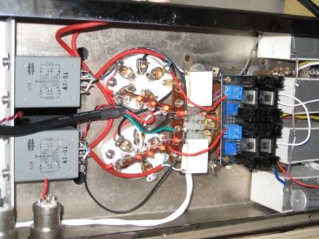

Hi all, here is my 27 not 26 🙂
this is my olderly project when I was crazy for tube 😉
Umm...Parafeed config(cascode DN2540) with tamradio(tamura) 10K : 600 & 1.33uf*2, LED cathode for biasing.
power : 270V*2, 80 retifier, LCRCRCRC, and about 25V inject to the filament to elminate AC filament noise. :headshot:
Good sounding, still love it much😀
Cheers.:spin:

Very nice! Did you ever try battery grid bias? (I suppose 9V would work fine.)
Nice 27 fingerx! 😀
A tube veteran indeed! :spin:
Your Symmetry DCB1 on the Pass thread is something I will long for next, say perhaps as a buffer to the RC coupled 26 version. (Together with Lightspeed too, you bet 😉
Yes, I am getting a pair of 20k:600 this week for the transformer loaded settings.
Will order some IXYSs too for putting together that Gary Pimms-like circuit as well. That could be a flexible platform to also play around with 01A and PTT2s, PTTx, etc.... at the mu follower or high Z outputs....
Many options to have fun :spin:

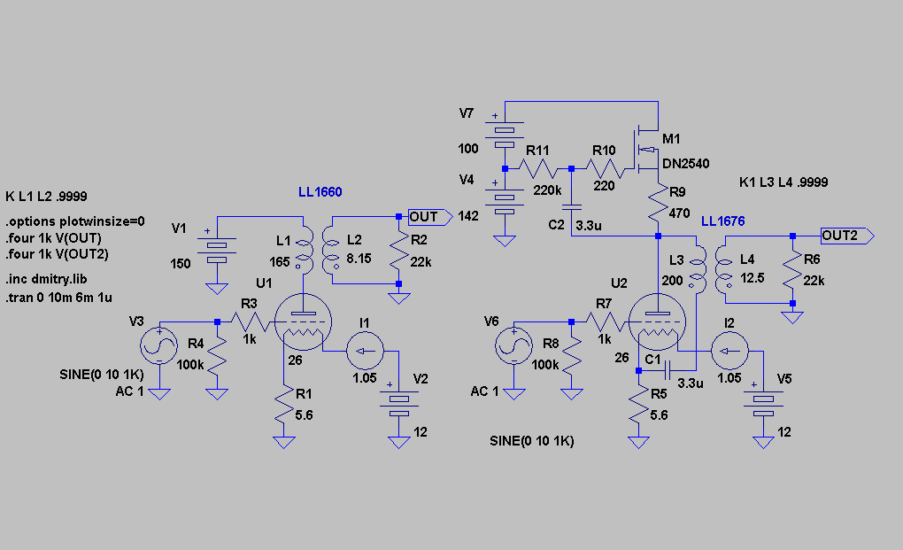

As I now plan a 26 pre with LL1660/10mA/4,5:1 I did a working simmodel of it. Ug ca -6V and Ia ca 8mA. Dmitrys 26-model follows the published curves perfect.
This one shows a gain of 5dB with a Zout of ca 500ohm. Due to the unbypassed 5.6ohm with 6VDC over it, this one takes well over 10V in before clipping. -3dB is well below 10Hz and 20Hz will be -0,6dB. 165H is a little on the low side and will cause some phase shift in the low end(ca 10degrees at 50Hz).
The simmed fourier-analysis shows extremely low distortion but shouldn´t be taken to seriously.
Would be fun to see an IRL analysis.
The right one is an idea of a prafeed with a voltagecontrolled gyrator instead of inductor/CCS. By playing with the two capacitors it can be made to have a very low Fc.

The right one is an idea of a prafeed with a voltage controlled gyrator instead of inductor/CCS. By playing with the two capacitors it can be made to have a very low Fc.
I use a very similar approach based on voltage controlled gyrators to load the amplifier stages in my latest phono stage. All tube based though with 5687s used in the gyrator circuits. It works pretty well, not constant current of course, but there are instances where having entirely predictable plate voltages is a benefit - from an ac perspective it is possible to synthesize fairly high load resistances without the voltage drop associated with a real resistor. (I'm not actually simulating an inductor with this thing, but that is obviously possible.) In my phono stage in order to use a comparable resistive load I would have to have a >1kV supply versus the 240V supply I actually use.
