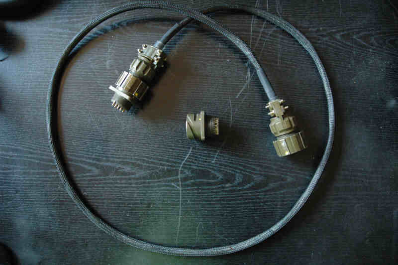

Umbilical

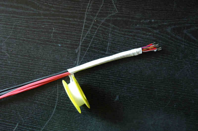

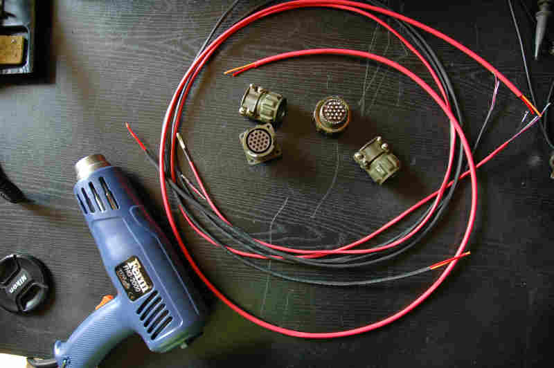

Some (8) years ago I made this umbilical, which is working even today -when this preamp working- between #26 preamp and his PSU box.
Lightly twisted silver plated teflon wires, each pair heatshrinked, then the all wrapped with teflon tape. Military (soviet) connectors.

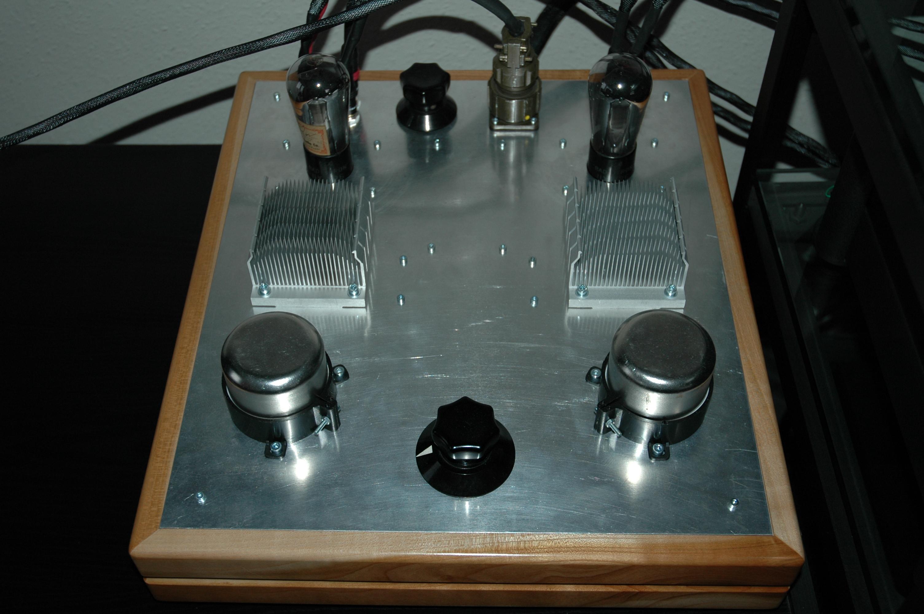

...Ale's source follower at the bottom right...
Hi Ra7,
Just curious, why are you using a source follower at the output of your preamp?
What will you be driving?
