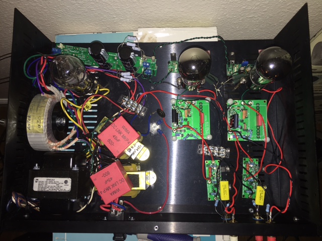

Attached is a pic of my build. This is my first tube project and so I wanted it to be in a form that is easy to troubleshoot. PS is to the left and main circuit to the right--both in the same chassis. I'm not getting any hum at all.
Thanks to Rod and Ale for the boards and circuit design. Thanks to Amandarae for the B+ PS design, I just copied his. Thanks for everyone else for the support on this thread. What an amazing community we have here! Long live diyaudio.
The sound is very clean. Top and bottom end are fully there. I tried bypassing the source follower, but the top end falls off a cliff, i.e., sounds muffled. I didn't put it on the test bench for measurements, but suffice to say that the follower is needed. Unless, the output cap is too small. It is 220nF with a 680k resistor to ground. This is the circuit I'm using:
https://i1.wp.com/www.bartola.co.uk/valves/wp-content/uploads/2016/11/26-Preamp-Gen3.png
Driving the F4, it gets plenty loud, so there is enough gain. It sounds very clean and very good, but I was expecting more. I cannot adjust the anode voltage above 140 V using the gyrator board pot. I'm going to send Ale an email to see if there might be problem with that. Also, the shoulder type 26 tubes sounded very ordinary. The globe types are a massive improvement.

In post #5031, I complained that I was expecting more. Boy, is there more!
After fixing the CCS setting resistor in Ale's circuit, the anode voltage could be adjusted to 160 V and what a difference 20 volts can make. This is the best sound I have ever had in my system. There is absolutely no hardness at all. It is liquidy, creamy, smooth. The soundstage is wide and deep with individual instruments clearly separated and the tone is just amazing. Extremely happy now! This is what I was expecting and am really happy.
Would be great to know the filament current and anode voltages the rest of you happy builders are using.
