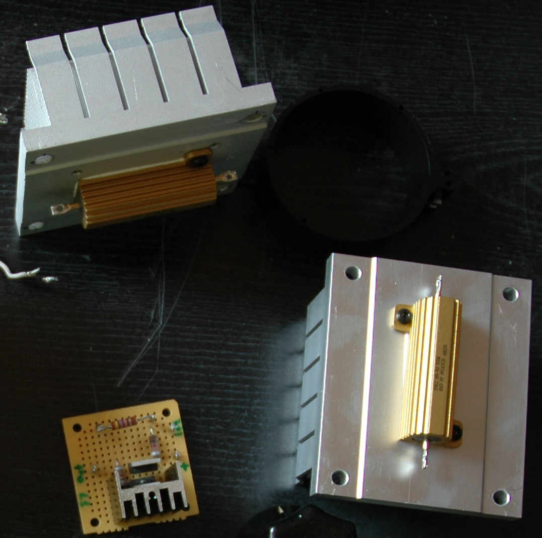

Thanks Rod! I was at 1.22 V with about 850 mA. At about 1 amp with 1.5 V. I have two parallel 20 ohm, 10 W Welwyn resistors. They are really cooking. I think I need to get more. Maybe some 30 and 40 ohms to parallel more.
Try non inductive resistor as filament bias resistor.
I used Vishay-Dale 10R 25W NH type resistors with heatsink.

Yup, I'm going to get those based on your recommendation a few posts earlier. I have some 0.412 ohm 50 W Dale resistors, mainly for Pass amps. Didn't have a 10R value on hand, so will have to order. Until then, the Welwyn ones will have to cook. I don't see any browning or signs of smoke yet, but can't leave the thing ON without observation.
