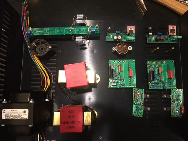

Please comment on my layout. See image. I am going for a single chassis build. Let's see if I get hum and noise. Might put a divider to make it basically two chassis.
PS is to the left. Main circuit to the right. DC heaters at the top, Ale's source follower at the bottom right.
DC heating toroid is on its way. Planned to go between the main trafo and the rectifier tube.

Are you going to use filament bias, which many of us find the best? If so you might seriously think of using an outboard filament supply, where you can use chokes if you want to optimise everything. And at least EI transformers and not a toroid. Simple to use a 4 pole XLR as a connector. That will keep a lot of possible noise problems out of the chassis.
