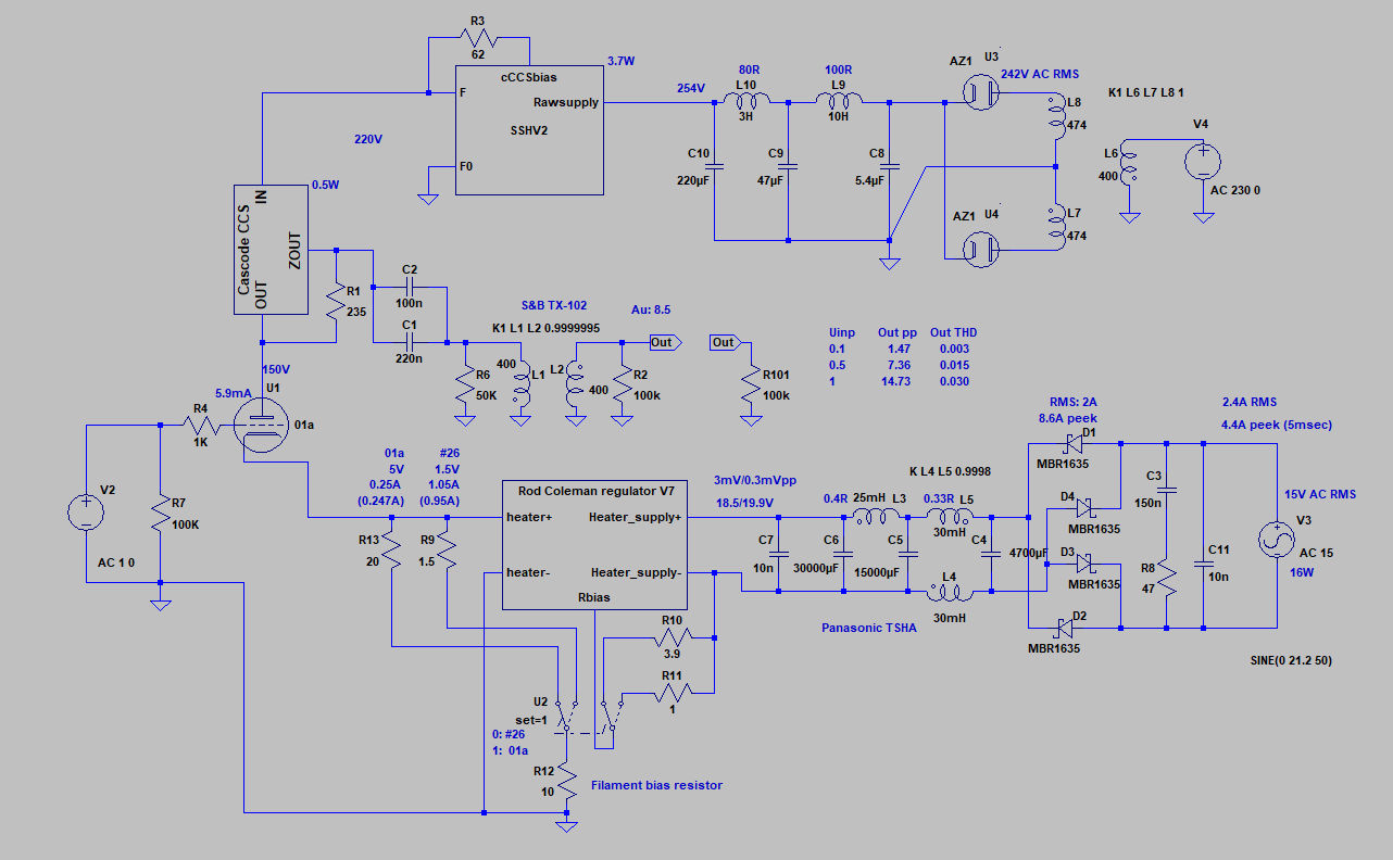

I'm thinking about a CLC supply with motor run caps. I'm calculating 160 V AC secondaries for the transformer to get about 200 V B+ for experimenting. Rod recommended at least 30 VA. Could someone make a recommendation for sourcing an appropriate transformer?

Hi!
Will this help?
Transformer is a Hammond 370CAX and L3 is 320mH (Triad C40X).
Real application gets me 198 Vdc out to shunt regulator.
Thanks euro21!
160 vac secondary to a cap input gives you an open circuit voltage of 224 vdc...
to find your traffo you need to know the final voltage and load current, say 200 volts at 25mA....so then you can determine these voltage drops on any chokes you are using.....
