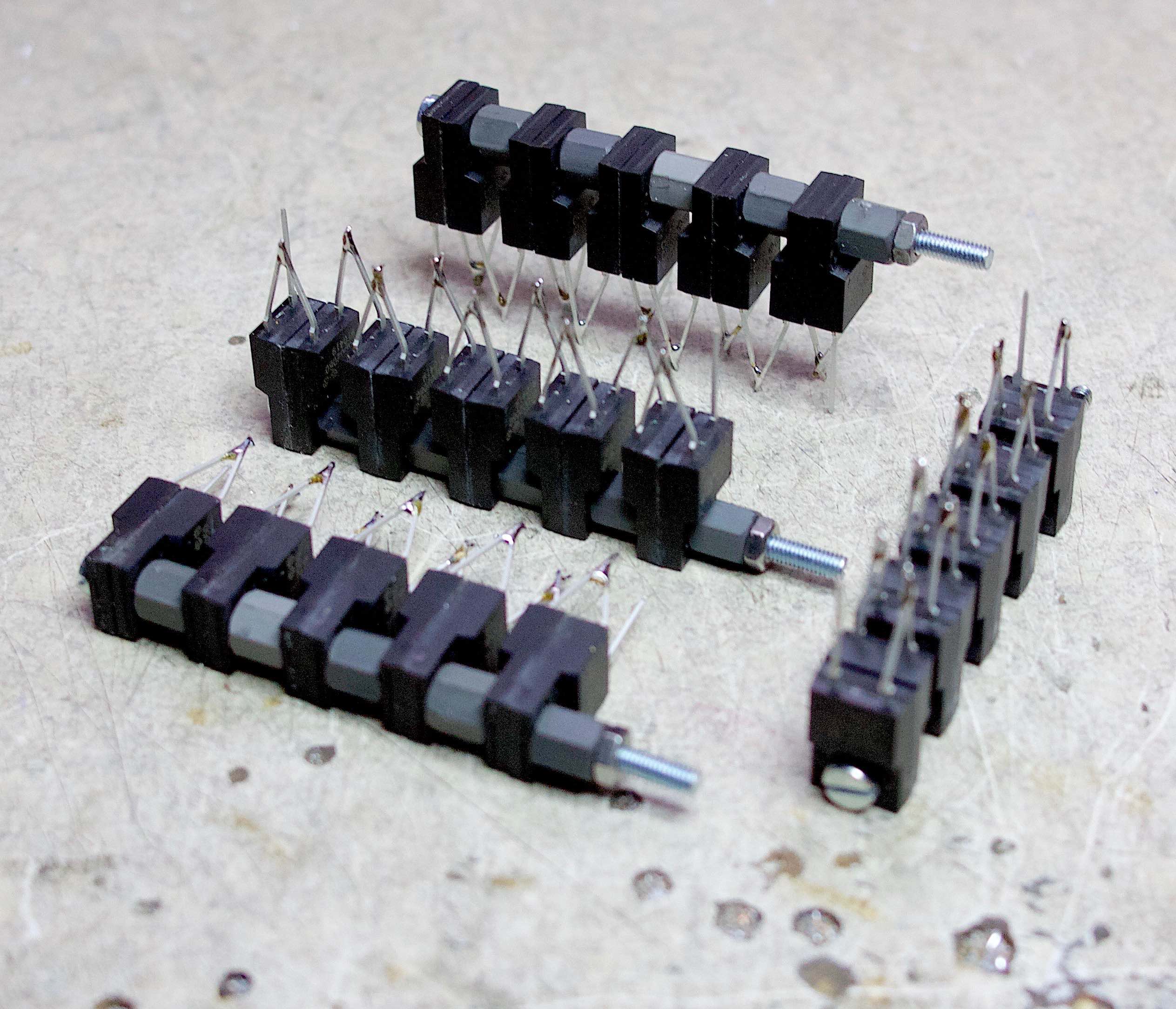

Here's one way to keep the SIC diodes close together...
Hi Rod and Andy,
Thanks for answer.Yes I to have think about this problem and yeasterday I have puth than the diodes together without the testing board,so diode on diode with body like andy in the picture but without screws I have bolt diode on diode with fast glue and the problem is the same this 120hz hum.I even made the contact verry smal diode string to tube socket and diode string to ground conection is made direct with diode pins.I have now buy Miles wirewound resistor to make today the filament bias option,so lets se how this will turn out.But I will tray than the sic diode in filament bias also.Thanks guys for help.👍

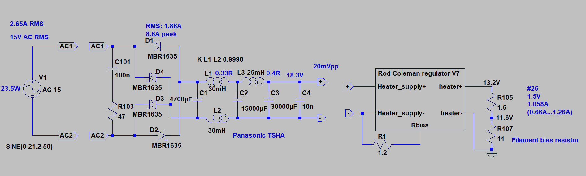

what is the R105 there
This is the #26 filament.
Filament and filament bias resistor are serial, and R.C regulator current flow through both.
The voltage on the filament bias resistor (at 1.058A) 11.6V, and at the "output" of R.C. reg 13.2V. The difference is the filament voltage. If you decrease R.C. reg current (with trimpot), decreasing the bias and the filament voltage too.
In my practice the R.C. regulator "headroom" at least 5V.
Hi Rod and euro21,
Thanks bout for answer.Yes I will go with 11ohm bias resistor becose I will go for first with starving filament 0.800A and for 11ohm this is caa.9V of bias.So I will set the output voltage on Rods reg for 10.3V like I say 9V for bias and 1.3 for filament.And if this will sound good,I will try than not starving the filament and will go for 1.05A for filament.I must listen to see if I can hear some diference.
Hi Rod,
......oh yes,so I read this in Ale Moglias preamps design of starving filament.So If I will have no microphony I will go with normal 1.05 A filament.For now I will use 11 ohm bias resistor becouse I buy for each chanel 3 x 33 ohm Mils 12watt wirewound and I will put this in paralel.So for this bias resistor than I will set the reg out to 13.2V like euro21 sugested and raw supply to about 18V.Hope this works.I will now for first time using filament bias becose till today I only used normal battery grid bias with 26 tube,01a tube and other.Thanks guys for help.
