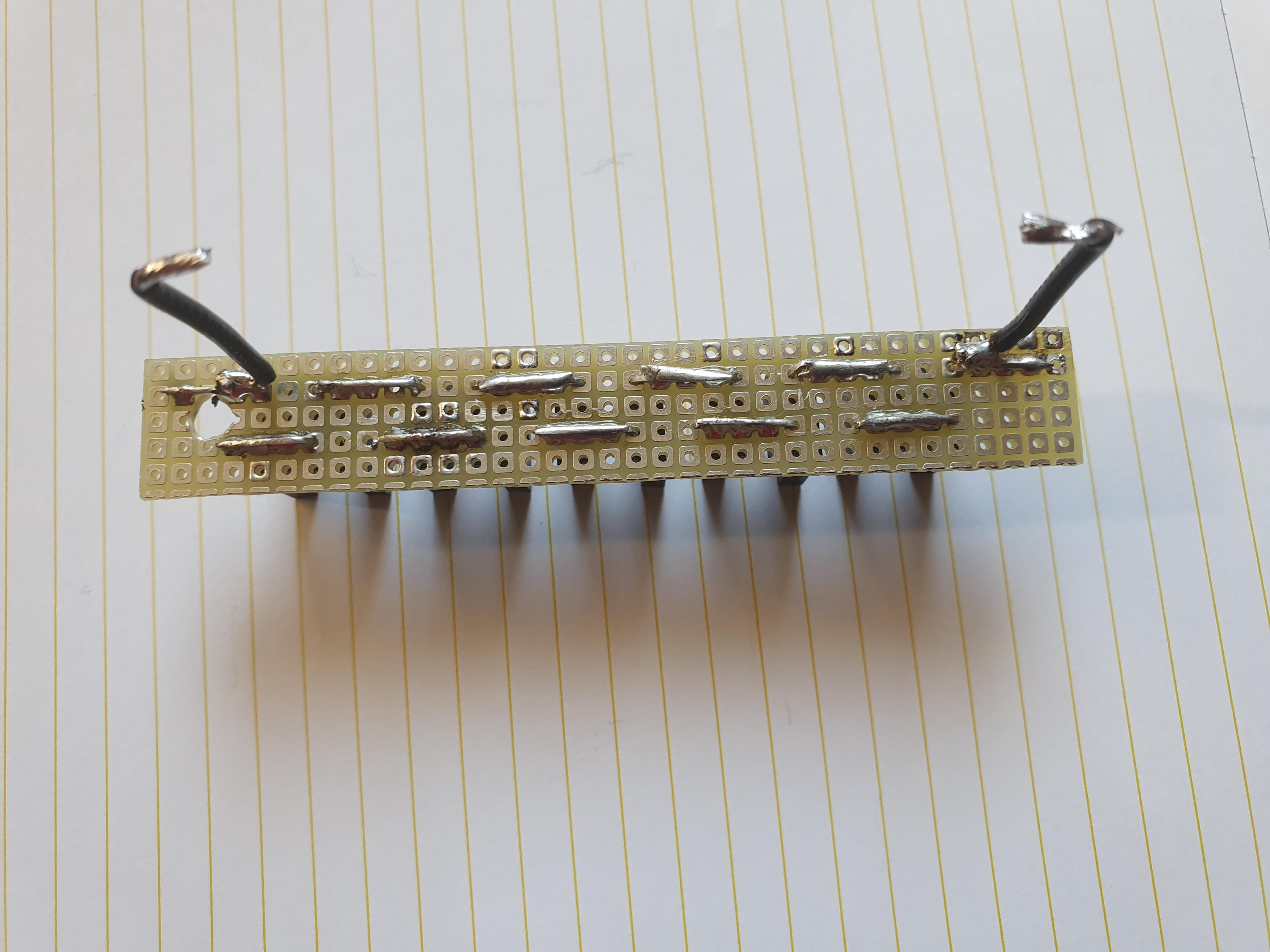

Hi Rod,must try the cap across I just now again rewired to battery grid bias and the pre totaly silence without hum or hiss.I have put the 10 diodes on some testing boards 10 pieces in series.I like the sound with diodes verry much,only the 120hz hum is the problem.I can hear this hum about 3meter from my speakers thats what is the problem.

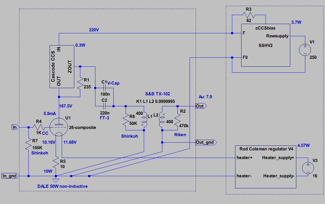

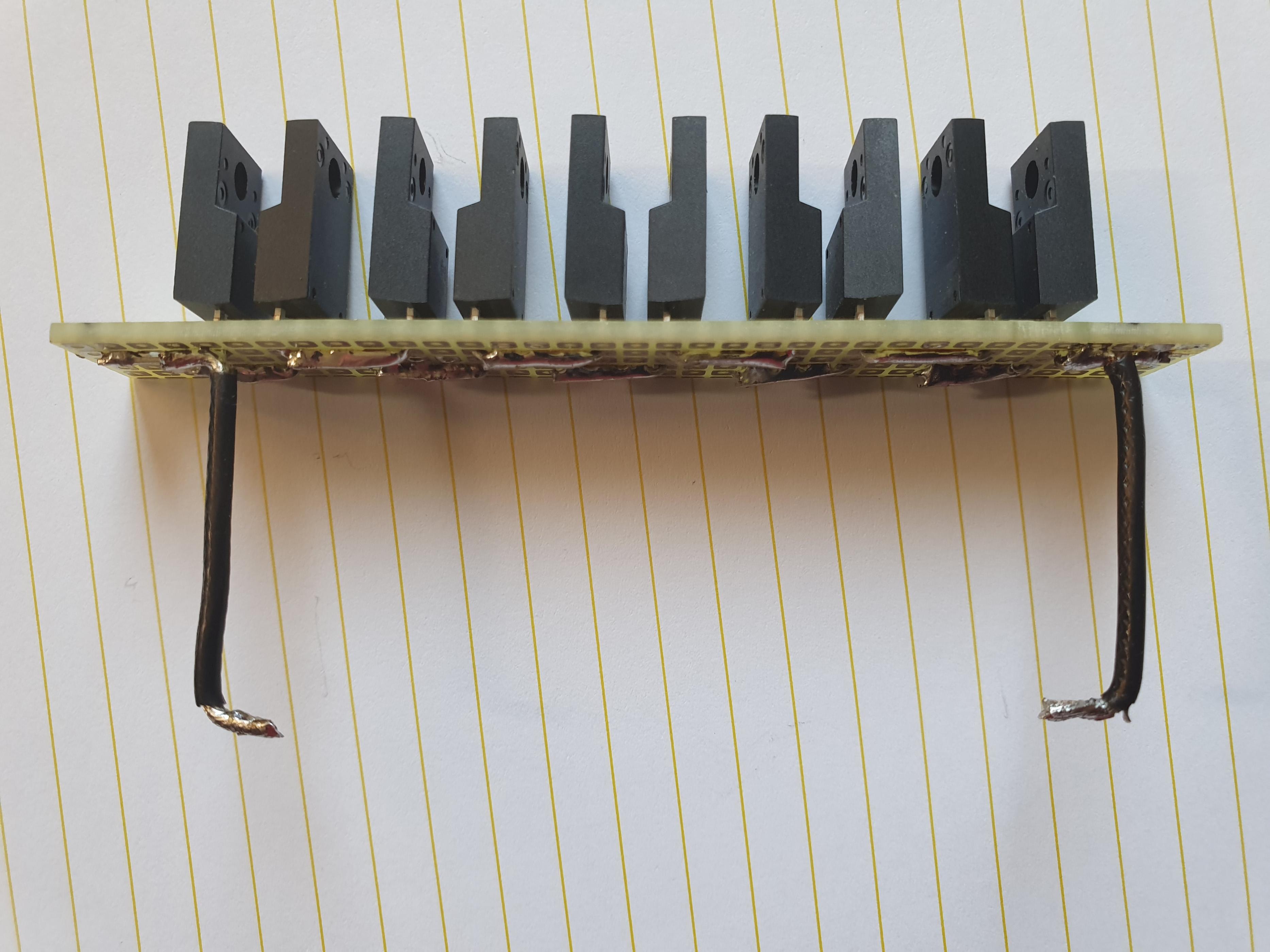

Can you take some pictures of your layout and attach a diagram?
Ale
Hi Ale,thanks for answering.yes like I say this is new to me also,becose I have used the Sic in the past and there was no problem ewen with 10 of diodes.Your boards works superb and the sound is truly good only the hum with diodes is strange.
Hi Ale,like I say before this pre was made with your gyrators on anode and Rods regs for filament,for some time now Iv used battery bias on grid and the Rod reg was used for heating filament and negative side of this was conected directly to signal ground.This worked fine from first moment on.Than I have idea to tray Sic for bias and so the problem was this hum.I will try to put some capacitor across diodes to see if it will be better.

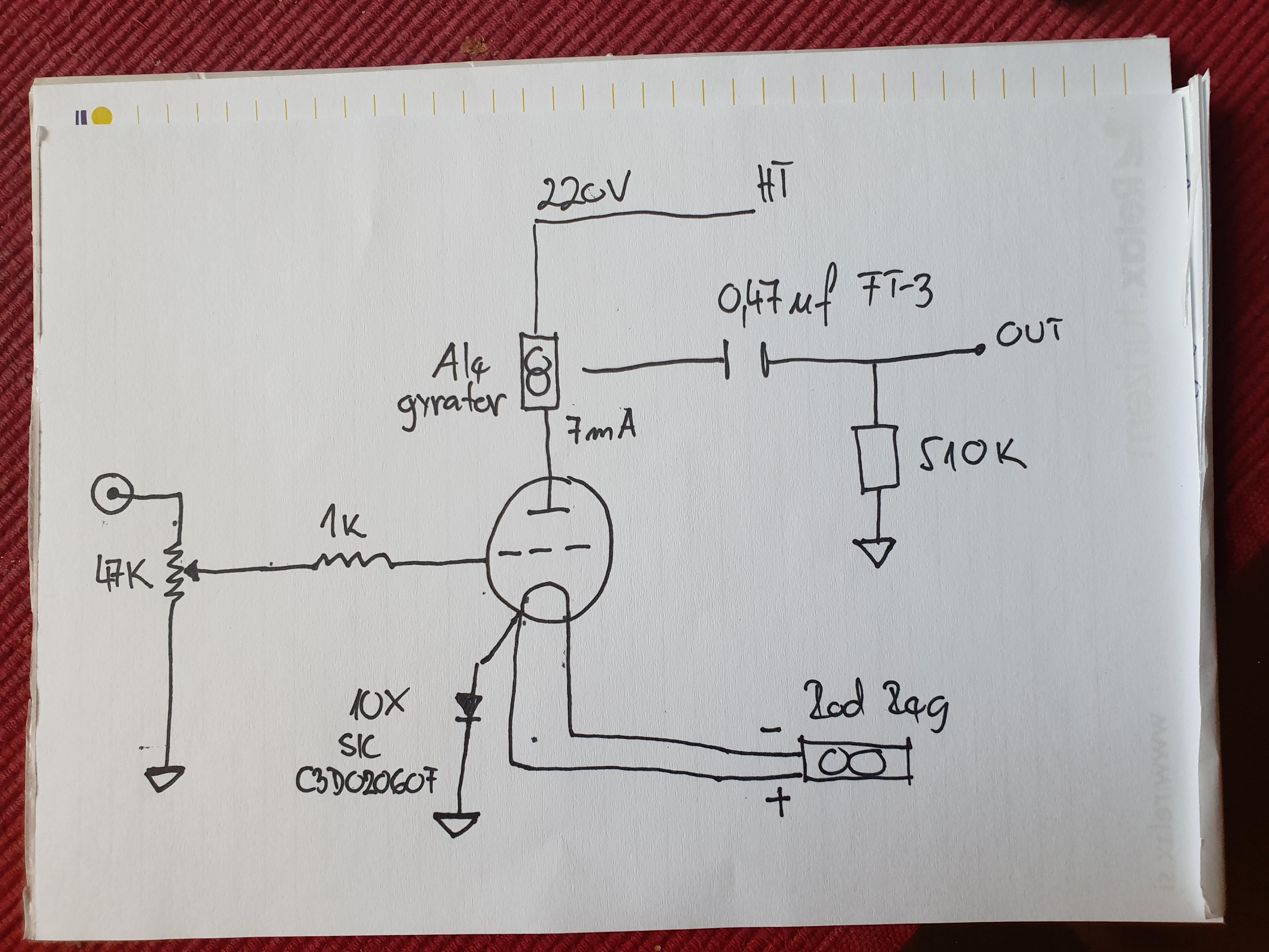

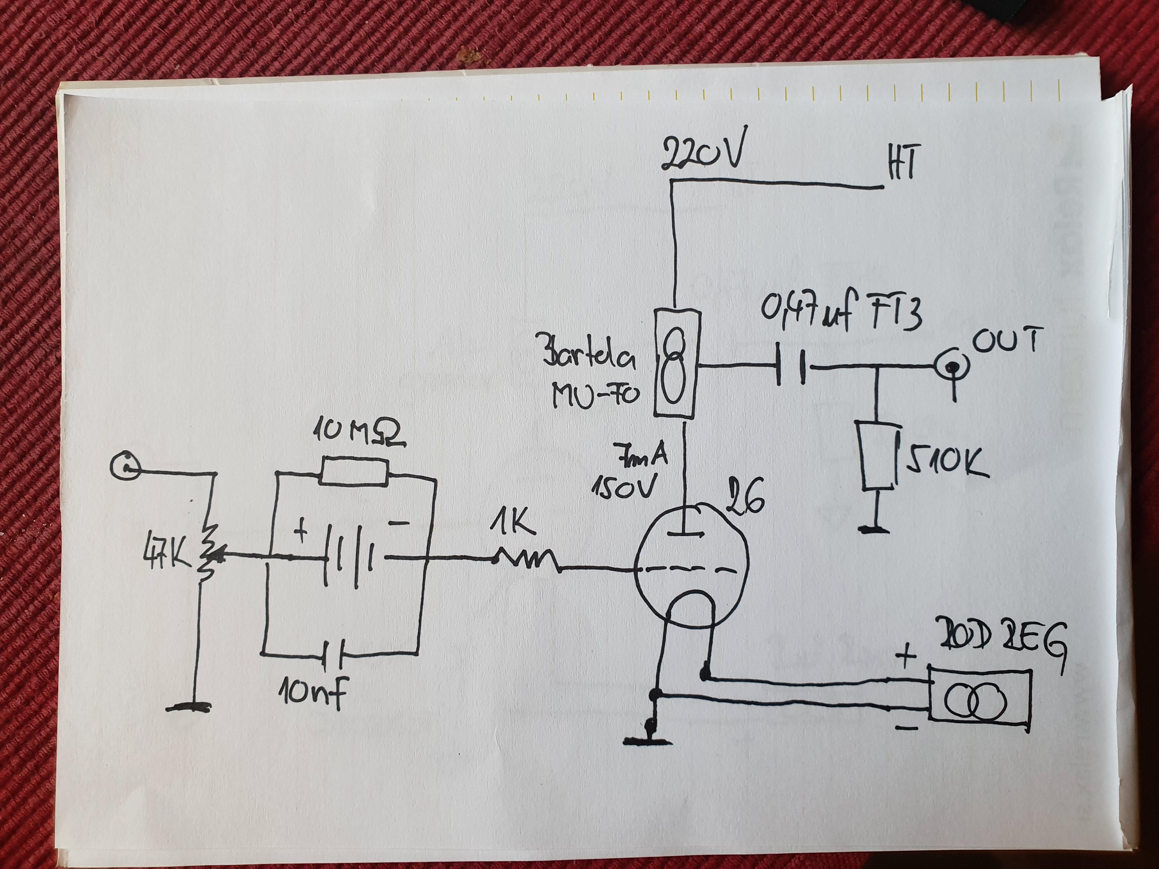

So Rod and Ale,first schematic is with no hum and hiss,second with Sic diodes with hum 120hz but no hiss.I must buy some good resistor that can handle some wattage and I will try filament bias in the future also.But for now I would try this Sic option.Ale plese be so nice and tell me how you made grounding in your oreamps.You mentioned some 3 point grounds like input stage,filament return and output stage.To have this 3 points separate that hum is not come in the output stage from filament how you make this ground scheme??
