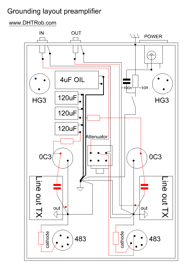

Hi euro21,
Yes I have RCA input,so input hot wire from rca to input o the pot and cold wire from the rca to pot ground and than from pot ground to signal ground,pot output to 1 Kohm gridstopper.On signal ground I have conected the input ground from pot,output ground for rca,Sic diode string and last psu capacitor and than from this signal ground goes wire to star ground this is for one chanel but bouth have the same wiring.

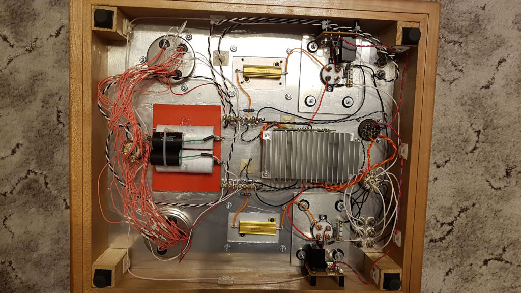

As you can see my #26 preamp also has wood frame.
Each input RCA hot and cold switched by input selector, then go to #26 (to grid leak resistor neutral -local ground- point and to the grid stopper).
From #26 local ground point black wire go to global ground "bus".
This is the common point of heater bias resistor, R. C regulator, TVC input, TVC output and output RCA, HT neutral point.
Each channel is independent, no common ground (only at the PSU box -via umbilical-).

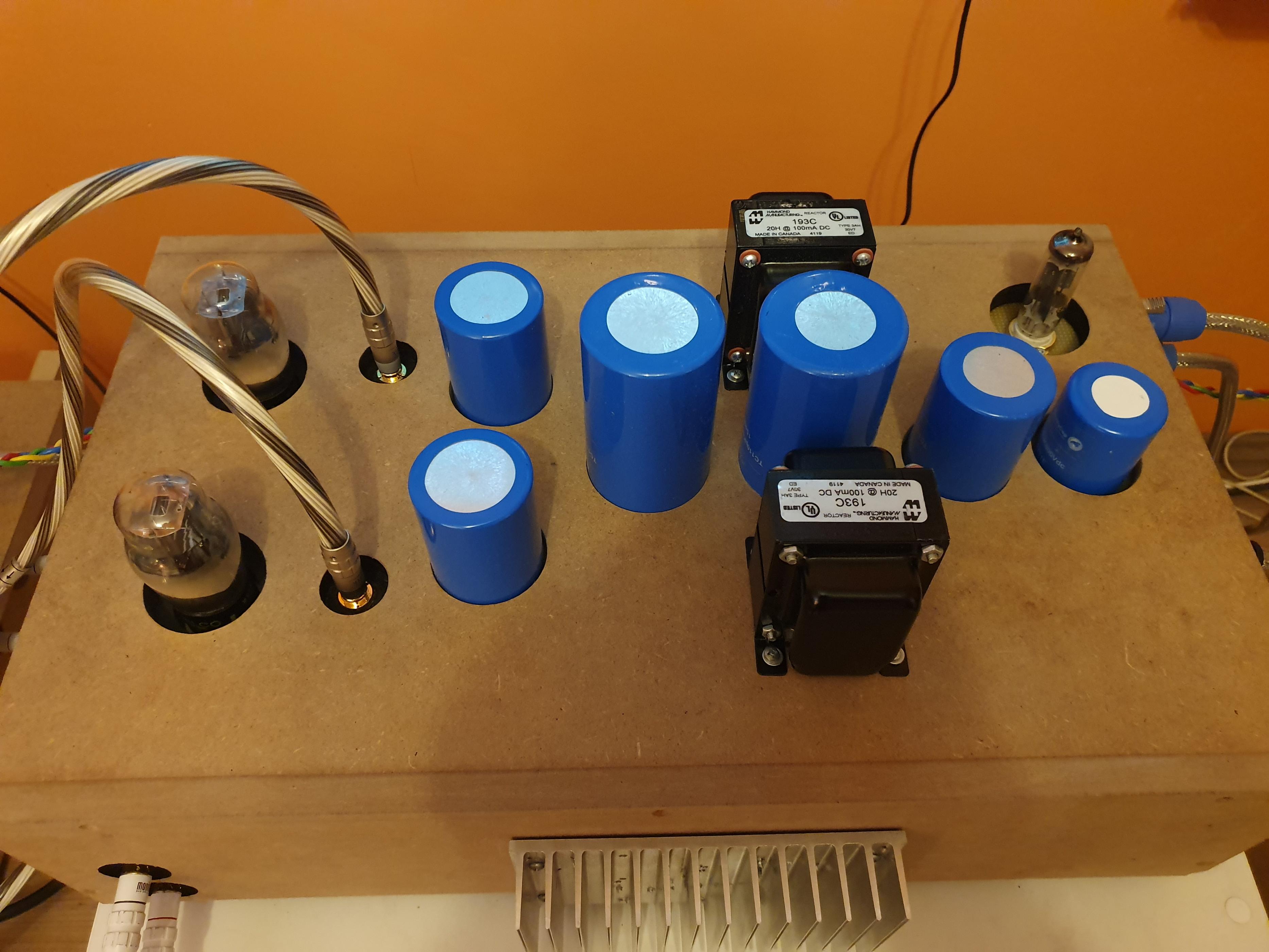

This is my prototyp 26 pre for now.now I have my gyrator inside made point to point on bartola schematic,i have made this pre in two box option,first box that you see is preamp box with filter caps,chokes and coleman regs,in second box I have only two transformer and first stage raw psu from Rod Coleman.The star point is in preamp enclosure.I must say I choose this option becouse with battery grid bias I have no hum and no hiss.
Two independent raw supplies, with independent AC coils?and first stage raw psu from Rod Coleman.

Yes i have two pairs of coleman raw psu but the first is in transformer box with transformer 6V-0 and 6V-0 so two secondary this goes into raw supply left chanel and right chanel than when it comes thru shilded 1,5meter cable into the preamp box there is another pcb raw bord one for R and one for L chanel but build only with capacitors/resistor and led diode so without the rectiefer,this is only there for second filter stage.I have this at home so I used this.

Ale plese be so nice and tell me how you made grounding in your oreamps.You mentioned some 3 point grounds like input stage,filament return and output stage.To have this 3 points separate that hum is not come in the output stage from filament how you make this ground scheme??
Hi Ale,
I would be interested in seeing your grounding scheme expanded on, as well.
I have tried a number of different grounding schemes, including 3 separate star points as suggested on your blog.
So far the schemes that gave me the lowest noise are strict star grounding (with everything getting its own flying lead to ground) and a ground bus, paying attention to where the grounds attach-- filament and PS on one end, and signal on the other, in order of sensitivity.

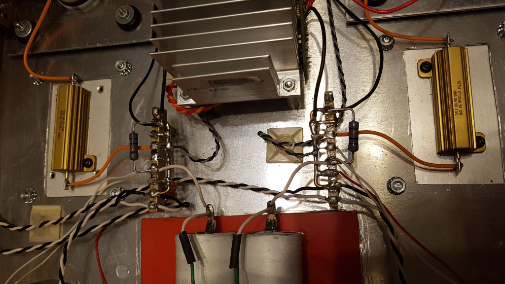

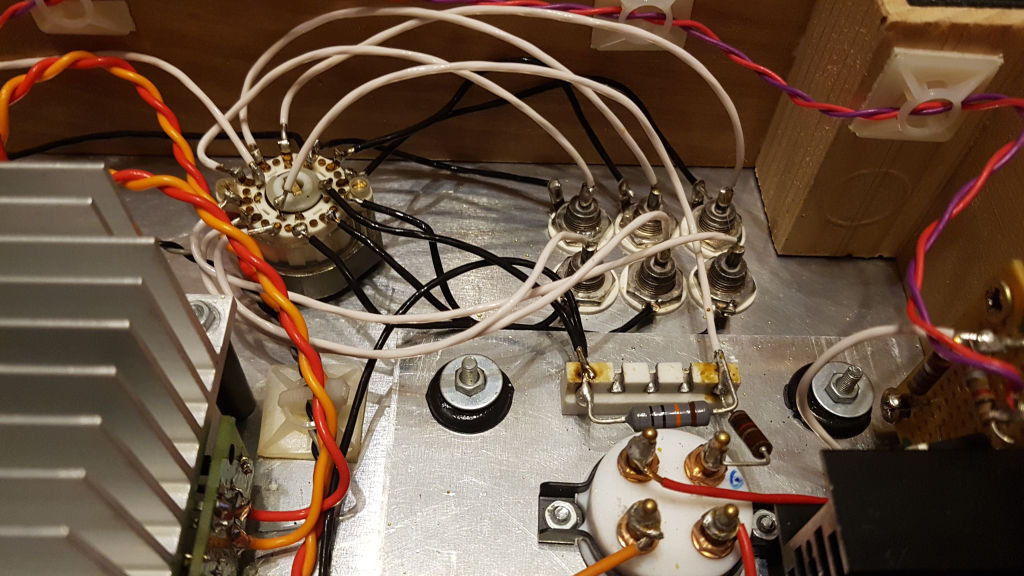

If the capacitor across the diodes stops the hum, then I think it is electromagnetic pickup. And since the diodes are quite low impedance, it is probably magnetic field.
Components in the cathode carry the grid signal-current, as well as the cathode current. for this reason, the conductor area between:
- grid signal→socket→cathode components→ground→grid-Leak-Resistor→Grid signal input
- must be made as small as possible, or pickup will become real.
The diodes must be stacked closely together, and connecting wires must be formed to make a short loop. The grid leak resistor must be connected to this same ground-point.
Do you have a photo of the diode-string construction?
