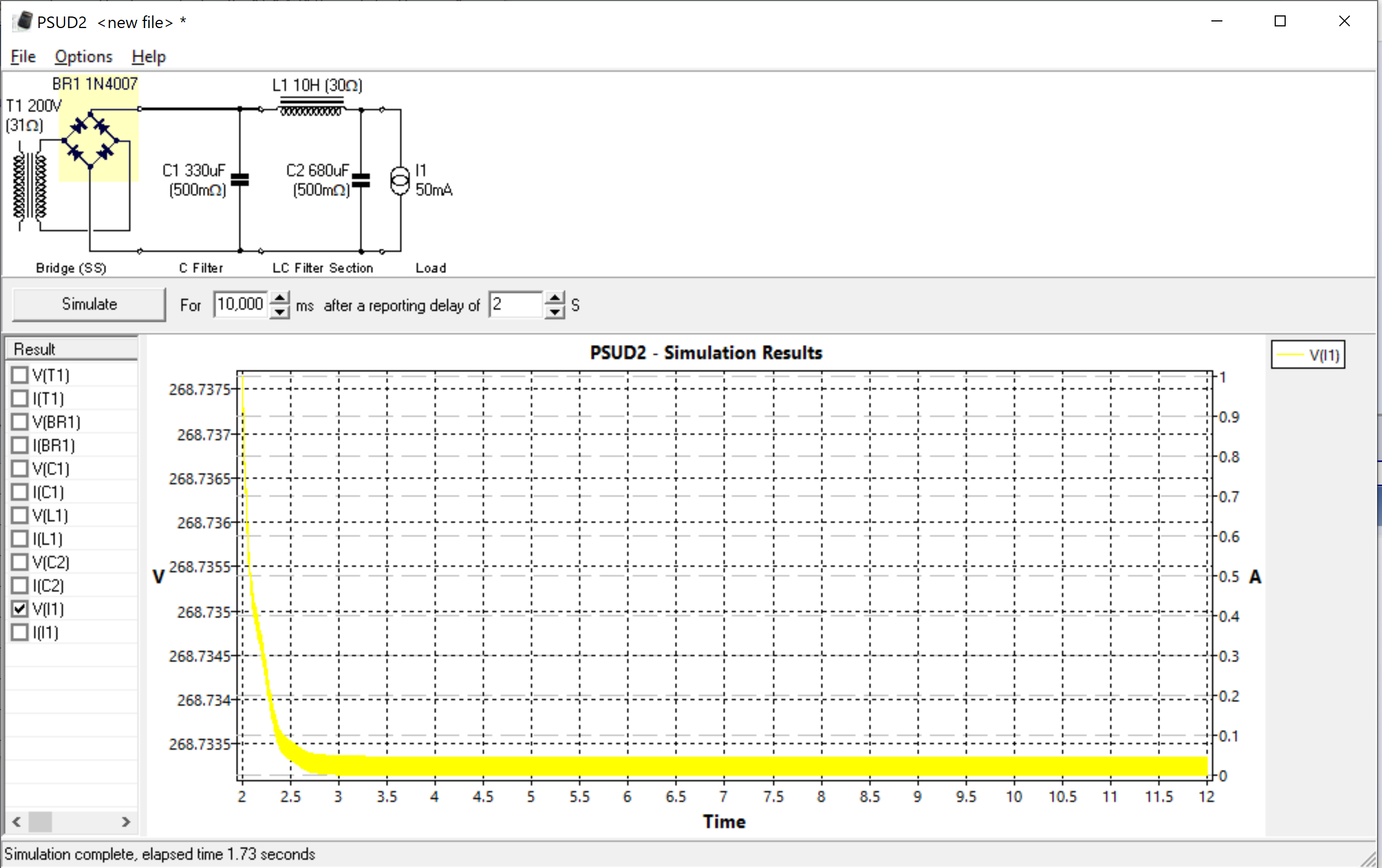

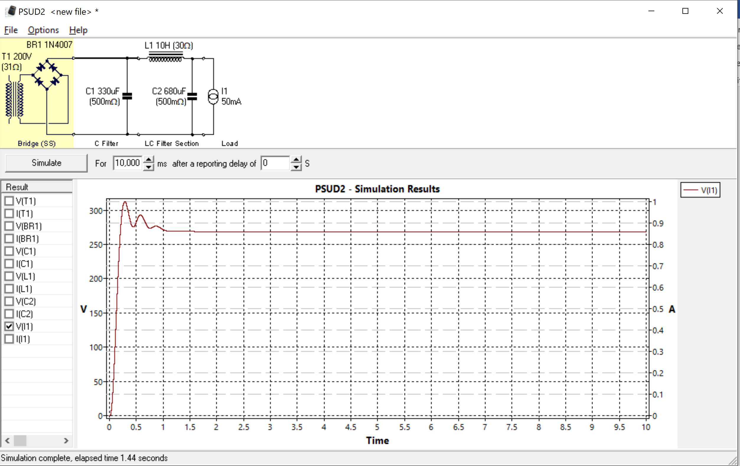

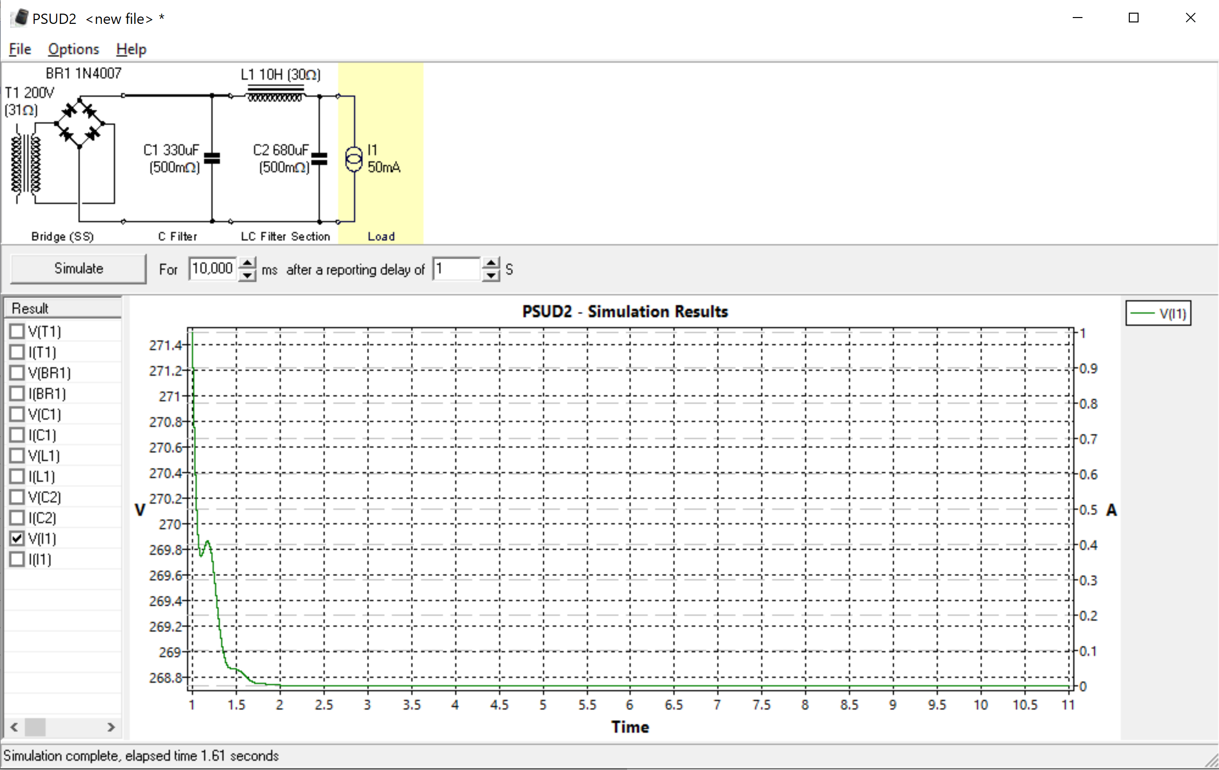

Possibly, but I have no experience in using a bridge and CLC in my builds. With regards to multiple chokes, simulate your power supply using PSUD and you will see the effect of the chokes with ripple.

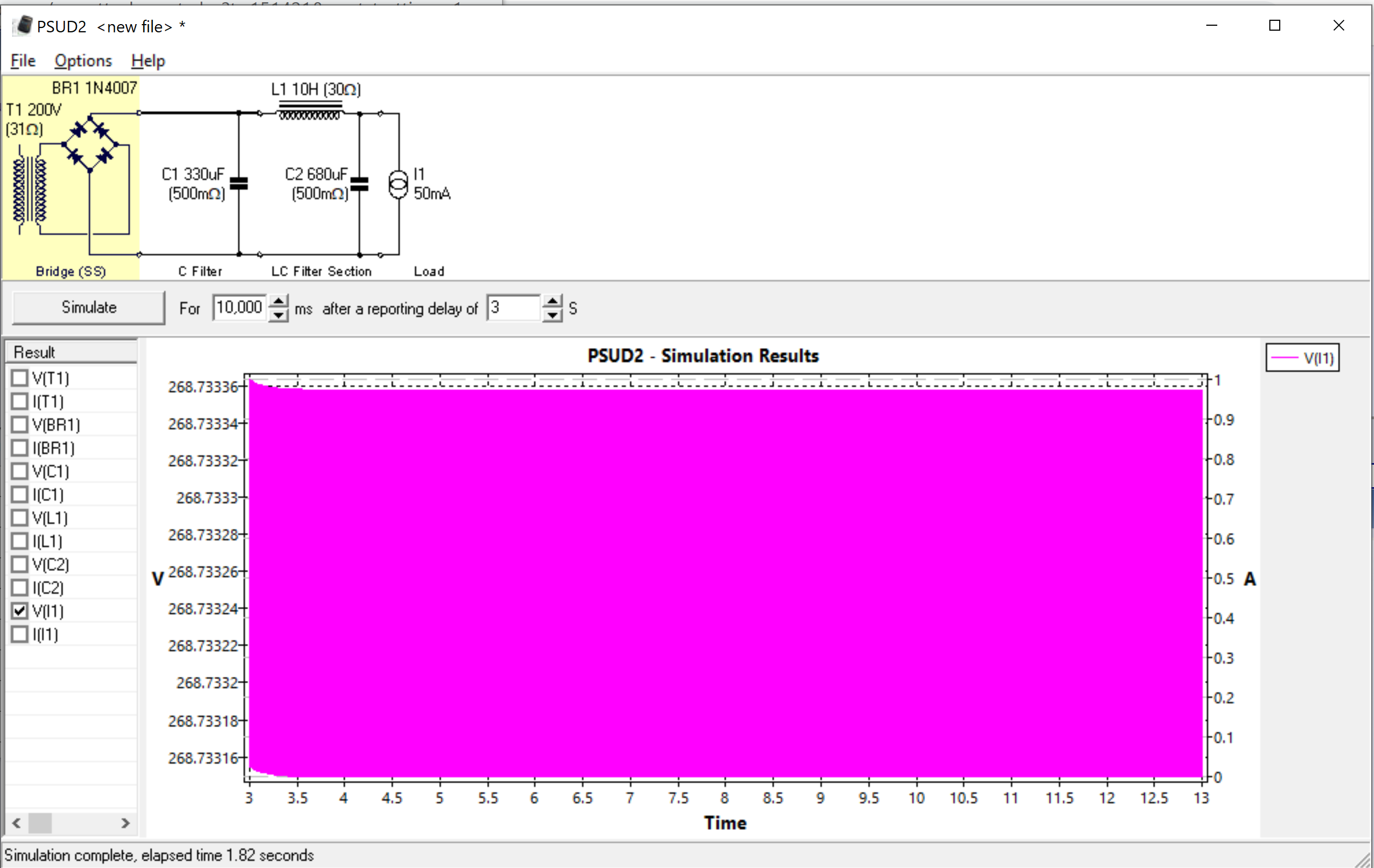

Thanks about the PSUD2 tip. Teach a man to fish...
Here is a simple CLC supply. I have spent exactly 30 mins on PSUD2. I need to find out how to calculate the noise value based on ripple voltage. Also, this beer is hitting me hard 🙂

chokes store current, capacitors store voltage, so they complement each other.....
ripple voltage is directly proportional to load current and inversely to capacitance in your psu...and a choke lets you use small caps in your psu than if there are no chokes....
