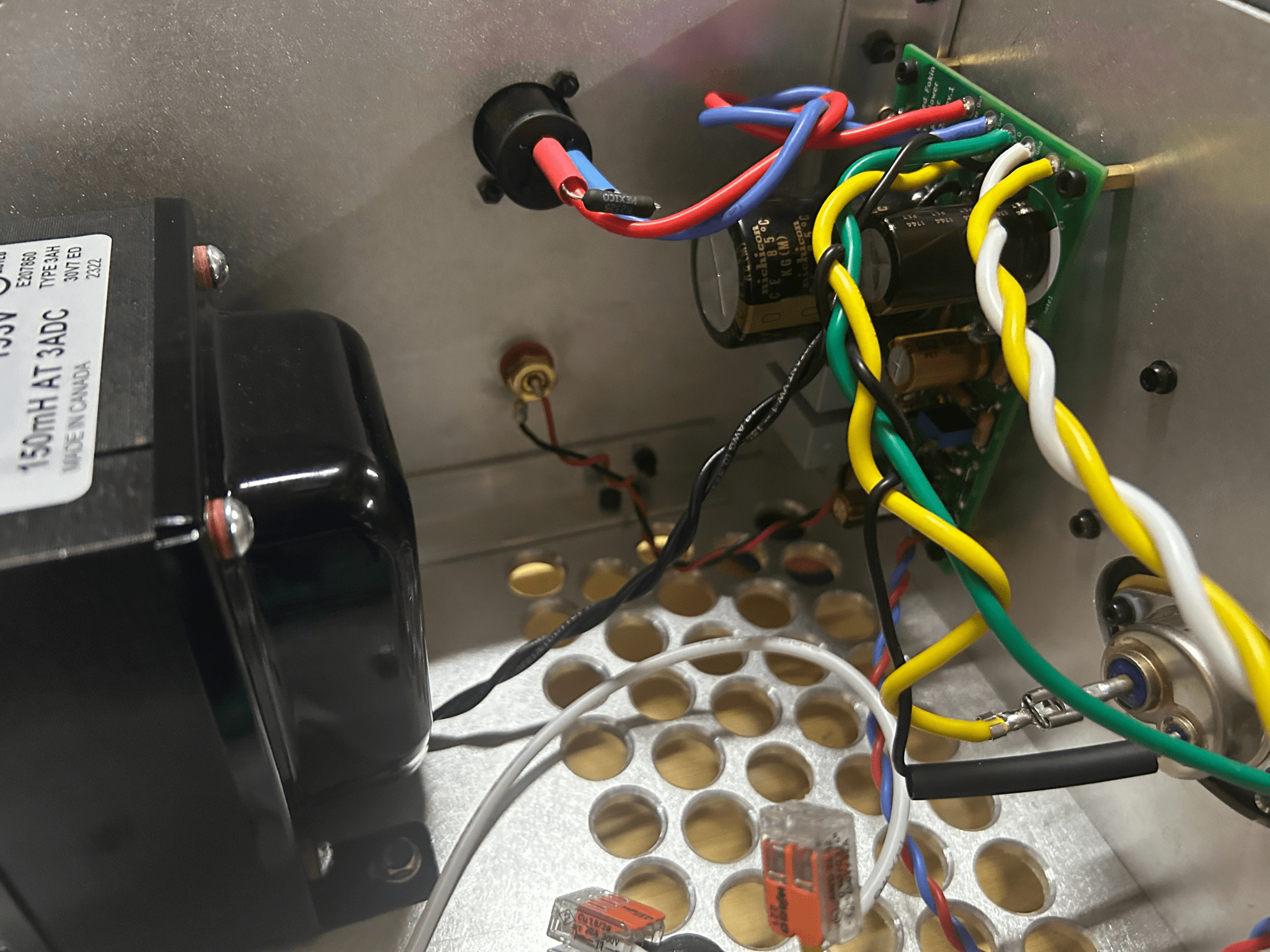

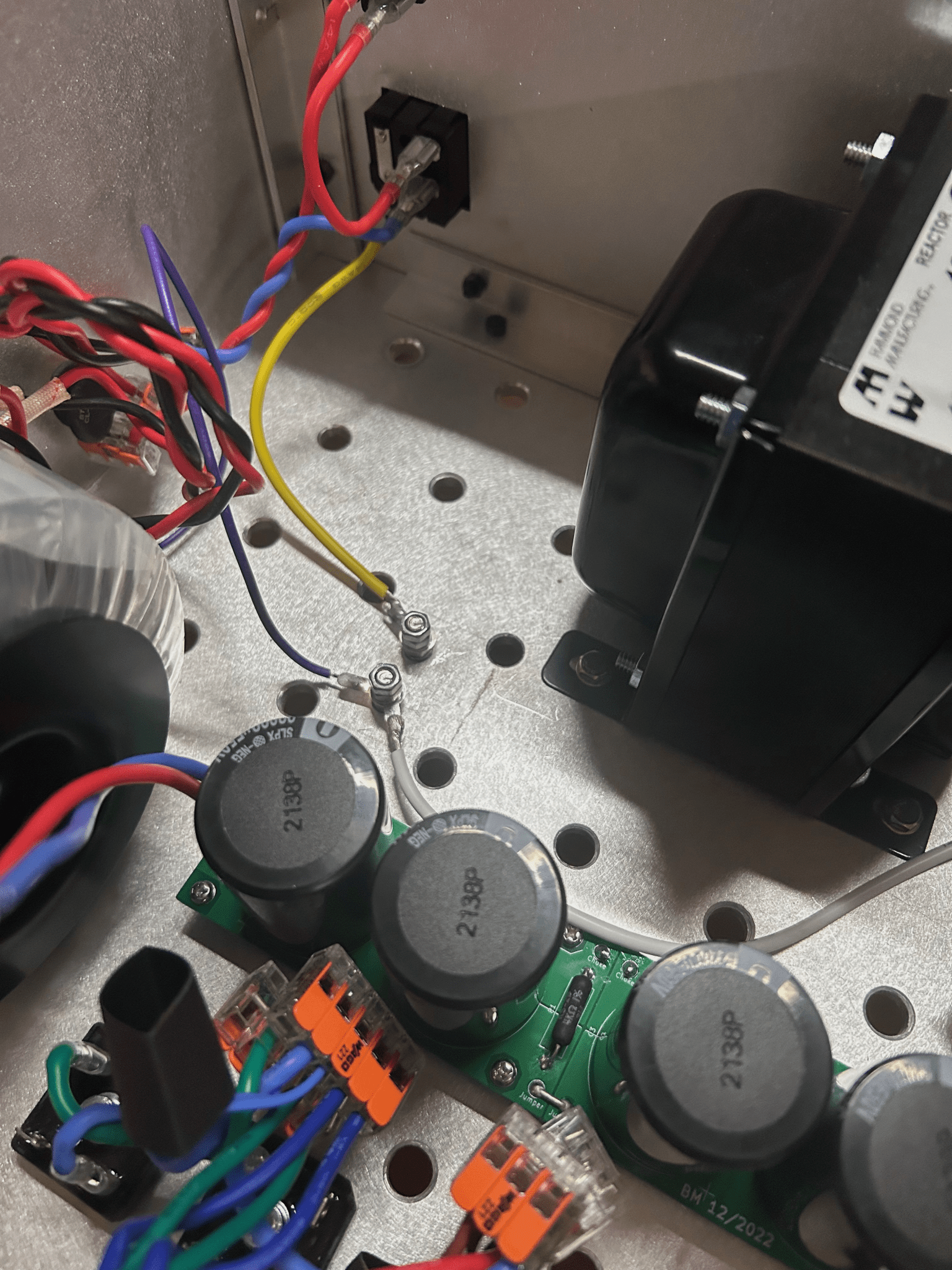

I have also implemented the grounding as advised. Below are some pictures. I'm busy the next couple of days, but hopefully I get around on Sunday to start testing the amp by powering it stage by stage up.
@Ben Mah the amplifier works🎉 A couple of notes for the power up:
I'll now assemble the second amplifier (left channel) and I'll have them ready to demonstrate at the Burning Amp 2024.
Thank you very much again @Ben Mah! I'll keep posting pictures and comments with my progress and impressions.

Hi Adrian,
It's great that you got it up and running successfully on the first power-up!
65 degrees C is a bit hot. What size is your heatsink and how did you measure the temperature?
My amps have the Modushop 300mm x 210mm x 40mm heat sinks and at 2.5A, they are only moderately hot - much less than 55 degrees C. I have run them at 3.0A and they did not get to 55 degrees. They didn't even get to Blimey hot.

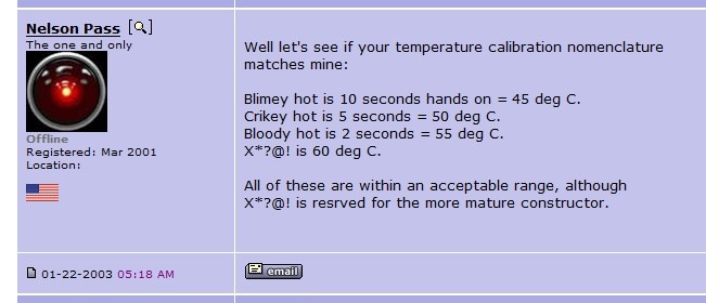

How long can you keep your hand on the heat sink? Do you have a contact thermometer? I use a cooking thermometer to measure heat sink temperature.

IR temp guns do not give accurate readings pointed at shiny metal. Aim at the heatsink that is outside of the chassis and is anodized black. The inside is plain ‘shiny’ aluminum.
Or, as Ben suggested, use a contact thermometer or probe for your DMM.

Heat sink temperature: how hot is it to touch? How long can you keep your hand or finger on it?

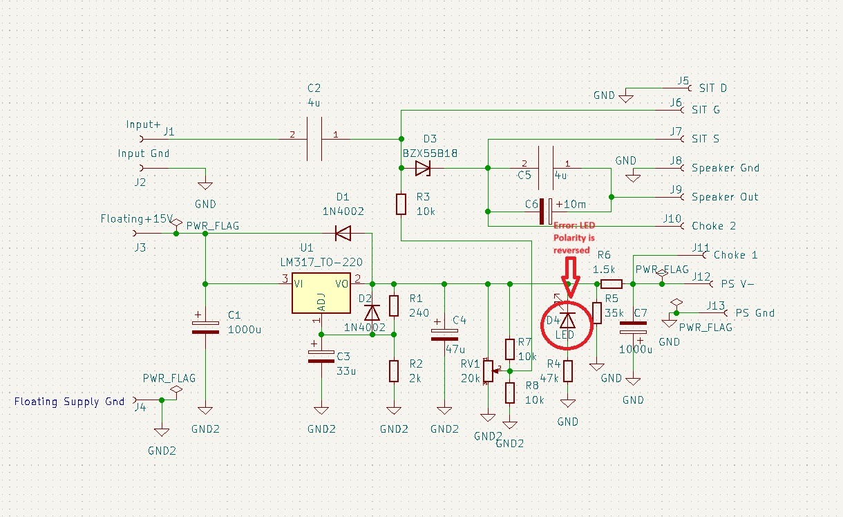

I just looked at the Kicad schematic for the amplifier pcb and it looks like I put the LED symbol in backwards. So if it is the LED in the bias supply on the amplifier pcb board that is not lighting up, it is my fault for the reversed LED. I didn't catch the mistake because when I install LEDs in a board, I make sure that the anode (long lead) is at the positive side of the circuit.
After looking at the circuit some more and trying to remember the design, I think that the pcb is correct and there is no error in the LED polarity. So ignore post #973.

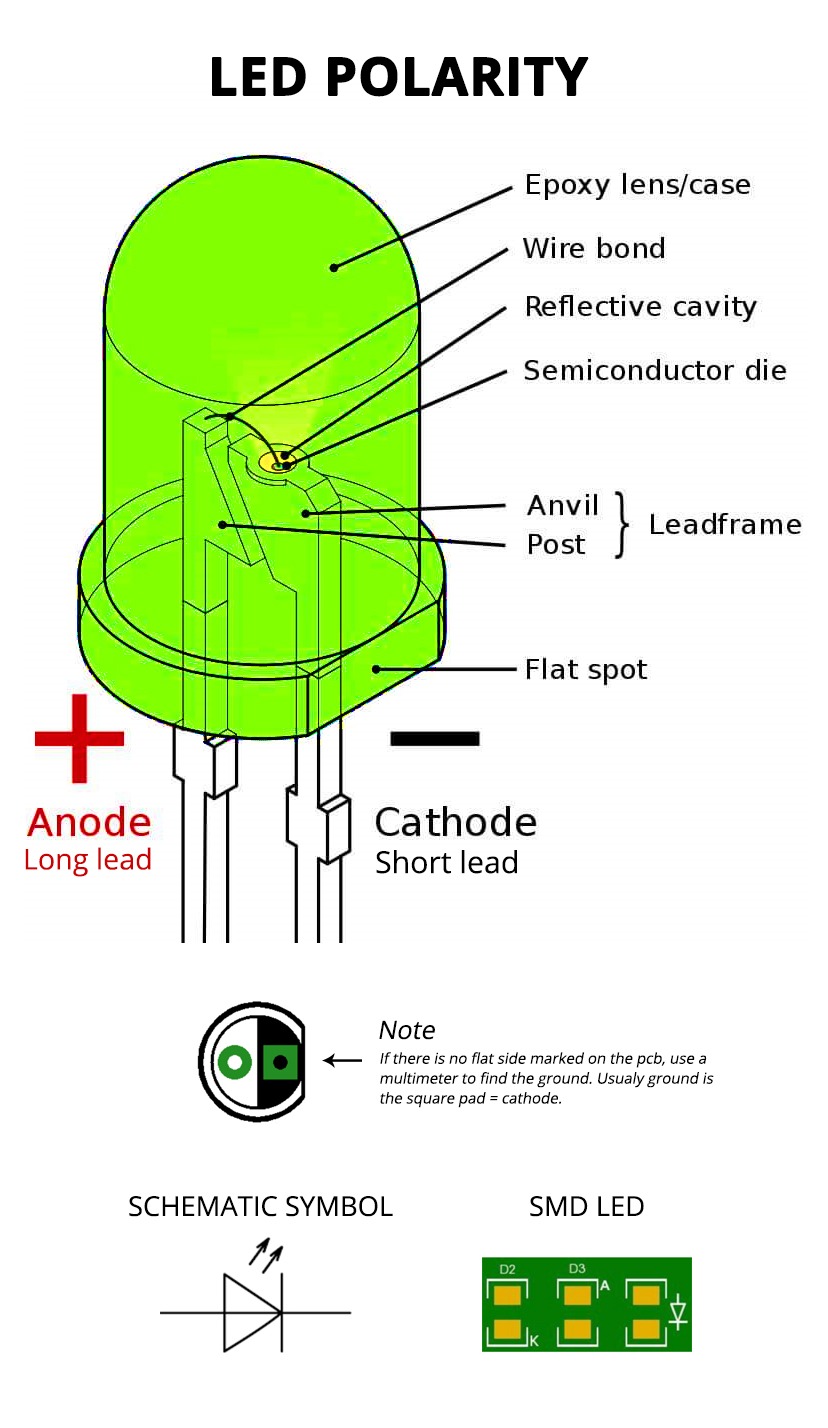

Adrian, which LED are you having the issue with?
I just measured the voltage and polarity of the LED in my amplifier pcb and the LED pad (square for cathode) on the pcb is correct.
I examined the power supply pcb and the cathode pad on that is also correct.
I ignore square pads noting polarity for this exact reason ... I get easily confused.I just measured the voltage and polarity of the LED in my amplifier pcb and the LED pad (square for cathode) on the pcb is correct.
For caps (as an example) many people use the square pad for the positive lead / long lead, which I understand to be standard.
As I understand it for LEDs, the standard convention (as you've done), is to use the square pad for the negative (cathode) / short lead...
One of my favorite PCBs uses the long-lead / square method for LEDs ... so... it seems it varies across designers.
I just ignore it and measure them like you've noted. DMM on diode mode... make LED light up (with my boxes of 100s of cheapies I've gotten duds). Stick it in with long lead to positive side of circuit using the schematic symbols.

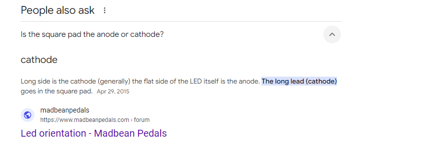

Heck, I just did a "Google" search for "Square Pad for LED" just for fun (and because I was curious about what's normal for LEDs) ... and look what came up... So, no wonder people get confused... Always trust the first search answer on the interwebs.
Cheers!
The long lead on the LEDs that I have is the anode. That is the standard convention. However there may be some LEDs out there that are reversed.
Don't believe everything you see on the internet. 🙂
I also check my LEDs with a meter in diode or LED mode before installation. I have damaged LEDs by keeping them connected to the meter for too long of a period of time. So now I just connect one lead to the meter probe and tap the other lead with the other probe to see if the LED lights up. To do this check, connect the short lead of the LED to the black probe and touch the red probe to the long lead. If the LED lights up, the long lead is the anode and the short lead is the cathode (red probe = LED anode, black probe = LED cathode).
Exactly... that's why all the laughing emojis. The fact that literally the first search result I pulled goes against all conventions... was a bit funny (to me). To a beginner that has no idea... it could be frustrating.Don't believe everything you see on the internet. 🙂
Edited to add - we both may be being a bit kind... I'll be so bold as to say... it's just factually incorrect re: relative leg lengths and the associated nomenclature.
