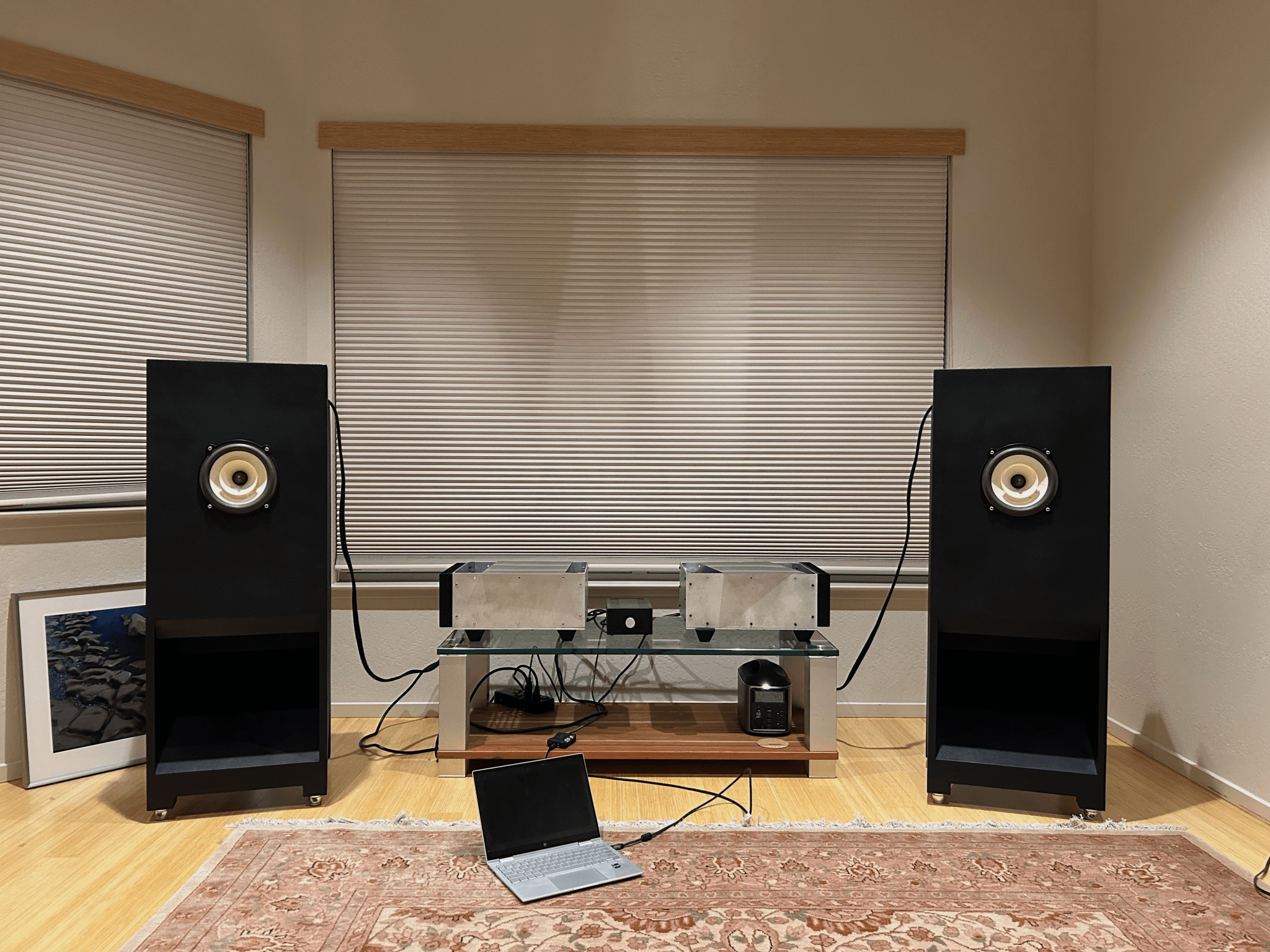

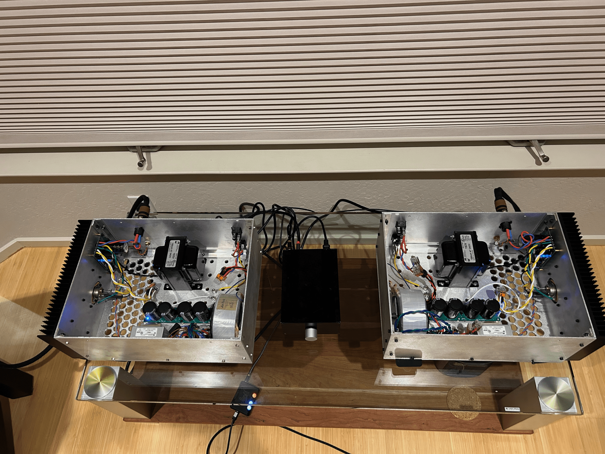

I've wrapped up the left channel today and it worked🥳 So far it sounds good, the heatsinks do get hot but I can still shortly touch them, also today it's the hottest day in the Bay Area, so I'll test them again in the coming days.
I'll bring them definitely to the Burning Amp 2024 festival, the only thing left is to create a top cover! Thank you very much again @Ben Mah, I've learned a lot and my first impression of the amps is very good!
Here are some pictures:
A note for other builders: Making the cases from scratch was the most time-consuming part of the project and I am fairly certain it cost me more (including special saw blades and drill bits) than two monoblock cases from Modushop. I got the aluminum from Metal Supermarkets San Jose. The metal was considered off-cuts, as I didn't need large sheets, which resulted in a nice discount. I've ordered the heatsinks from diyaudiostore.com.

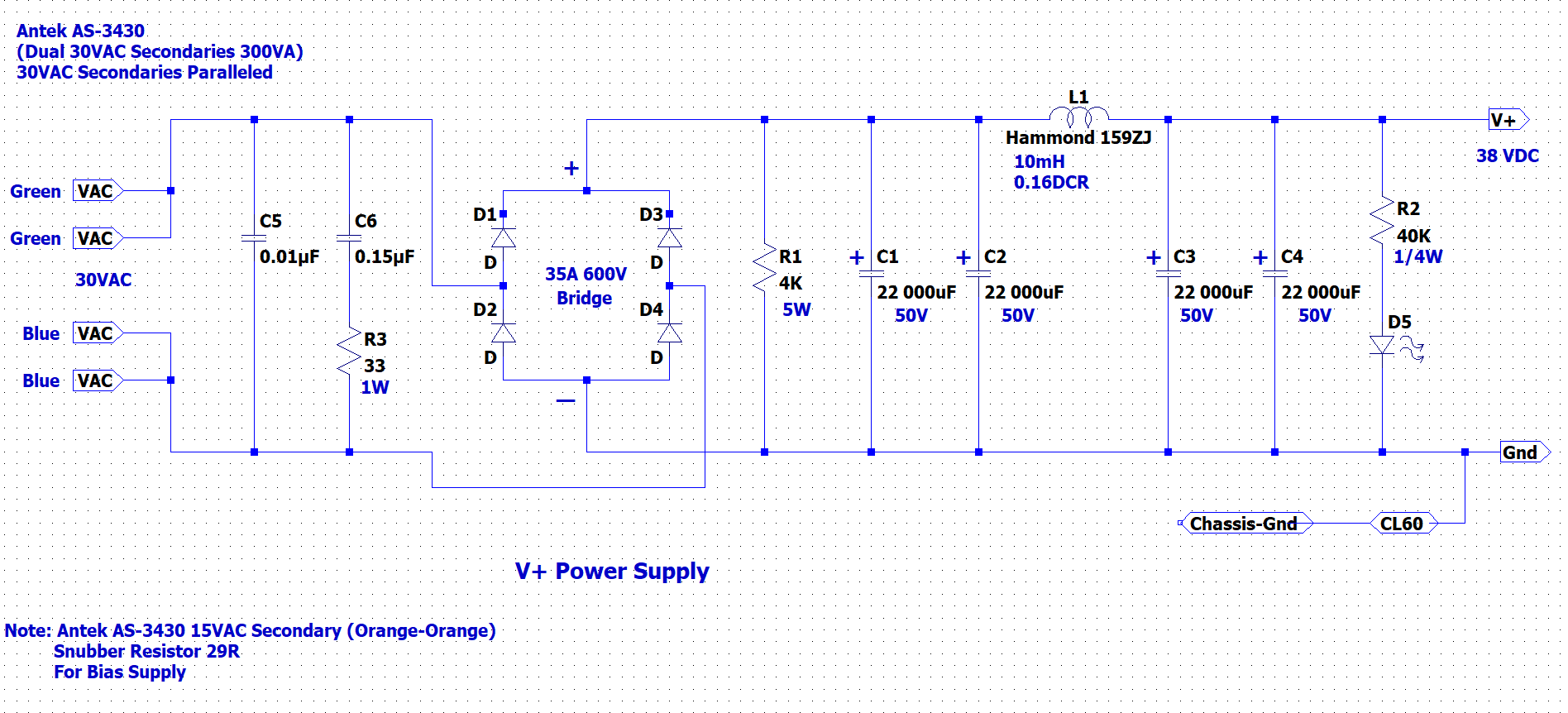

Here are some pictures and the schematic of the V+ power supply. I Quasimodoed the Antek AS-3430 and have included the snubber values.
Hi Ben. Back in 2021 you published this schematic for your V+ power supply. I'll attach it here. Would the snubber values be C5, C6 and R3? And if so, your note mentions "Snubber resistor 29R" which is a different value than what is in the schematic. Which one might it be?
Many thanks!
