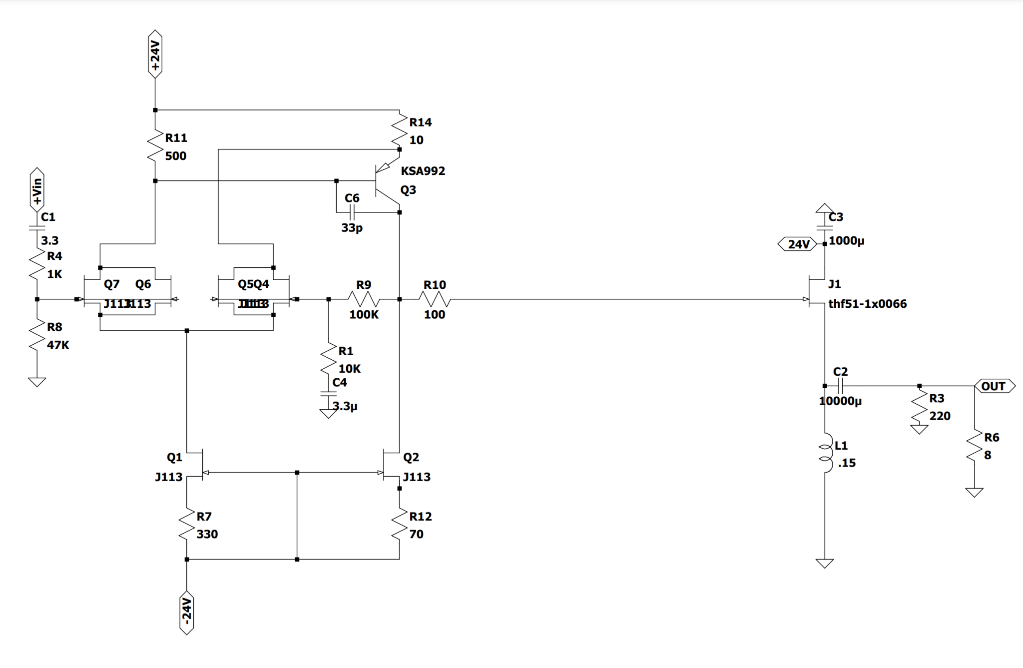

i will try to build one these THF51S Follower in the following month , it seems to be difficult to build a stereo amp with both the linear power supply and the big 193V choke i have . so is there any external SMPS to use ? is one 24V 5A meenwhell per rail will be ok ? running at 2.6A ?
If you have the heat sink capacity, go with 36 to 40V, and 2.5 to 3.0A. More power is always good.🤓

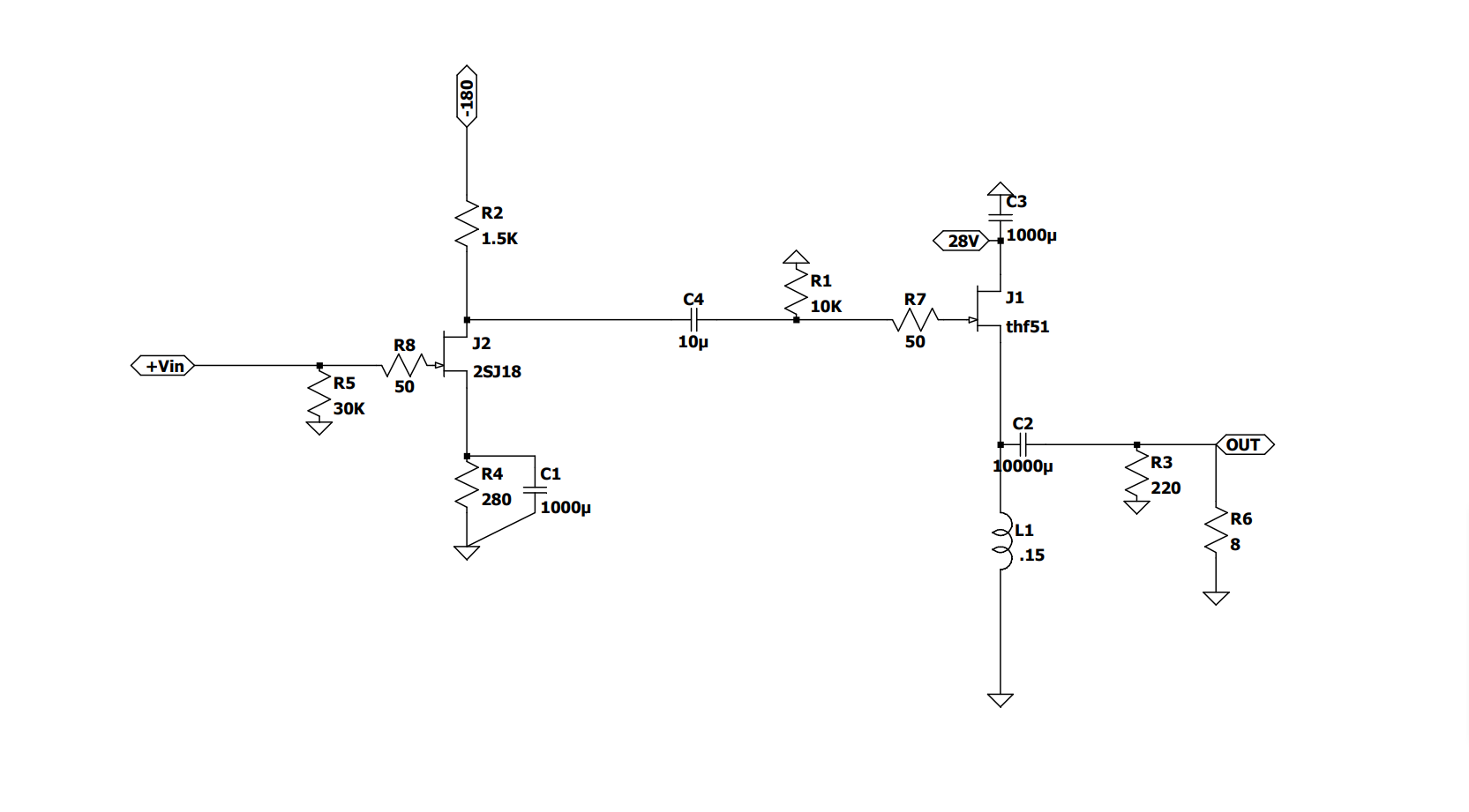

You will most likely need bias voltage adjustment because the Tokins are all over the place. There is no guarantee that the choke DCR will give you the Vgs to suit your Tokins, unless your Tokins are tested and selected to match your exact requirements.
The Sony VFET in your last schematic will need its source resistor adjusted to suit the current that seek too.
45V may be a bit high. I have not tried that voltage for choke loading so I have no idea what would be a good drain current for that voltage.
For sure you need to decide how much heat dissipation you can tolerate, or what heat sinking you would like to use.
You may want to prototype one channel and try and test operating points.
The chosen operating point/power dissipation and the heating sink capacity need to compatible.
Are you planning on monoblocks or a stereo amplifier? That will affect your choice of power supply capacity. For Class A amplifiers the power supply should be rated for at least two times the current draw.

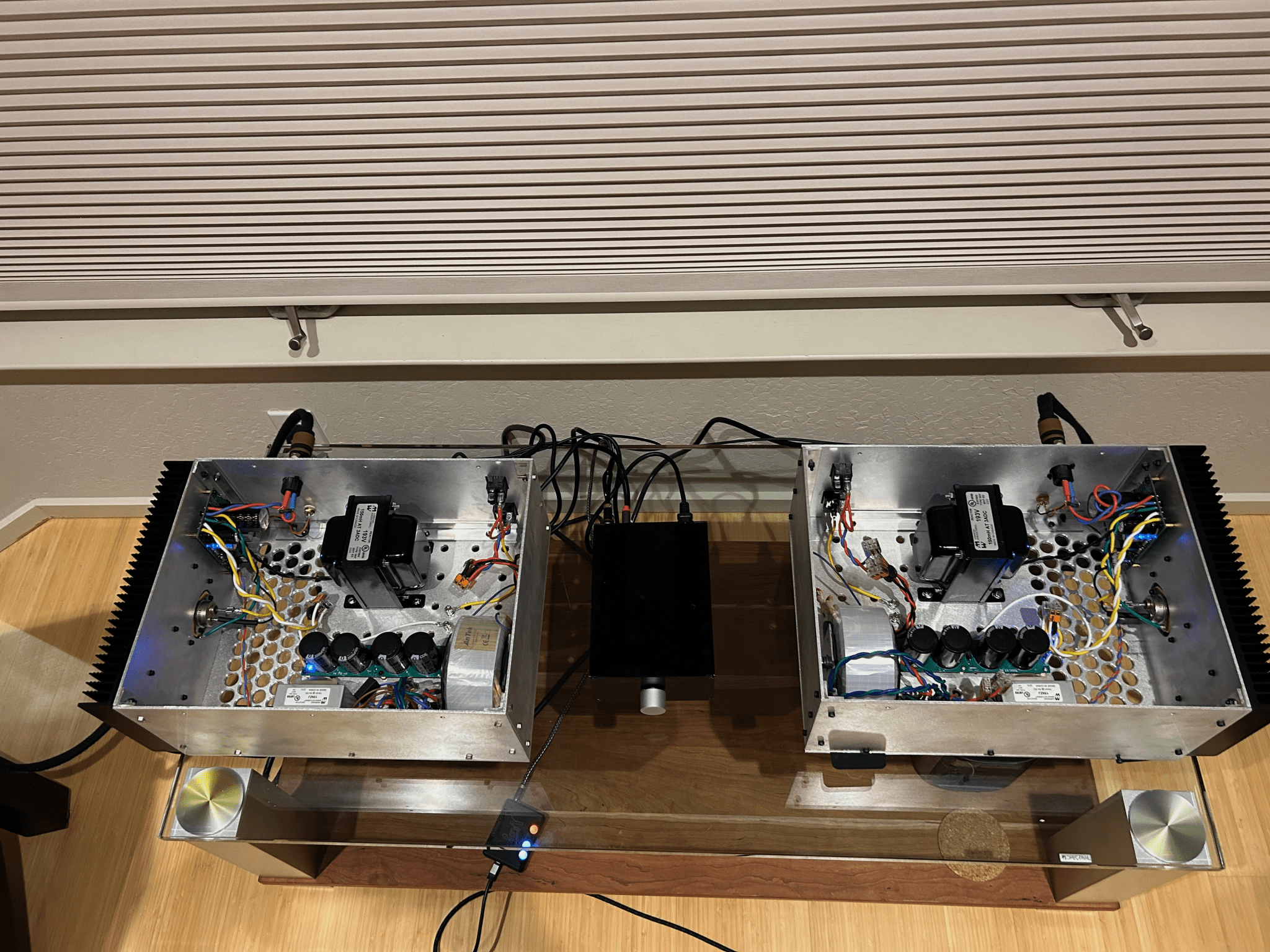

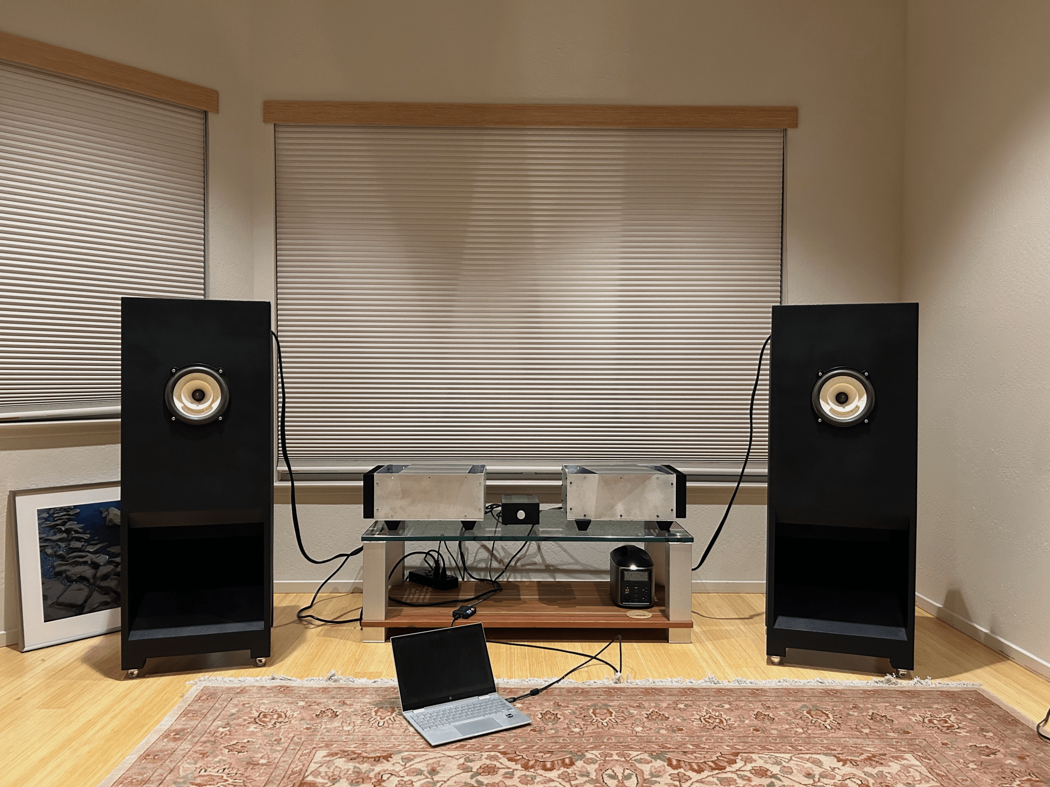

I've wrapped up the left channel today and it worked🥳 So far it sounds good, the heatsinks do get hot but I can still shortly touch them, also today it's the hottest day in the Bay Area, so I'll test them again in the coming days.
I'll bring them definitely to the Burning Amp 2024 festival, the only thing left is to create a top cover! Thank you very much again @Ben Mah, I've learned a lot and my first impression of the amps is very good!
Here are some pictures:
