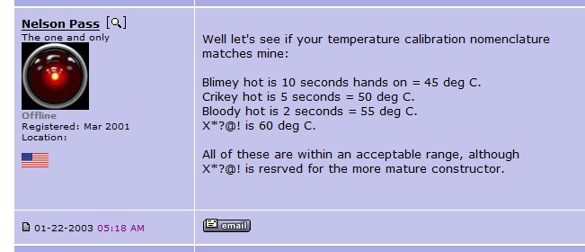

Thank you, Ben and Gianluca. Also, I'll add a category to Nelson's heat calibration chart: Not hot, which would be somewhere below Blimey hot on this chart, and seems to describe "...I can keep my hand on it indefinitely":
I'm going to have to put this on a T-shirt at some point.

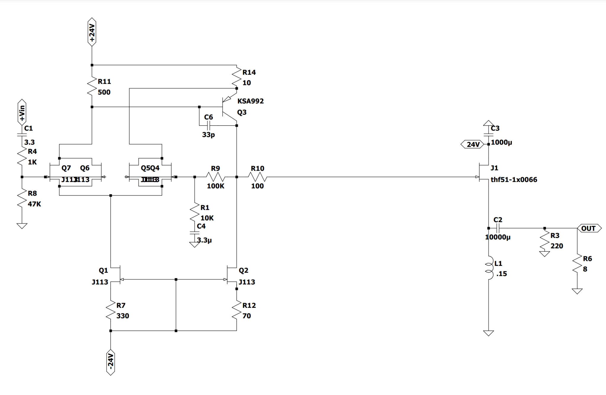

I'm working on another order for parts for my build and figured it might be best to check in with the group so that I'm not ordering parts I can't use. I will be building this design for a pair of 2SK180s. I have taken the parts list from what adrianrw posted a bit ago, but since he was building for the THF-51S I want to make sure the parts do not change for the 2SK180.
A few questions:
For the power supply parts:
I only found a part number for one of the bridge rectifiers, the 1000V 35A version, part # 4878-KBPC3510FP-ND. Are both rectifiers the same? I can't seem to find a reference. (Additionally, the schematic shows the part values as 600V 35A.)
General parts not on schematic:
CL60 thermistor for transformer primary windings (to work as soft start.) Specs or part number available?
Barrier terminal blocks - these are probably fairly general, but if there were a part number, I would really appreciate it.
Finally, here is the parts list.
Am I on? Am I way off? Either way, thanks for the help!
A big Meanwell on the positive side (that is: 5A or 6A quoted is what I have). This terminated in earth.i will try to build one these THF51S Follower in the following month , it seems to be difficult to build a stereo amp with both the linear power supply and the big 193V choke i have . so is there any external SMPS to use ? is one 24V 5A meenwhell per rail will be ok ? running at 2.6A ?
The second one that supplies the V- can just be 1Amp, as that is just signal. Minus 15V is also OK, as this side is a CCS. This means that well, you save money.
Parts are the same for THF-51S and 2SK180.
The 1000V bridge rectifier will work. Higher voltage is not an issue.
Here is a 600V bridge rectifier:
https://www.mouser.ca/ProductDetail...MCC/GBPC3506-BP?qs=y6ZabgHbY%2BwLrWgXpSfVHw==
https://www.digikey.ca/en/products/detail/mcc-micro-commercial-components/GBPC3506-BP/5040120
