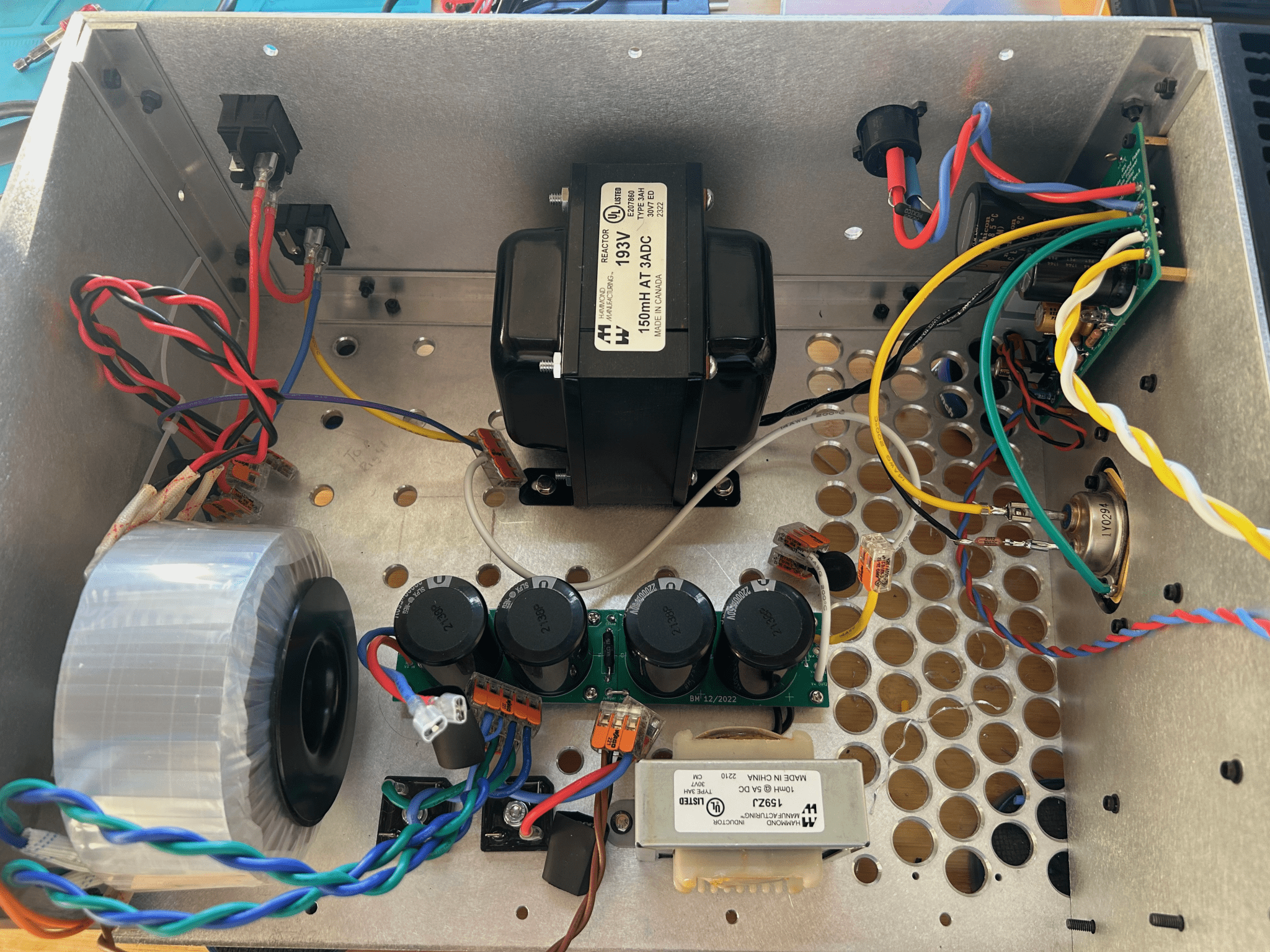

@Ben Mah, I am almost there with my right channel. I have two more questions before I start with power:
Adrian
- For grounding: my previous drawing was wrong, I've attached an updated one. Should the Input - (negative of RCA) connected to the chassis?
- I got a Variac as they aren't that expensive. Would slowly increasing the AC voltage make sense, or should I stay with only the dim light bulb test?
- I haven't connected the ground to the chassis yet.
- I haven't connected the RCA input yet.
- I've drilled much more holes in the floor for cooling.
- I am using crimp and WAGO connectors, after crimping I soldered the wire to the crimp connector. As for the WAGO connectors, let me know if you would change them to something else once I know everything works.
- Snubber circuit is under the heat shrink.
- The trim potentiometer has 21 turns, I wish I would have chosen one with less turns🙂
- Bulb tester is ready, I got some inspiration from the web.

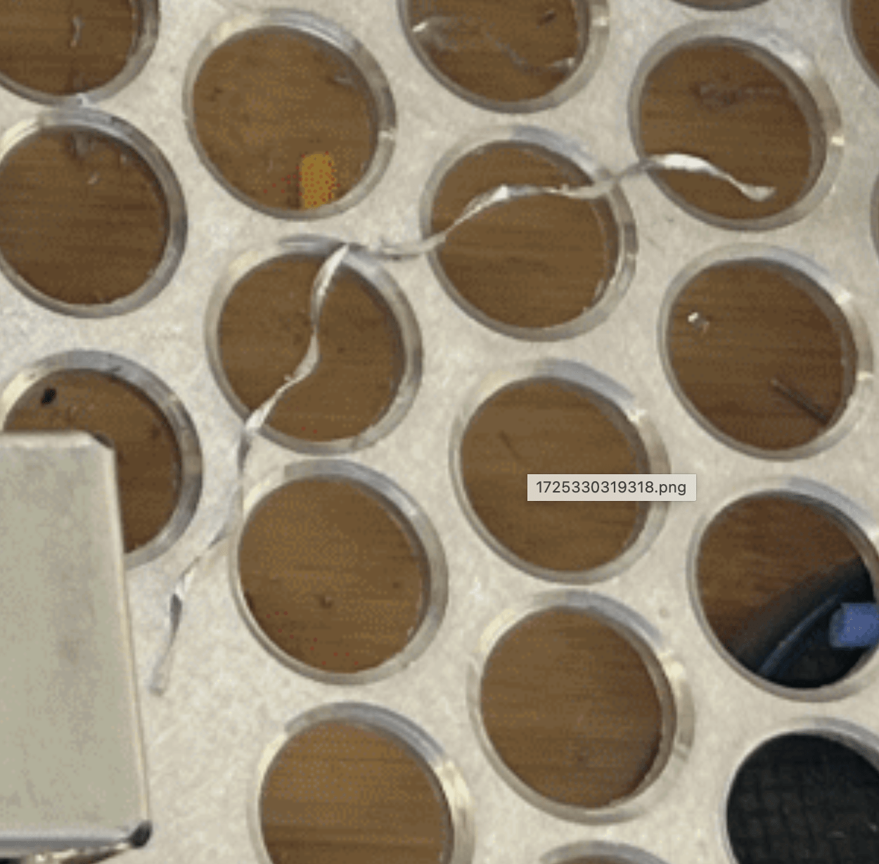

- There is some aluminium scrap from drilling in the picture, I'll clean of course everything before I start plugging it in.

Hi Adrian,
It's great to see that you are close to powering up for the first time.

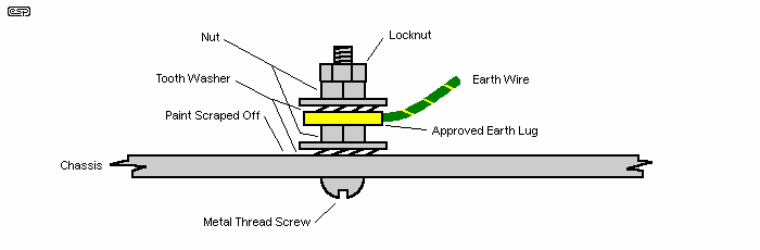

I looked at your previous power supply diagram and from a schematic point of view it is probably more correct. The IEC power ground wire should be connected directly to the chassis, with star washer against the chassis, ring connector on the ground wire, lick washer, and double nuts. The ground wire connection to chassis should be very secure and be difficult to be accidentally removed.
The transformer screen wire and power supply ground lift thermistor may be connected to the chassis in a similar manner to another screw next to the safety ground screw., using ring connectors.
The input signal and ground wires should be twisted together and soldered to their Input+ and Input Gnd pads on the PCB.
I have never used Wago connectors so I have no experience with them. However if they are insulated and cannot short out against the chassis, they are probably not a problem for wire connections. However you should be careful with the thermistors in the AC lines as they will heat up when the amplifier is on and current is flowing. For connection of components such as thermistors, I prefer to use terminal blocks screwed to the chassis so that the components are not floating and free to move around.
At the back panel I see that the AC hot and neutral wires are not twisted, and the wires from PCB to SIT drain and source are not twisted. It is best to twist them.
You can use the DBT for first power up or the variac.
The power supply should be tested by itself first. Without the amplifier board attached, the voltage should be a few Volts higher. The DBT is probably best for this. The bulb will glow bright for a short period of time as the capacitors charge. Then it will go dark. If the bulb stays on, then there is a problem.
For full power up tips, see https://www.diyaudio.com/community/...-choke-loaded-2sk180-lamp.366312/post-7270513
Be sure to double check all wiring. Be sure that all power supply wires to the amplifier PCB are correct for power supply polarities, and all other wires are in their correct locations on the PCB.
I had a look at powering up with a Variac and I do not think it is a good idea. The reason is that SITs need gate voltage to control their drain current. If a Variac is used, the SIT gate voltage starts out at a very low value, allowing high current to flow. So I recommend using the DBT for first full power up.
Before powering up, be sure that the trimmer resistor is set to fully counterclockwise, and have a meter set to VDC connected to T.P. Choke 1 and T.P. Choke 2. This is to monitor the SIT drain current. The DCR of the 193V is 1 Ohm, so 1V = 1A. See above mentioned power up tips.

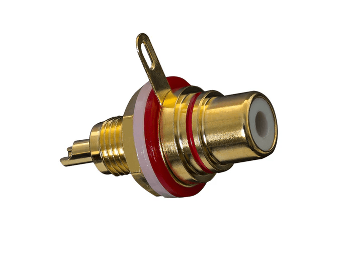

What pinholer said re: RCA input jack.
One of the washers is usually a shoulder washer. The washers are also usually the same colour as the colour band around the RCA jack. So the RCA jack with the red band should have two red washers and the RCA jack with the white band should have two white washers.
