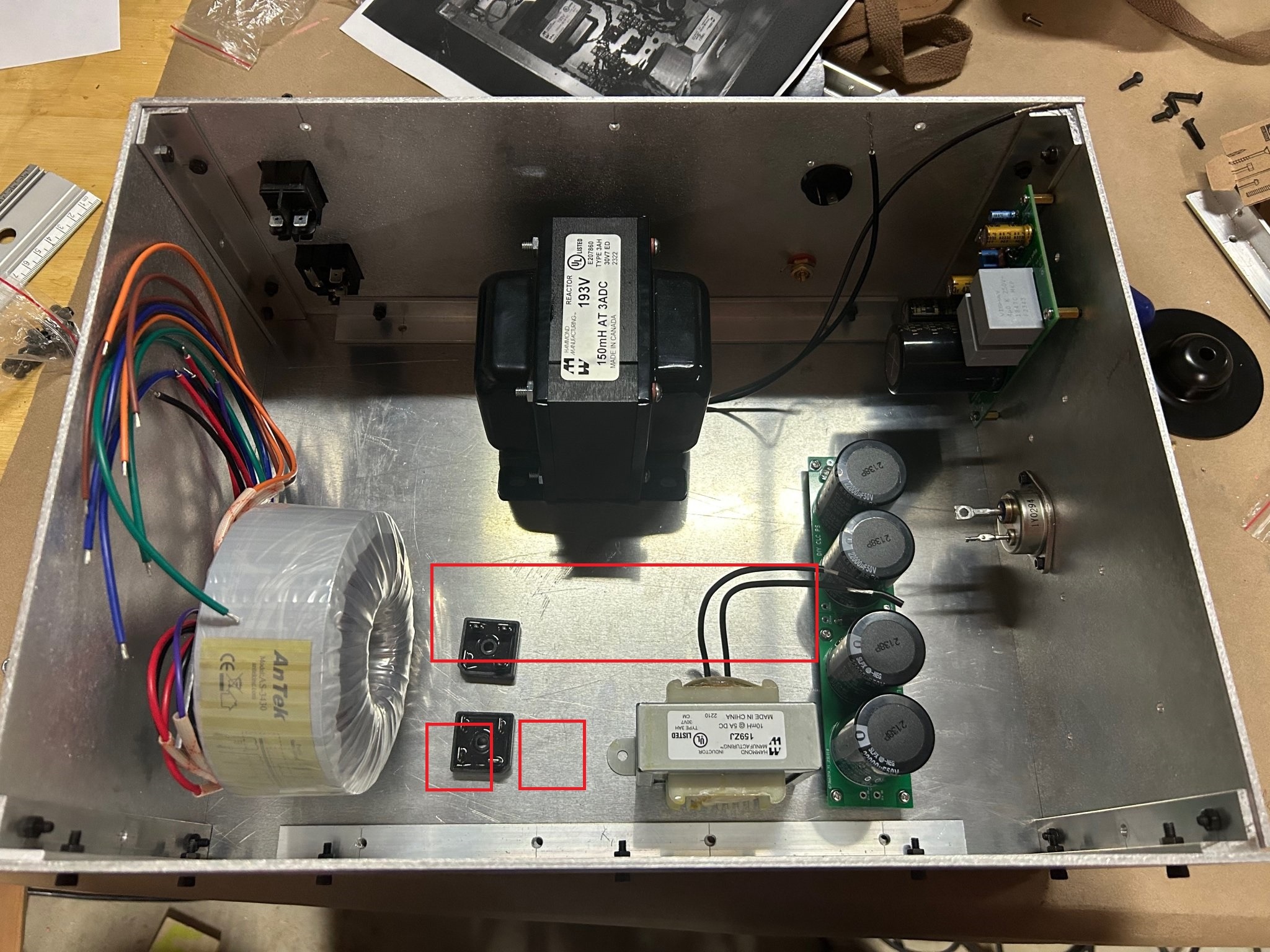

Anyway, I thought I would ask before I drill the last couple of holes and get to the wiring and testing part: is the layout below good or should re-orient or re-position some of the components? I think my case is a bit bigger than yours and in opposite orientation.
Note that in the picture the SIT is currently not isolated from the case and the heat sink not attached to the side. I'll use a perforated aluminium top. for cooling. Also, I'll attach the heat sink with a thermal paste and 8 M3 screws.

you'll need some air ........... and then some and then some more
means proper slits in bottom , then same on top cover
and you'll need some heatsinks ........... not just bolted to sides and counting it's heat-wise enough , simply because that thickness is too flimsy to transfer heat - you'll need big holes so output parts is bolted to heatsink directly,
What Zen Mod said.
The inside of the chassis will get hot. Venting of the top only will not be very effective as hot air rises but without openings in the bottom, cooler air will not be able to easily flow into the chassis. Vents in the bottom of the chassis will allow cooler air to enter the chassis and maintain an effective upward air flow. Also key to air flow are feet under the chassis to elevate the chassis to allow air to flow under it to enter the chassis. Tall feet are best.
Also as Zen Mod mentioned, mount the SIT directly on the heat sink for best heat transfer. Cut a hole in the side panel. The hole only needs to be big enough to fit the SIT. Either a circular hole or rectangular hole - whichever is easiest for you to do.

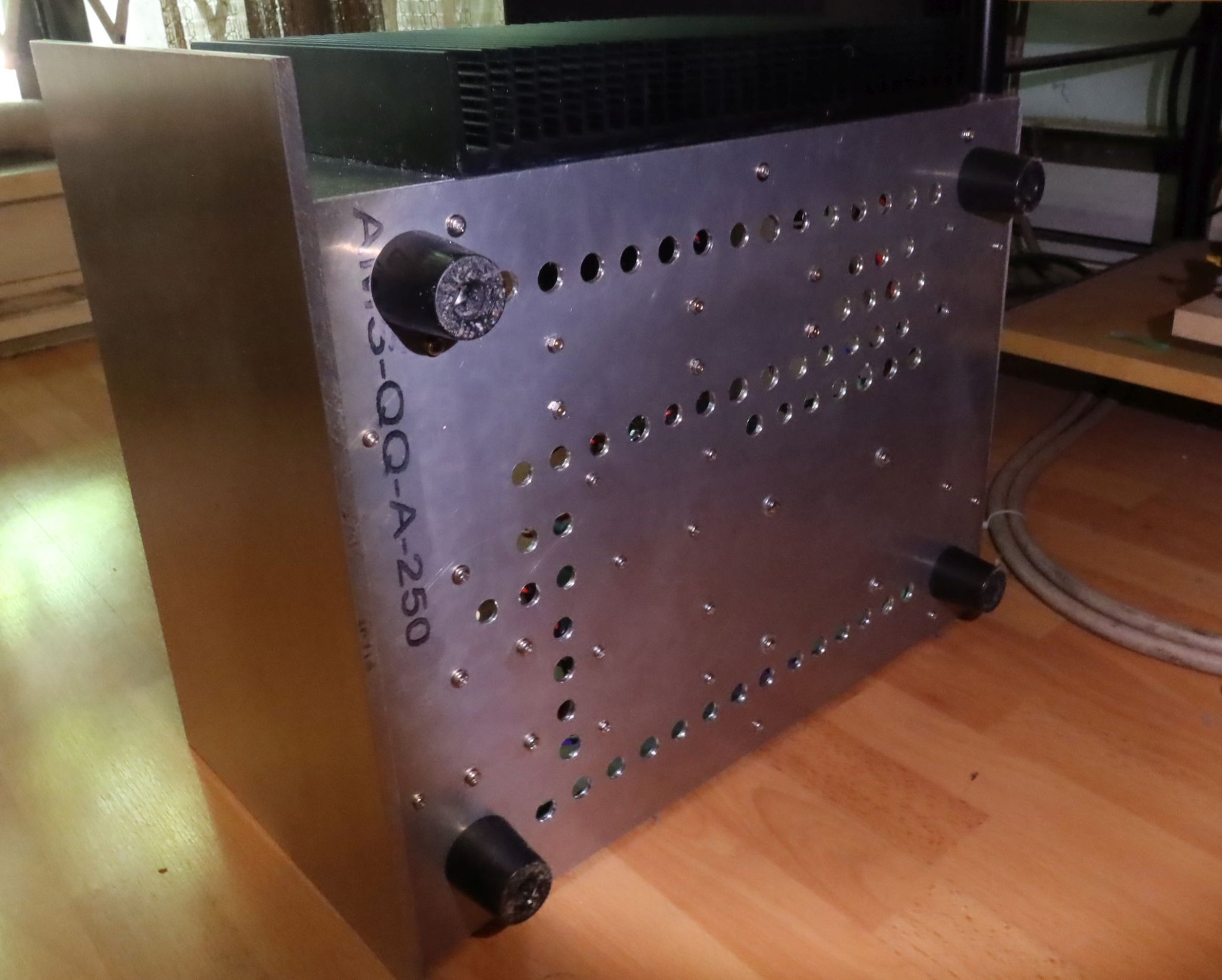

Here are the holes in the bottom of my chassis and the hole in the chassis side wall to allow the 2SK180 and angle mount to be attached directly to the heat sink:
For the component layout, I suggest locating the two bridge rectifiers and capacitor bank this way:

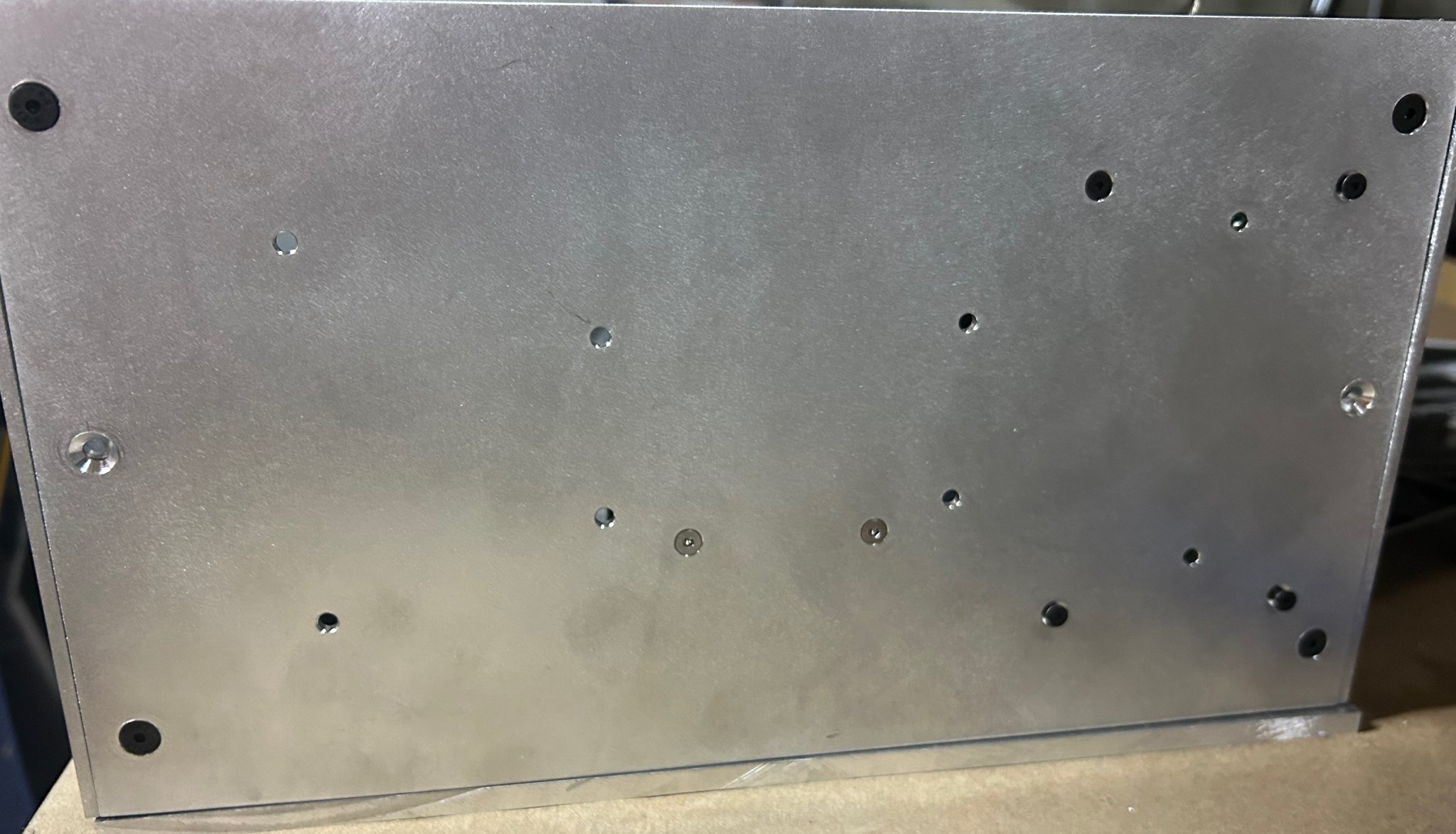

... after a couple of hours of drawing/drilling. I used 3/8 in ventilation holes. I'm thinking of where to best place the ground connection - possibly in the middle of the red square. For the SIT I cut a hole with 2 x 20mm and 1 x 35mm Forstner bits, I have to do some more cleaning up with a file so that the SIT doesn’t touch the aluminum.
slightly bigger hole for SIT should be more pleasing to eyes, and also giving better sleep
you can slightly shorten/decrease bottom plate, to have slits on circumference of box bottom
it'll give immensely more air than few tiny holes
never underestimate heat, there is simply no such thing as too big heatsink ....... as soon you hit 50W figure and you're not living in cold cave

I strongly suggest that the power supply filter board be located as shown in the picture that I marked up. Have the DC entry end of the board next to the rectifiers and the DC exit end toward the heat sink. That will keep the unfiltered DC ripple and wires farther away from the audio. The wires will also be shorter.

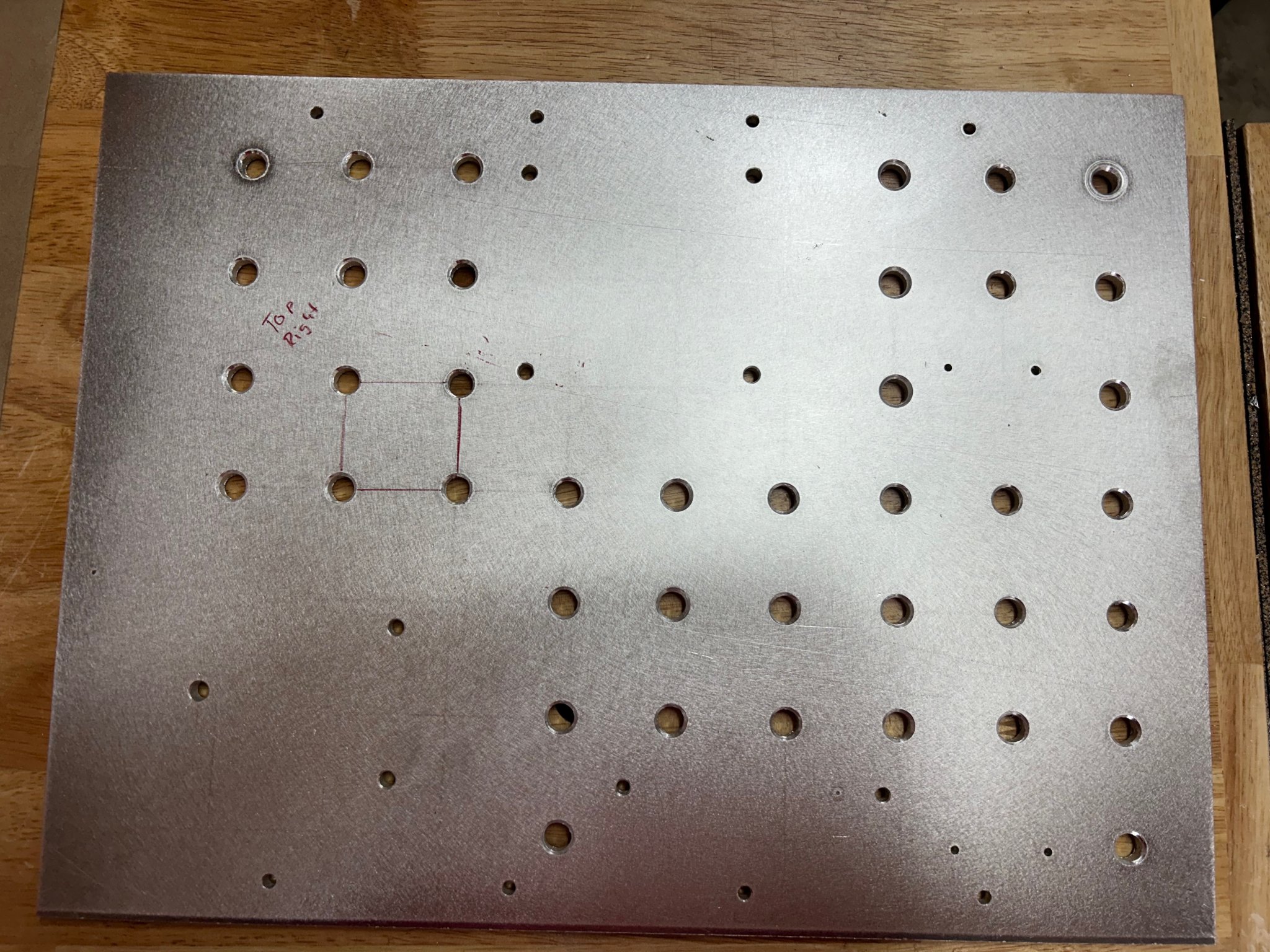

Here is my chassis bottom, with 7/16" cooling holes and 1 1/4" high feet.
I would add more holes in the bottom plate close to and parallel to the heat sink. That is where most of the heat will originate.
Great, thank you. I'll add more cooling holes and switch the power supply filter board. I missed that in your previous post, I thought it was to make space for the preamp section.
