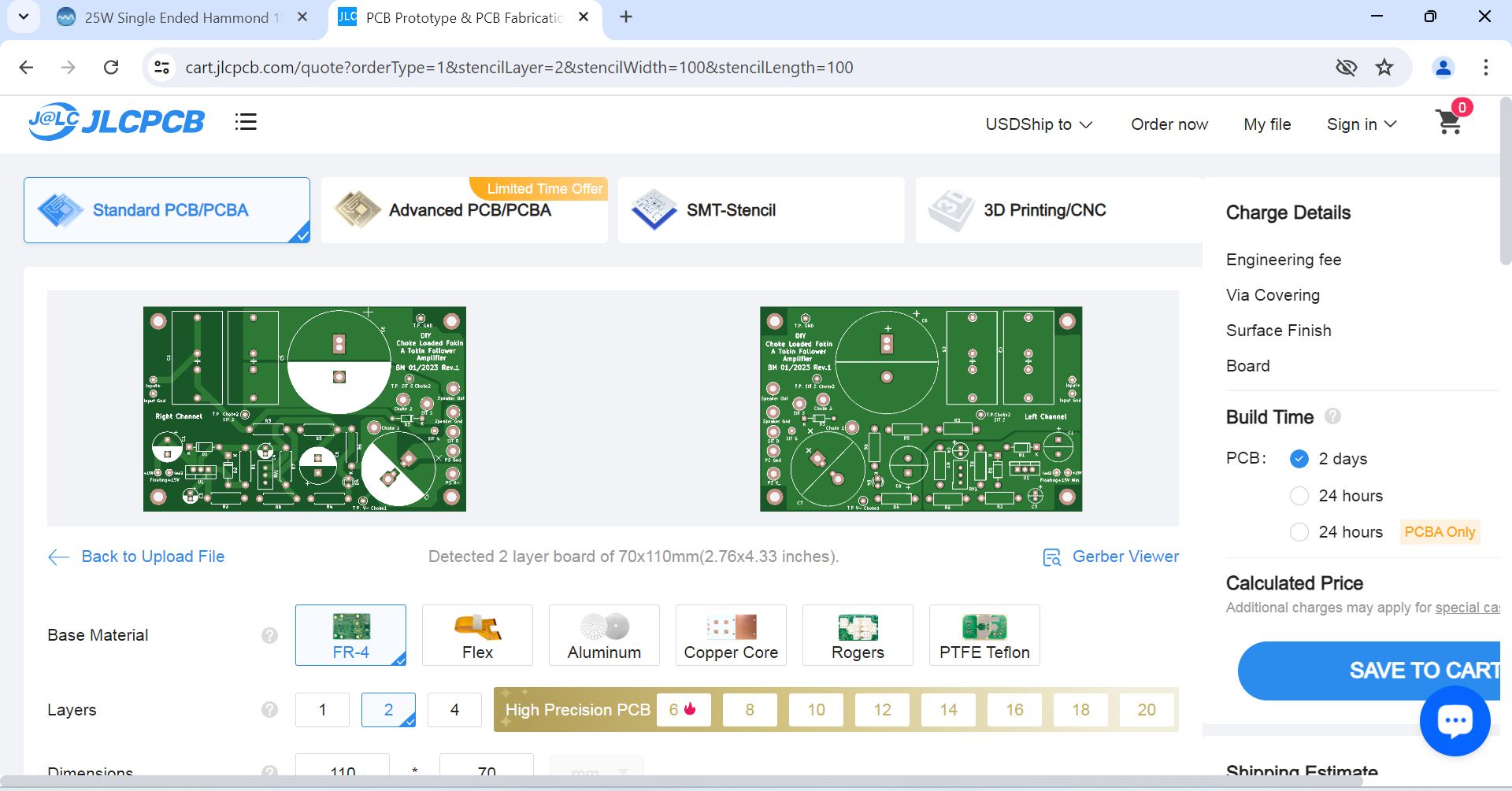

2 layers, but first upload the Gerber files. Then it will display the PCB. Upgrade options will be available but I usually accept the standard.
Screenshot of JLCPCB webpage after Gerber files uploaded:
I usually do not make any changes. The defaults work just fine for the amplifier.

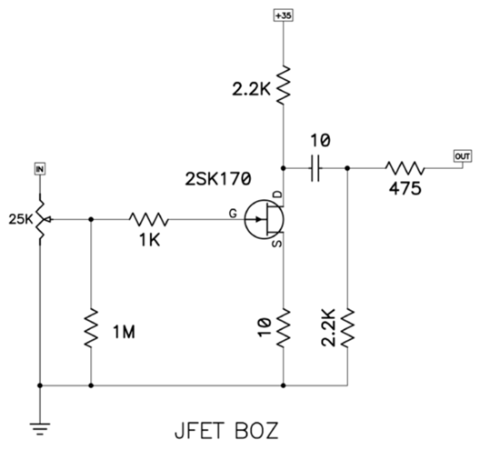

I need a preamp to drive the Hammond 193v Choke Loaded (THF-51S) amps.
The pre I use is going to be the Jfet Boz from Nelson Pass, powered with a 9V battery. In the schematic of the Jfet Boz the 10uF capacitor and 2.2K resistor form a first order highpass filter. So I could change these to 1uF and 1K to get a highpass filter at 160Hz, but I dont know if this makes this preamp instable?
Or maybe I can remove the 4uF (C2) capacitor in the THF-51S amps and replace this with a wire? Or does this have consequenses?
Or I could change the 10mF (C6) in the THF-51S amps to 124,33uF to get 160Hz? This last has my preference... Now I can use non electrolytics....
Or do I just keep all caps and resistor values the way they are in the schematics and use my original filter with volume pot between the DAC and pre-power amps?

Here is the preamp schematic.

I do not have any experience with the JFET BOZ but it may not have enough voltage output for this amp, since the amp is a follower with no voltage gain. I think the JFET BOZ may also have quite high harmonic distortion when pushed to its voltage limit.

Befor I try Nelson's DIY FE 2022 I would like to try the jfet boz. It has a gain of 24. With a powersupply of 35V it could give 12.5V. Maybe it can take 40V, than it can give 14V...

Ben, howmuch voltage output does the preamp need to drive the Hammond 193v Choke Loaded (THF-51S)?
According to Nelson Pass the jfet boz has the least distortion with a 16V ps. This could be a battery ps..

Is the 12.5V peak to peak, peak, or rms? If it is rms or even peak, that seems high for a resistor load.
If the amp is run at 2.5A, the maximum power output at 8 Ohm is about 25W. Taking into account for losses etc, that would need an input of about 16Vrms, or about 23Vp.
I do not think the DIY FE has feedback.
Another option is to use the DIY FE as a front end, installed in the amplifier chassis and powered by the amplifier power supply, and keeping the JFET BOZ as a preamp.
Note that the DIY FE has much lower distortion than the JFET BOZ. So using the DIY FE as a preamp will probably sound a bit different than using the JFET BOZ as a preamp. You can only determine which you prefer after you hear it and compare it to the JFET BOZ.
