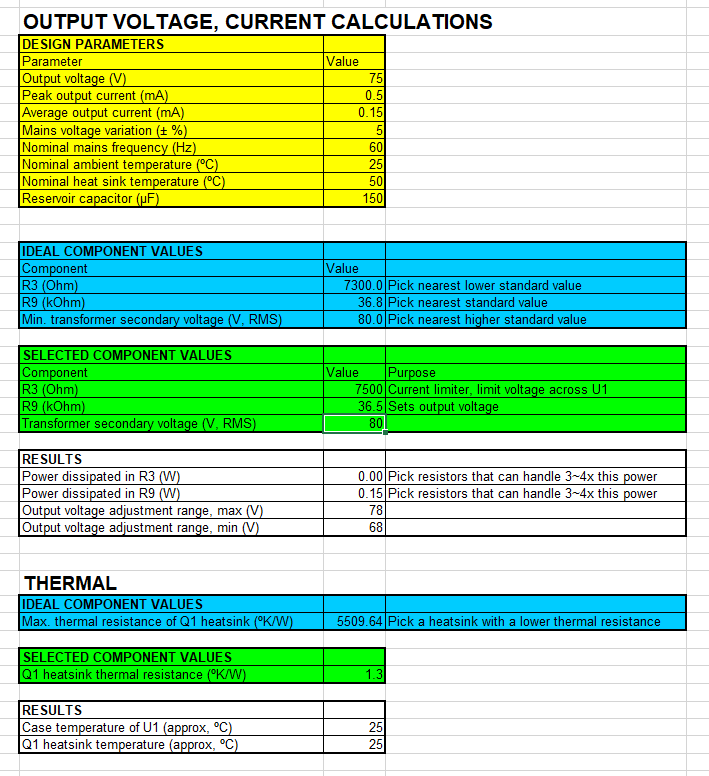

Could I use the Maida for the B+ of a pair of Korg Nutubes? Each nutube needs 75V and will draw 64uA, for a total of 128uA (or 0.128mA).
I've attached the calculator output. For R3 and R9, I was planning on using 1W Vishay CMF60 resistors. Are those alright?

Don't forget to account for the load current in that case. I'd probably make R3 = 100 Ω. That'll set the current limit to about 35 mA, which would be plenty.
1 W resistors would be plenty.
A use case where hardly any current would be drawn from the regulator did not occur to me when I wrote the spreadsheet, so I didn't account for that. You'll always have at least 2 mA flowing through R3 due to the feedback resistors, so it really should be no higher than 1.6 kΩ.

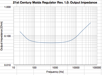

Hi Tom, what is the psrr of the reg, I can't find the graph..?
100-ish dB at mains frequency if I recall correctly. It depends some on the output voltage. I'd have to rerun some simulations to check. Which output voltage are you looking for?

Whatever voltage... is there a simulation file in the thread?

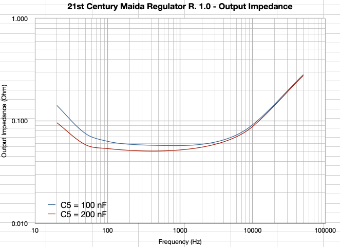

Only a simulation, set up to measure the output impedance. If you change the right axis to "phase delay", the "Q" of the circuit at the impedance peak is frequency * phase delay * pi.

I doubt it. There is a schematic in Post #1, though.
I've made a few tweaks since then, but it should provide a starting point for you if you'd like to DIY the circuit.

It's ok, thanks, jackinnj sent simulation file, I need it only for comparation, I'm experimenting with another "maida type" topology... Btw I'm used to Micro Cap, LT spice is still not user friendly after all these years. 😡

anyone else running the simulation with LTSpice -- use {X} for the ESR of C2 and the following parameter step instruction: .step param X list 100u 10m 500m
