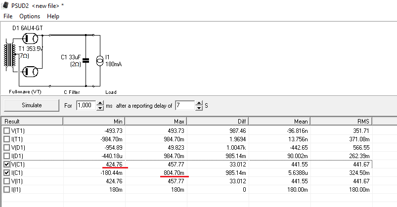

Hey Tom, I have a couple questions for you:
1. In your calculator, I set the output voltage to 365V, average current at 180mA, and 33uF input capacitor. The calculator recommends a PT with a secondary of 362V. In PSUD, I modeled a PSU with a 350V secondary, a 180mA load, and tube rectifier... and after the first cap (input to the maida regulator), I see a minimum of 424V. That's way beyond the needed 15V drop that the regulator needs for a desired voltage of 365V. Could I possibly use a PT with a lower secondary than the calculator's recommendation, say 350V instead of 362V? Or am I not modeling it in PSUD correctly?
2. How do I see peak output current from PSUD? Is it the peaks in the graph after the inrush current has calmed down? In this case, about 804mA according to PSUD? That seems really high to me. I'm looking at the current in the capacitor before the regulator.

My calculator spreadsheet assumes you'll be using a solid state rectifier (basically zero voltage drop).
As for the output current keep in mind that the conduction angle of the rectifier is relatively small, so the rectifiers will have to replenish the charge in the supply cap in a small fraction of the mains period. That's why you see the high ripple current. That's inconsequential for the Maida Regulator as it'll be on the load side of the cap.

Thanks for the response. What I was saying is even with the tube rectifier V drop and a transformer with a 350V secondary (which was lower than the calculator's 362V recommended), the input voltage to the regulator was still adequate, with about 60V of headroom above my target voltage. In other words, it seems like the calculator aims really high for input voltage.
Suppose I use a solid state rectifier instead. My question still stands: can I use a transformer with less than the calculator's recommended secondary voltage if PSUD reports that I'll have more than 15V headroom for the regulator? For example, in my same setup in PSUD I changed the rectifier to SS and used the 362V secondary the calculator recommends. The resulting input voltage to the regulator is 475V, which is a full 110V over what my target output voltage is. That's way more than the needed 15V headroom.
I'm not sure I understand the part about peak output current. I'm just trying to find what value I should put as peak output current in the calculator. I assume that the 180mA load I specified is the average output current. But I'm not sure about peak current.

I don't have the math of the spreadsheet committed to memory, but I would think that any difference between PSUD-II and the spreadsheet would be due to differences in mains frequency, mains variation, and peak load current.
I would expect the results from PSUD-II to be closer to reality than the results from my spreadsheet. I would think that the two would agree within, say, a few percent -- assuming that you use the same inputs (mains variation, mains frequency, etc.). That said, my spreadsheet uses some approximations. It's an Excel sheet, not a circuit simulator.
You're seeing a difference beyond a few percent, so I would try rerunning the PSUD-II sim at low mains and with the peak current instead of the average current.
The average current should be set to whatever your circuit uses at idle (or with an average signal). The peak current should be set to whatever your circuit uses when it delivers the maximum signal.
Take my DG300B for example: At idle a stereo DG300B uses about 200 mA (12 mA for the input tube, 5 mA for the driver, 85 mA for the 300B, per channel -> I_avg = 2*(12+5+85) = 204 mA give/take. The driver and input tubes are CCS loaded, so their current draw won't change versus signal level, but the output tube's current draw will. It could change by as much as 85 mA, so I_peak = 2*(12+5+2*85) = 374 mA. I designed the regulator for 400 mA.
Your circuit is different and you'll have to work out those values. You can do so either by simulating the circuit, by reading the tube data sheets and working out the load lines, or by asking the designer of the circuit.
