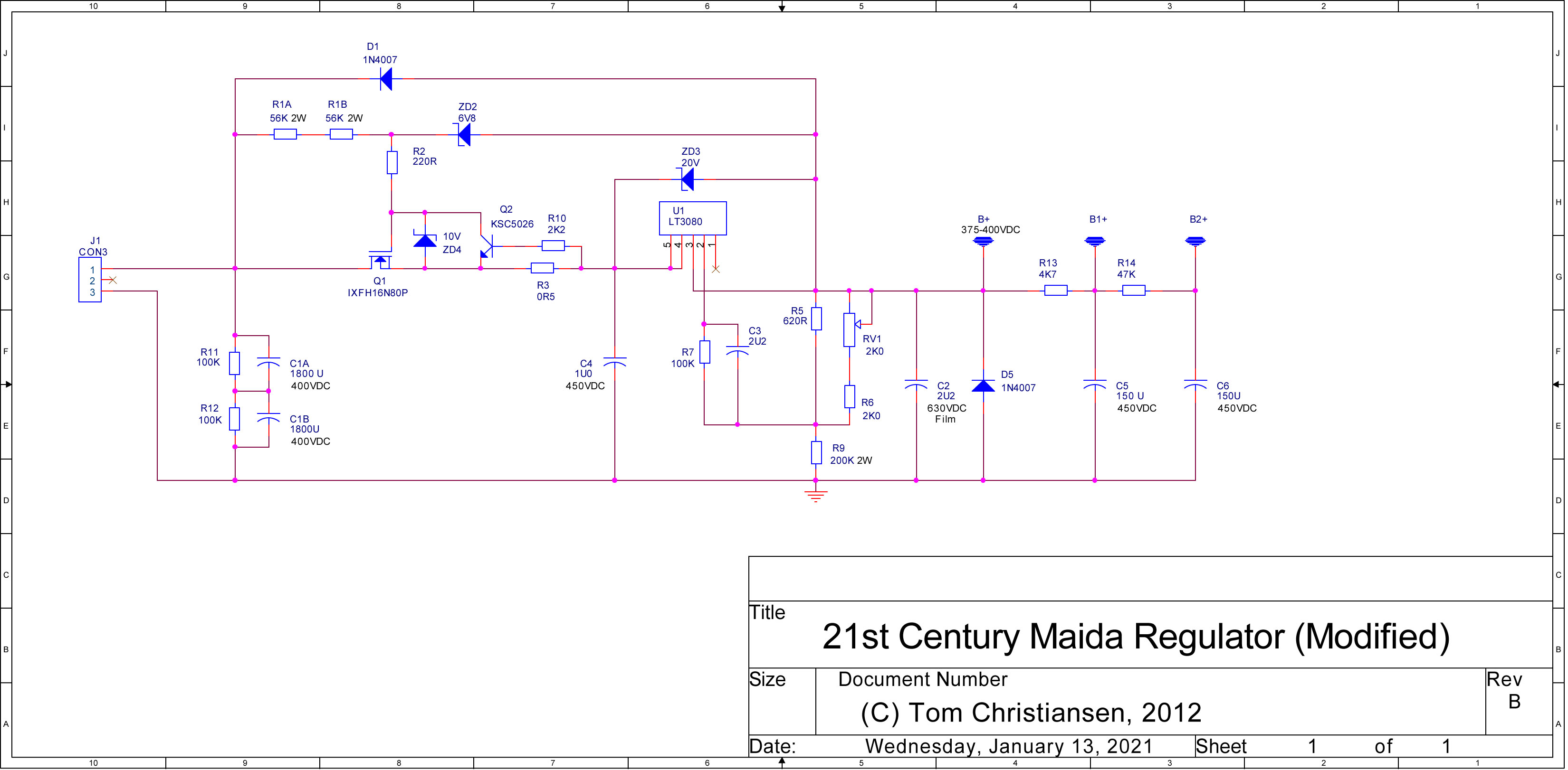

I'm having some trouble with my maida regulator, and hoping someone here can help out. I'm currently using it to tinker around with the PSU of my bottlehead crack (new PT, maida reg, new caps... the whole works). The regulator is regulating the voltage to where I want, but the output ripple seems to be really high. There is a very clear 120hz hum coming through the headphones. To confirm it was PSU ripple, I added an LC filter after the maida reg, and the hum disappeared. From my understanding, the maida reg should produce extremely low inaudible ripple by itself. Anyone have ideas on why the ripple would be so high with just the maida reg?
For reference, I'm working with a 265-0-265V PT -> 5AR4 -> 33uF input cap -> maida reg -> 180V output voltage. Current draw from the amp is about 75mA. Also, I just discovered that no output cap is needed on the maida reg, so at one point I had several 100's uF on the output of the regulator (treating it like a pi filter). Could this have damaged it? I wouldn't think so, considering it still regulates the voltage properly...

That usually happens if the valleys of the ripple voltage drops below Vout+15V.
What's your desired output voltage?
Have you tried dropping that into PSUD-II and simulating it?
Nah. It's fine. At lower voltages (and with the impedance of the 5AR4 rectifier) the Maida can handle more abuse. I do recommend that you let the regulator do its job and just have 10-20 uF as local decoupling in the amp circuit.

No worries, thanks for the response. The output voltage I want is 180V. The measured input voltage to the regulator after rectification and the 33uF cap is 414V, so well above the minimum requirement from your spreadsheet.
Do you mean modeling just the PT, 33uF cap, and 5AR4 in PSUD? If so, I'm getting 345 to 359V (about 13V ripple) after that input cap. Still well above the 15V drop out.
Oh, wow. Yeah. 350 -> 180 V should not result in hum on the output. Does it hum after you removed the 100s of uF on the output?

Yes, it still hums after removing all output capacitance. For sanity, I tried both the 5AR4 as well as a solid-state plug in rectifier. Both resulted in 350-360V input voltage.
Something interesting I discovered is that if I add an LC filter before the regulator, the hum is still there. But, if I add the LC filter after the regulator, the hum goes away. That's confusing...
That's odd. It sounds like the regulator isn't working, but it provides the correct output voltage. That's really weird. How do you have the ground of the regulator connected?

Ground is connected on the ground side of the V_in connection on the regulator. Everything is set up outside the original amp, so the regulator's ground plus a few other ground wires (PT center taps, PT internal shield, caps if using the extra LC) are bussed together and connected to the star ground spot on the amplifiers original circuit.
Would you try measuring the AC voltage at the output of the regulator. That should register as 0 V on just about any handheld meter.

Yup, that measures 0V AC.
That would indicate that the hum is not caused by the Maida Regulator.
I think you mentioned that your setup was:
Transformer -> 5AR4 -> 33 uF -> Maida, but with a shared ground. Try separating the ground from the input to the Maida from the output. So basically you keep the transformer, rectifier, and reservoir cap separate and connect that to the Maida. Then connect the output of the Maida (including its ground) to the ground of the rest of the amp.

Aha, that fixed it! From just eye-balling the PCB, it looks like the grounds for v_in and v_out are connected together, so I assumed that I could just connect one or the other to ground. But using and separating the ground connections for both v_in and v_out fixed it. Thank you!
Yep. The ground on the Maida Regulator is connected from input to output. But the "dirty currents" are on the input side. Think of the ripple current through the 33 uF capacitor, for example. That needs to be kept away from sensitive circuits, such as the input/signal ground.
