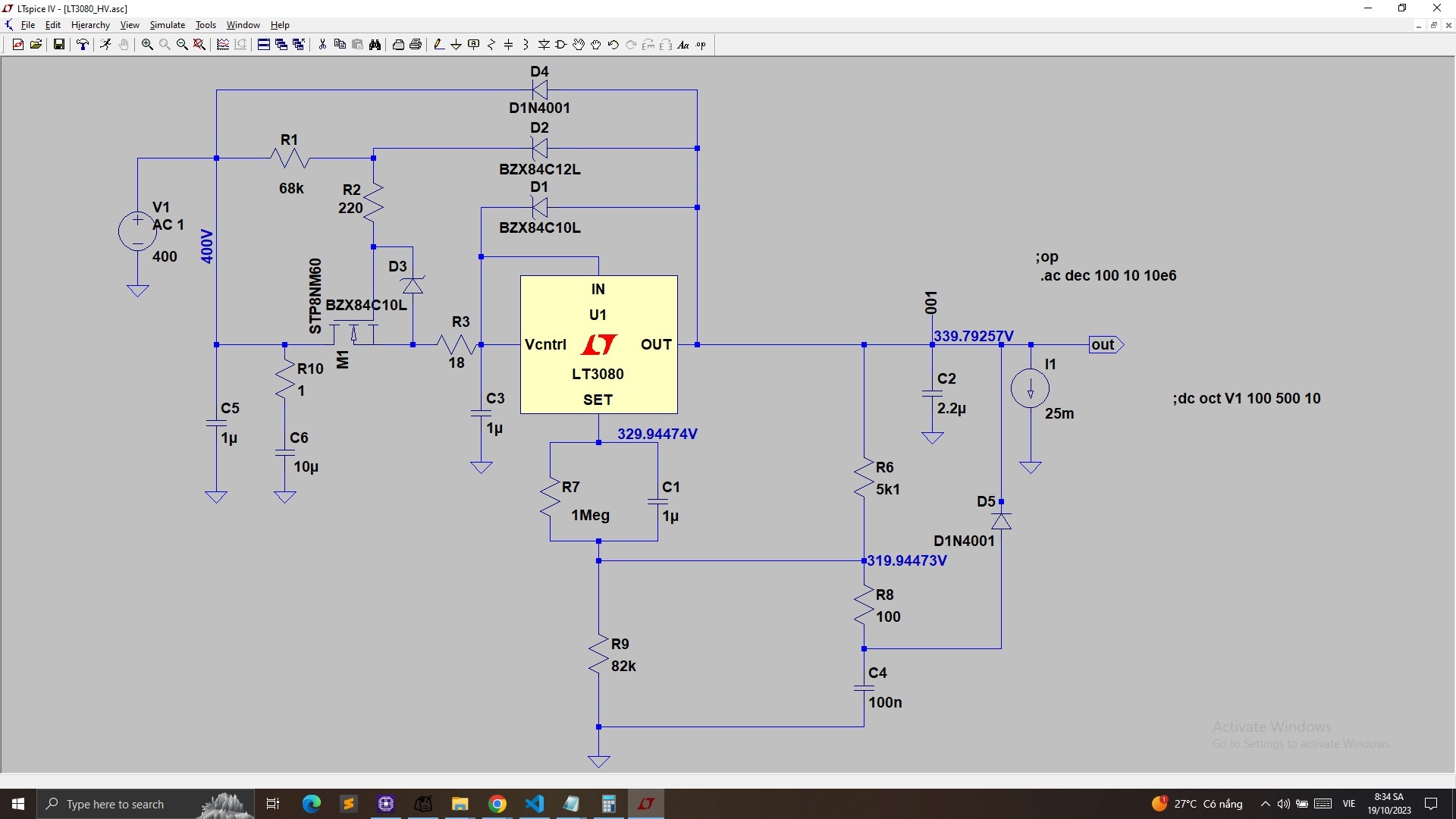

Are you sure of that reverse current? 180 mA sounds more like a forward current. D2 is just to discharge C1 when the regulator turns off. Without it you risk frying the regulator IC. It can be any diode. I use 1N4007.

Hi Tom,

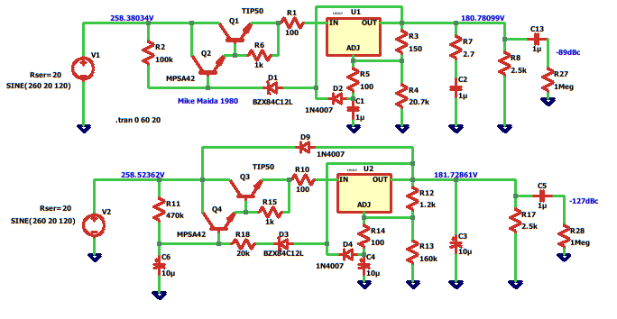

Here it is, this follow 21st century maida regulator schematic from this thread, When V1 set to 230V, Vout is 170 correctly but when i increase V1, Vout is no longer correct.
I know I'm late to the party, and you are probably done with this project by now, but I did run your .asc and found a problem with D4. Is this a 1N4001? Break downs at 50V.

Oh. That's possible. Usually breakdown isn't modelled.

The real circuit uses 1N4007. 1 kV breakdown. 🙂

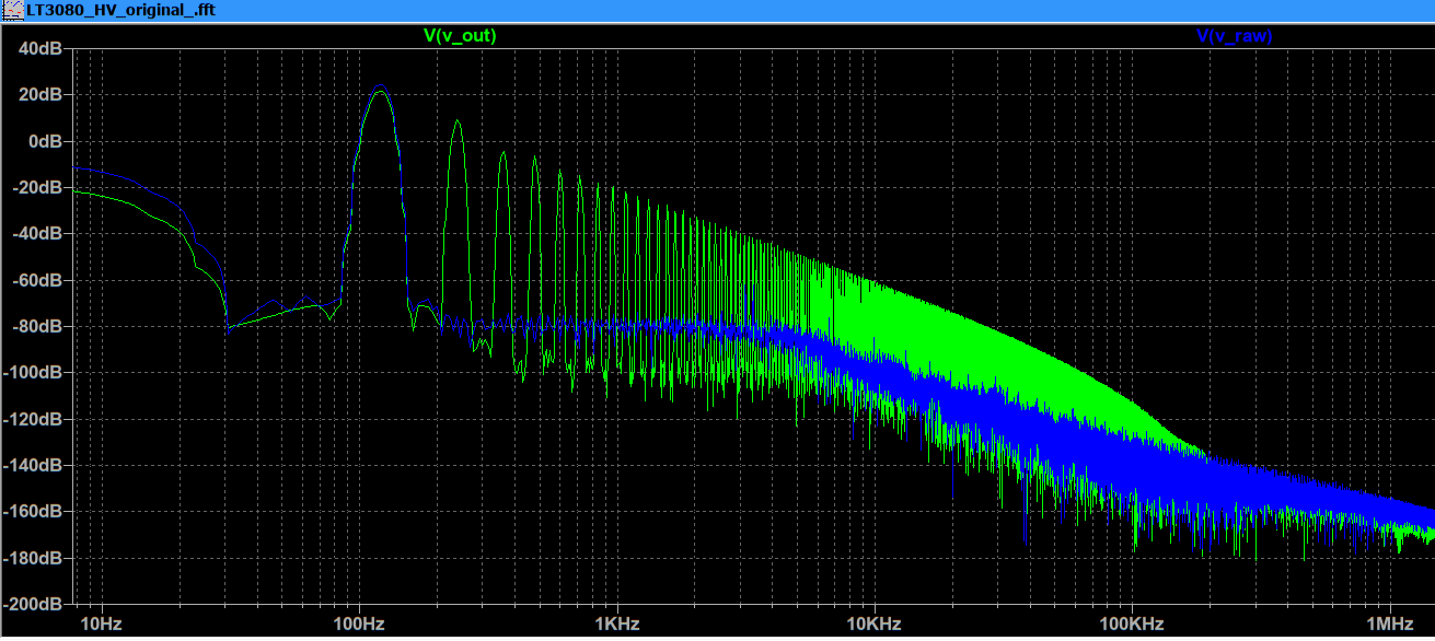

I can't find any LTspice sim files in this thread that provides any noticeable 120Hz rejection.
The original Mike Maida 1980 gives about 89dB of 120Hz rejection, adding small polarized 10uF cap and a 22k resistor, in the right places, improves it 38dB, and adds soft start. The TIP50 and MPSA42 limits the usable input to under 350V.
Using a HV MOSFET in lieu of the TIP50 the 120Hz rejection can be increased to 120dB, and ditching the the LM317 in favor of the old-ish LT1086 improves the rejection another 26dB.
The current limiting imposed by the FET-gate to output zener diode with the series resistor does not limit the the power dissipation on the FET, and adding a bipolar across the series resistor to limit the FET gate voltage just makes it into a constant current source, still with a major power dissipation on the FET.
I have a Mike Maida style reg in my power amps feeding the input and drivers and being a reference another regulator, for screen voltage. No plate regulation and no hum.
The LT3080 looks like a better part, my sims got it to very low nV output 120Hz, with an improved circuit, and over current protection that can turn off the FET entirely, or sent it into hiccup mode. Using a very high power FET to protect against mishaps also gives a harder to drive gate capacitance that negatively impact noise performance. A low gate charge seems to improve performance. The gate protection zener can be selected to include max current, no need for a 10A limit in a 100mA circuit.
You can find the line rejection graph in the Performance Graphs tab of the Maida Reg product page: https://neurochrome.com/products/21st-century-maida-regulator. It's about 130 dB at 120 Hz.
The original Maida Reg requires at least 10 mA in the feedback network to regulate. Mine requires much less. It runs at 2 mA. That means 1/5th the power dissipation in the feedback network.

I did find that, but not a sim file 🙁
Mike's original 44 year old LM317 design was very "low" voltage, he used a little under 10mA, newer regulators can handle well under 2mA.

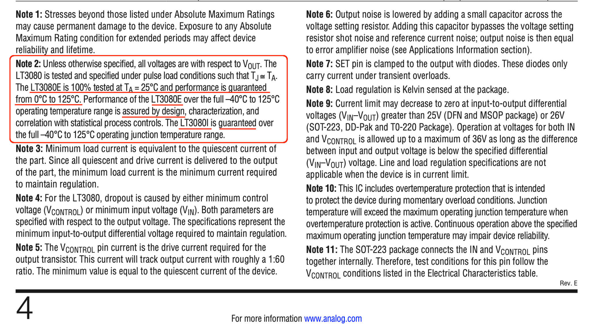

You gotta dig into the notes below the spec table on page 4:
So basically, the difference is in how the parts are tested. The 'E' grade is tested at room temperature and its performance is guaranteed within the range of 0 ºC to +125 ºC. Performance below freezing is assured (not guaranteed) by design, correlation, etc.
The performance of the 'I' grade is guaranteed across the full temperature range, which means the part has likely been tested at -40, +25, and +125 ºC.
Testing at temperatures below freezing is pretty expensive. In part, I think, because cold is more expensive to generate, but also because there tends to be more issues with cold testing, so it takes longer and, thus, is more expensive. The humidity in the air has this annoying tendency to freeze on the wafer and cold chuck and form ice. That mucks up the cold test.
Note that words like "guaranteed" and "assured" mean two very different things. "Guaranteed" is a legal term. If an 'I' grade part fails to meet the spec within -40ºC to +125 ºC it's a very big deal. The spec table is basically a legal agreement, and if they part doesn't meet spec, there could be legal trouble.
But if an 'E' grade part fails below freezing, it's "Oh, well. Sucks for you. Buy the more expensive 'I' grade next time".
The two grades are interchangeable in the Maida Regulator, assuming you're not operating it at -40 ºC. 🙂
