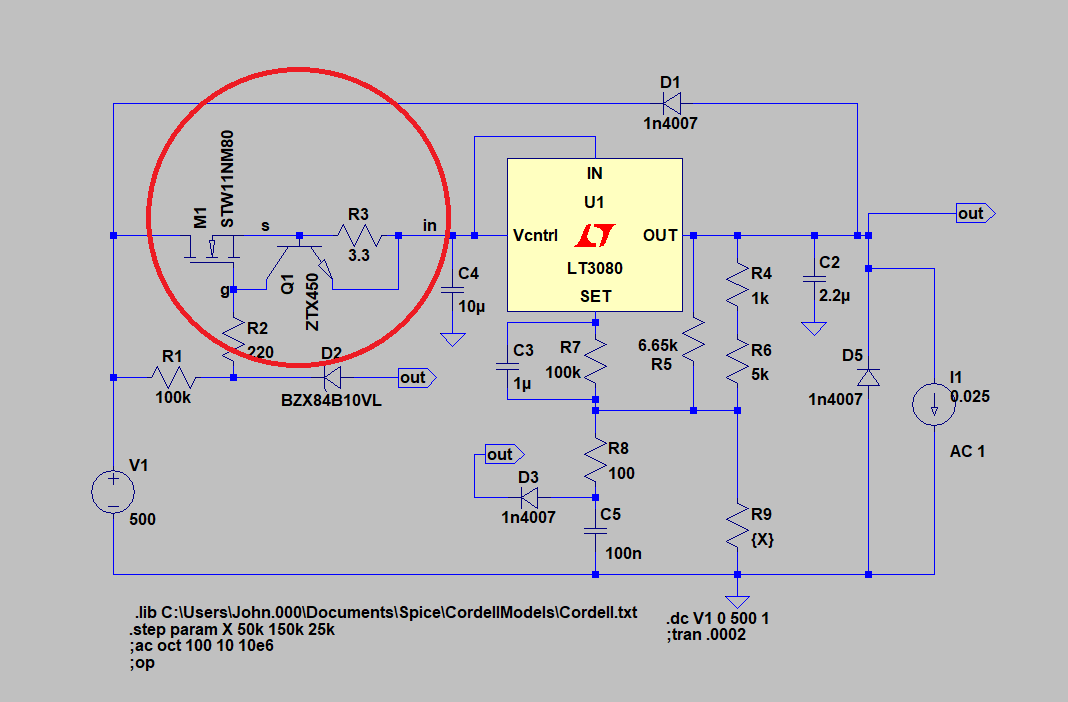

Have you considered the LT3081 - it has programmable current limit pin. Seems like a good option.
Implementing a current limit at the IC may not be the best option. It's a sure-fire way of frying the cascode device.

fwiw, i support Tom and have used his boards. you will probably have to roll your own PCB to incorporate this current limiting idea:
Yes, I ended up modelling a NPN/PNP configuration to cope with limiting but also offer a lower second current value in case of a dead short.
