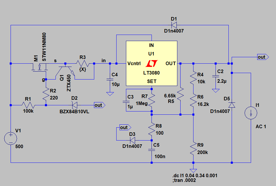

One thought would be to just short Vgs on Q1. You'd still have a trickle current though D2, though. You could short the output to ground, but you then definitely want to get the timing between the Vgs and the output short correct or your power-down signal becomes a self-destruct signal.

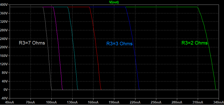

Careful with R3. If you go too low, the regulator will explode on startup if you have any capacitive load (which you do).

Hey Tom:
In reality, there is another resistor in series with R3 -- (I believe you used 22 Ohms). Rsense of 3.3 Ohms works for me.
This is on a Version 1.0 board. I have Version 2.1 from a few years back yet unpopulated. Will get this one working as well.

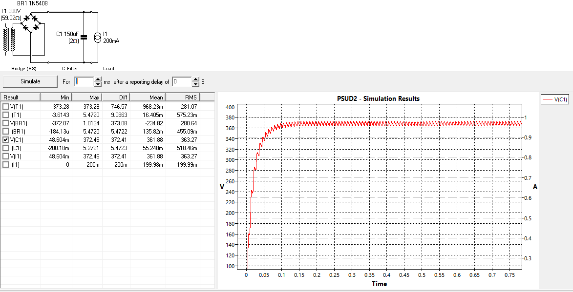

I tried that PSUD software and came up with this arrangement. The average current load of the DAC I'm making shouldn't be more than 100 mA. I was using the 400 mA peak before because it's the default suggestion in the spreadsheet.
Going to order a custom 300 V, ~70 VA toroidal transformer from Toroidy.

+1 for PSUD-II. Make sure to run at low mains, so set the simulation up so that you use 90% of the specified transformer voltage. That'll ensure that the circuit works if the mains are 10% low. Ensure that the valleys of the ripple voltage are at least 15 V above the desired output voltage under those conditions.
