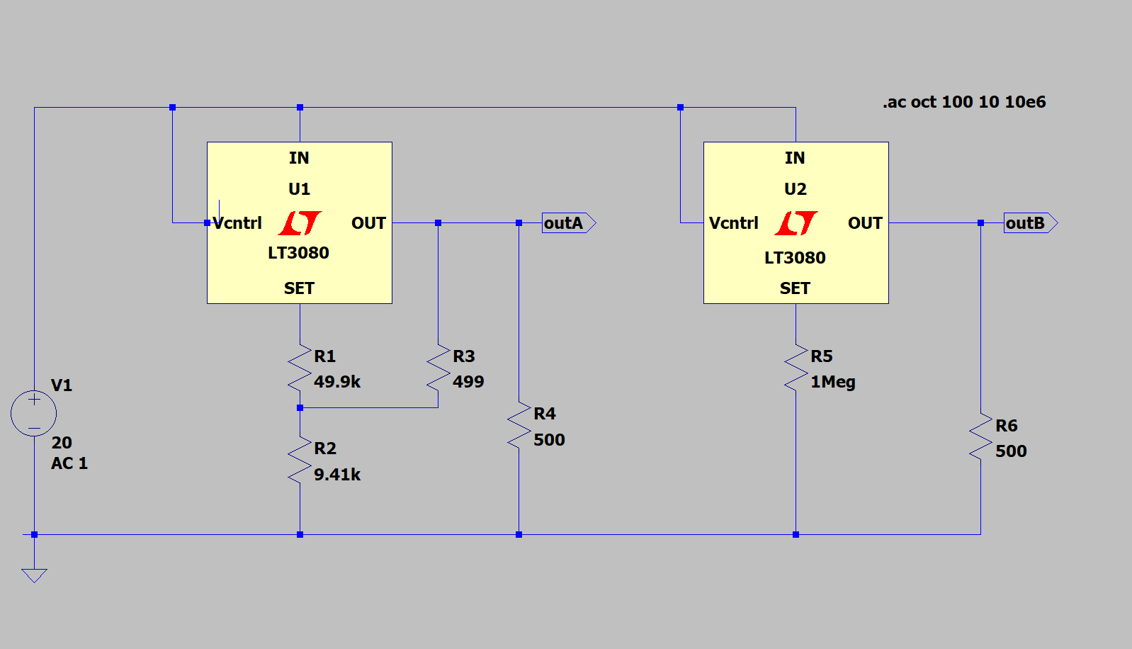

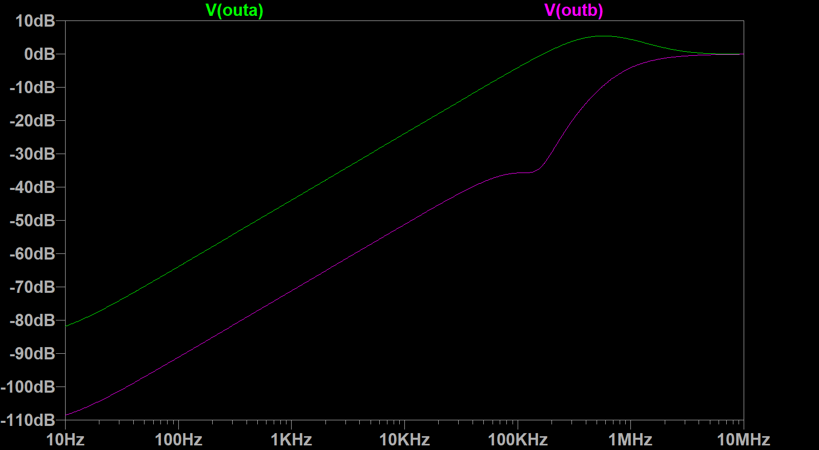

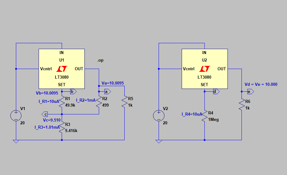

Agreed. But the output impedance and line rejection is much better in the case with the 1Meg resistor, because it employs no positive feedback to the SET pin. Simulations will bear this out.

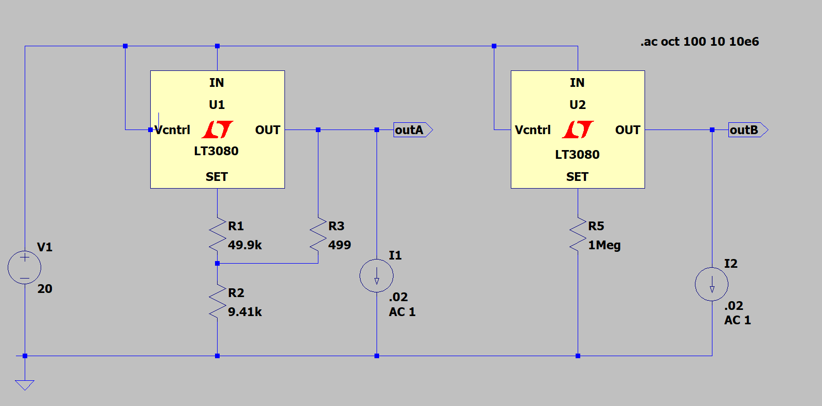

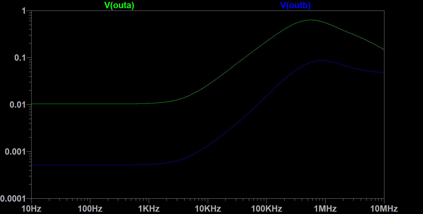

Yes.. le voila:
Thanks for the simulations, jackinnj.
Consider any three-terminal regulator that employs an R3 : R2 feedback network such as one of the cases jackinnj shows above. Let's approximate the very high impedance of the SET pin (or ADJ pin in the case of an LM317) as infinite. We can define a feedback factor F equal to the voltage divider transfer function R2 / (R2 + R3).
In the audio frequency range, the AC output voltage is almost equal to that at the SET/ADJ pin due to the internal loop gain of the regulator IC. In this range, output impedance and line rejection are degraded by a factor D = 1 / (1 - F) = 1 + R2/R3. The advantage is clear in the case where R3 is infinite and there is no feedback from regulator output to input. This is the best the regulator is capable of. If R3 must be used, it is best to keep R2/R3 as small as possible. If the feedback network contains capacitors, D will be the smallest if all component impedances in the Output to SET/ADJ path are kept as large as possible with respect to those in the ground to SET/ADJ path.
Starting somewhere above audio frequencies, the IC's internal loop gain falls enough that its AC output voltage is noticeably less than its input's. Here the degradation D is reduced by a small amount, but the advantage of zero or small amounts of feedback is still clear.

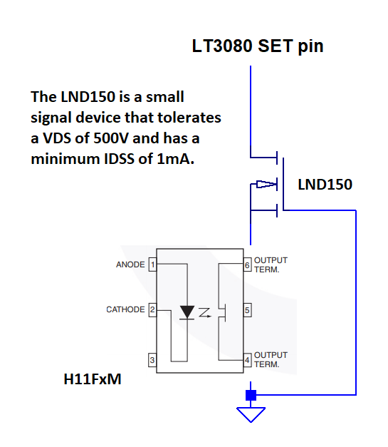

Going back to post 150 -- too bad the On-Semi (Fairchild) H11FM can only be used to 30V -- can go to 300M Ohms -- for R7
I can't find a link to the H11FM - can you provide one?
In post 150, R7 = 10M ohms (not 300) gets you 300V.

Missed a digit, sorry. H11F1M, H11F2M, H11F3M -- take a peek at the Mouser site and select OnSemi photo-fet optocouplers https://www.mouser.com/datasheet/2/308/H11F3M-1306481.pdf
I assume you're looking to make an adjustable output voltage regulator. The LND150 (see attached) will give you the high voltage compliance you need. If you need more than 500V, The IXYS IXT? 01N100D ( ? = P, U or Y and selects package type) will extend things to 1000V. No guarantees as to the ease of setting the desired output by applying a given LED current, or the stability of the setting with temperature (although there should be negligible self-heating.) If you don't need an isolated driver, replace the MOSFET in the opto with a trimmer resistor.

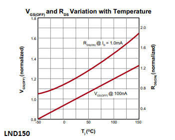

But even without self-heating, the problems with these solutions are the large temperature coefficients. Refer to the other LD150 attachment. The opto datasheet doesn't seem to have the requisite tempco data, but I expect it'll have the same problem.
You use two of the FET - couplers. I have done something similar with the Avago (was Hewlett Packard) HCNR-200. You can achieve excellent linearity.

Also, what is needed here is not a variable current, but a variable resistance to work with the fixed LM3080 SET current. Even if you can cause the two opto MOSFETs to track characteristics, the impedance looking in the LND150 drains is dependent on them, the LND150 transconductances, and the LND150 drain-source resistances. Now you have to match LND150's.
You could use BJTs like the 400V Zetex ZTX458's to take advantage of the more repeatable BJT transconductances. If needed, the 400V limitation could be extended with series resistors or zeners or cascoded BJT's, the "top" BJTs' bases being fed from a voltage divider driven by the regulator output. But you'd still have to match the resistances between the collectors and the emitters.
I don't see how to get the tracking idea to work here because of the need to introduce high voltage matched transistors, but I could be missing something.
Maybe a variable resistor in the Gate-Source path of an LND150 would provide a simple acceptable solution.
Thoughts?

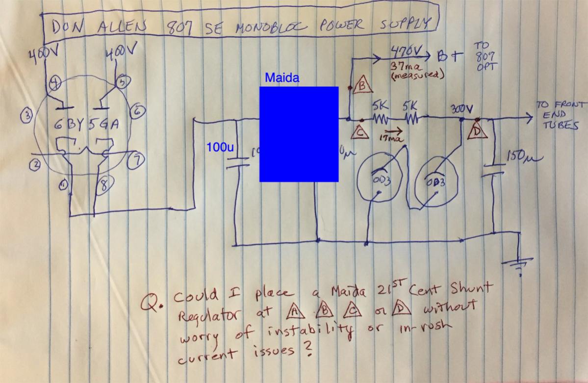

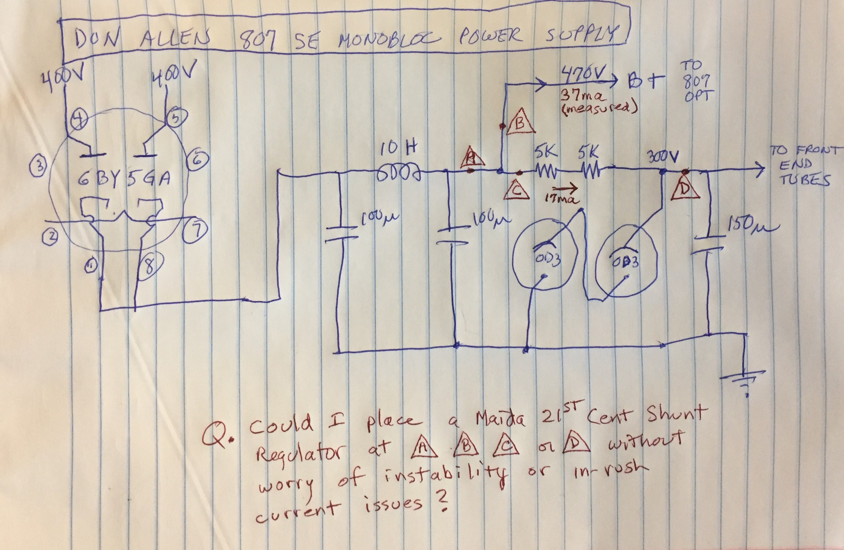

I have CLC PS in a low wattage 807 SE mono amp. I would like to "insert" a Maida requlator at location A.
Downstream of location A, and in parallel, are the OPT and a pair of OD3 gas tubes to feed front end tubes. Please take a look at the schematic, if you would.
Are there be any potential problems due to the downstream filter?

I would place the Maida Reg at point A in your schematic. You could even get rid of the 10H and second 100uF and just place the Maida Reg at the first 100 uF cap as I've shown in attached schematic.
I would design the Maida for 100 mA peak and 60 mA average (per channel) using the Excel sheet I provide with the board.
